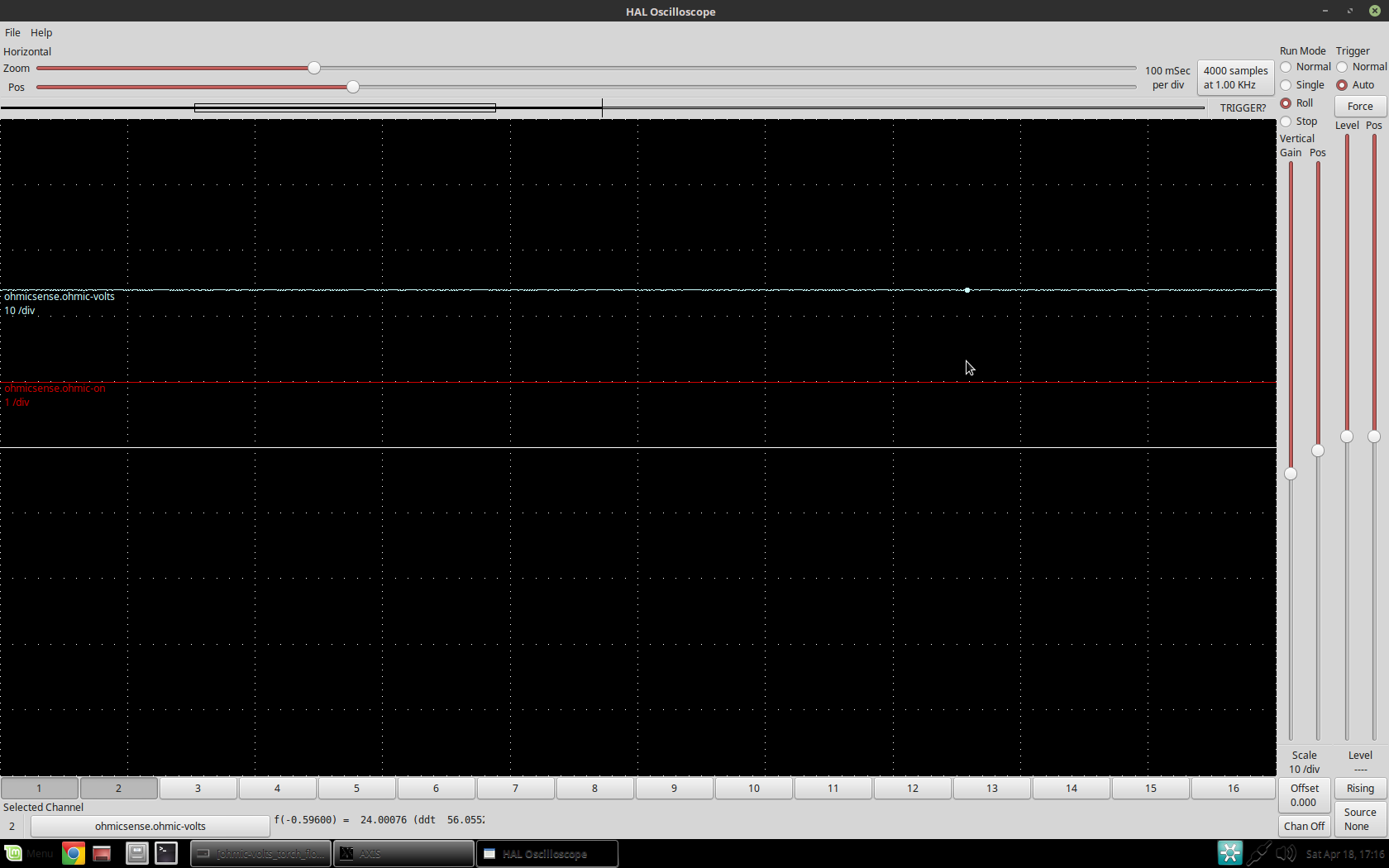

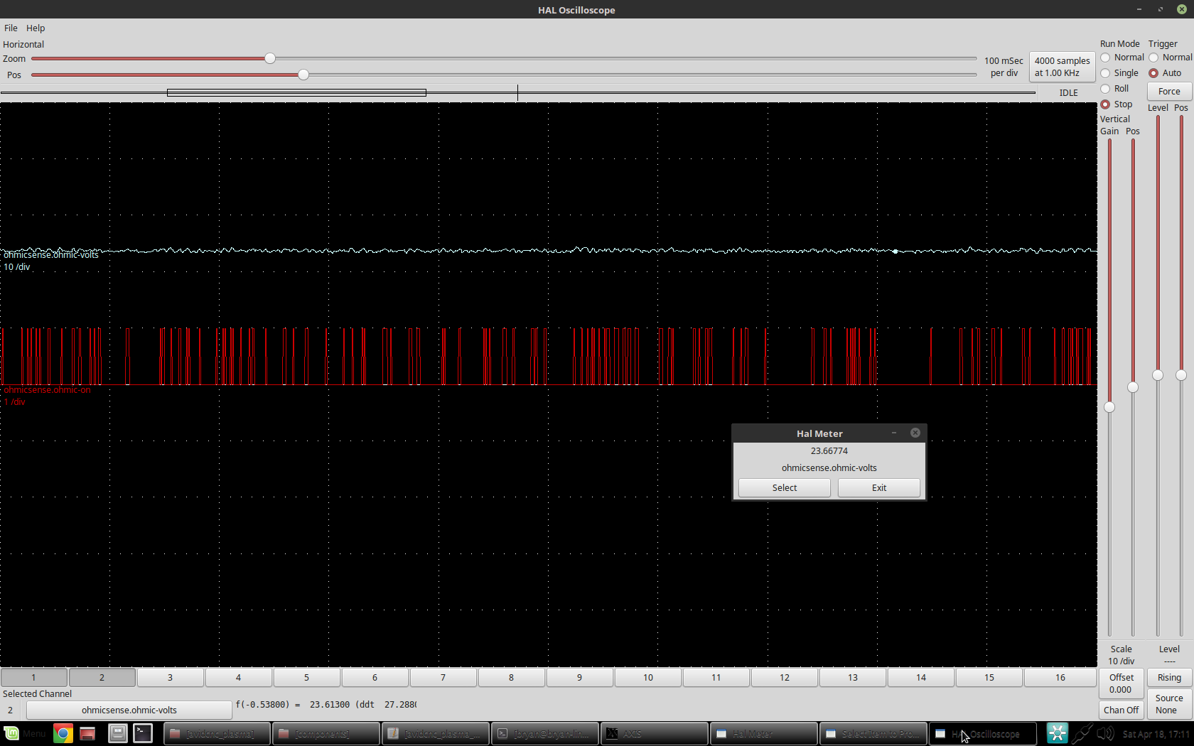

18 Apr 2020 21:32 - 18 Apr 2020 21:33 #164522
by Uthayne
Replied by Uthayne on topic Hypersensing questions
I tried disabling the encoder filter, did not see any change.
Here's some plots of a "wet torch" condition. Both touching the plate and not. The data was taken right after a pulse command, which had no real effect on lowering the voltage.
My low voltage is 23.8v and high is set at 23.9v
The noise seen on the floating picture is about 0.5v, maybe more, just eyeballing. Sometimes it gets as high as 24.5V, which is above what the PSU is set at (exactly 24.00V)
SHIELD on THCAD-5 is connected to frame ground.
