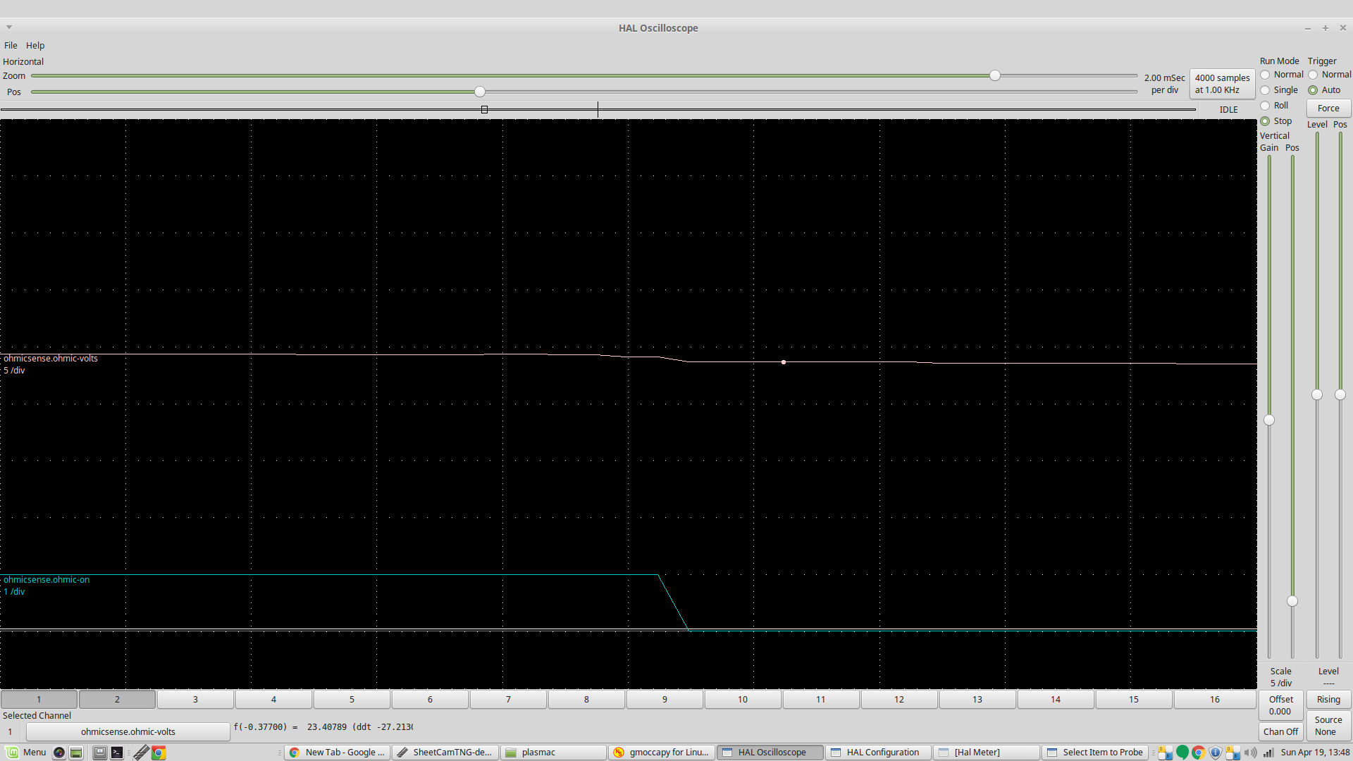

Replied by rodw on topic Hypersensing questions
Well, I went to work on a Sunday to have a play for you guys. I have a Thermal Dynamics A120 120 amp machine.
So at the start, everything was nice and normal as everything was dry. Then I used my finger to splash some water into the nozzle and sure enough the volts went up to about 21.6 volts. This is the result of a probe event. I am really interested to see the behaviour when the contact is broken.
So what I'm seeing is a definite downward slope as the connection breaks. This is what I was expecting to see.
And when we zoom in
So it would be good if you guys could post similar screen dumps.
I'm still thinking about how best to proceed from here but clearly we can measure the ramp down as I expected.
I am wondering if the resting voltage could be sampled when is-probing goes true but I don't quite know what the next step would be.
I am assuming you guys are just seeing the 23.5 volts after the torch is wet and not on a dry machine. That is what I thought Uthayne said earlier. Can you confirm? All I hav eto do is blow some air through the torchand its clean again. But I have had to open the torch to dry it before.
And when we zoom in
