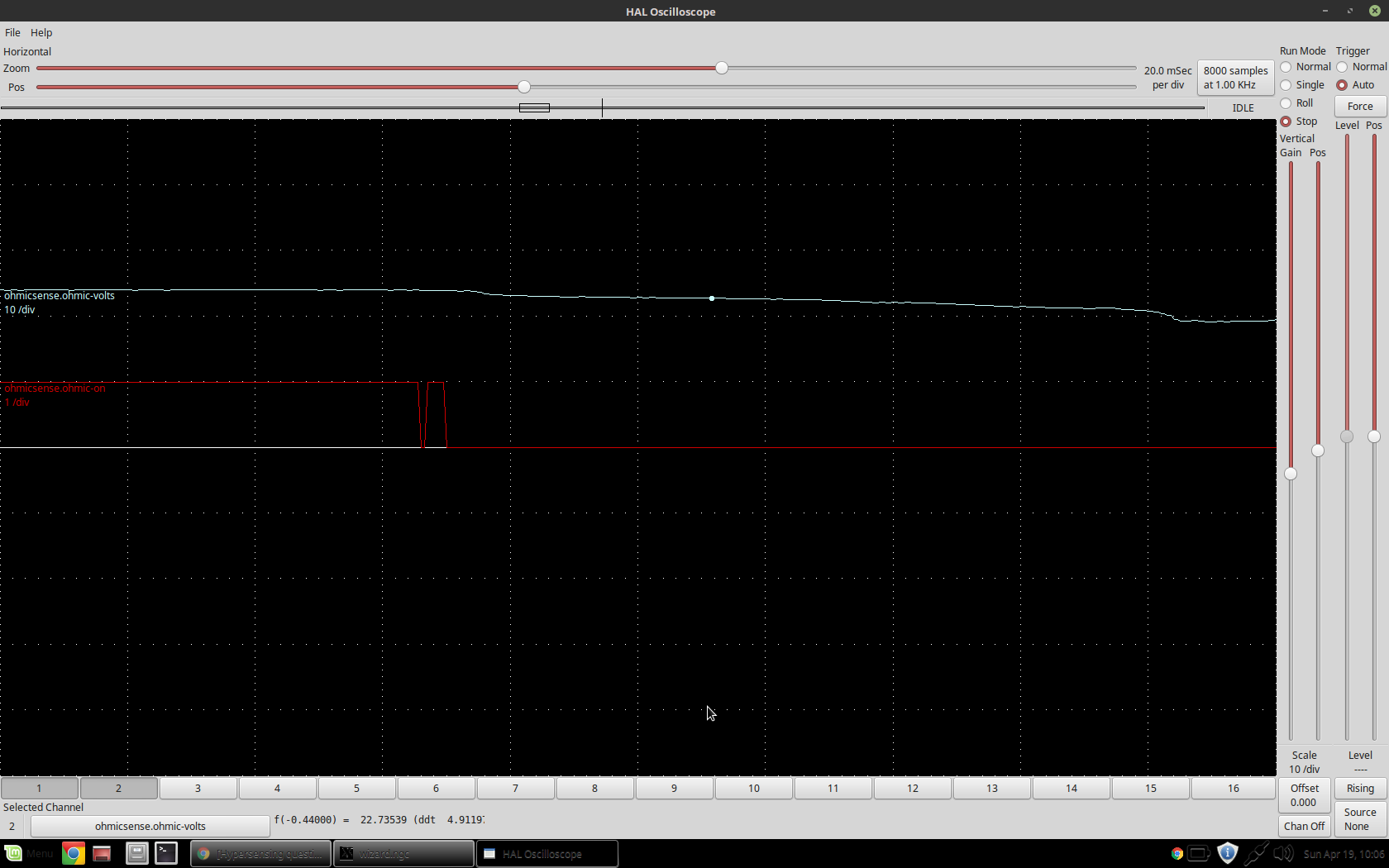

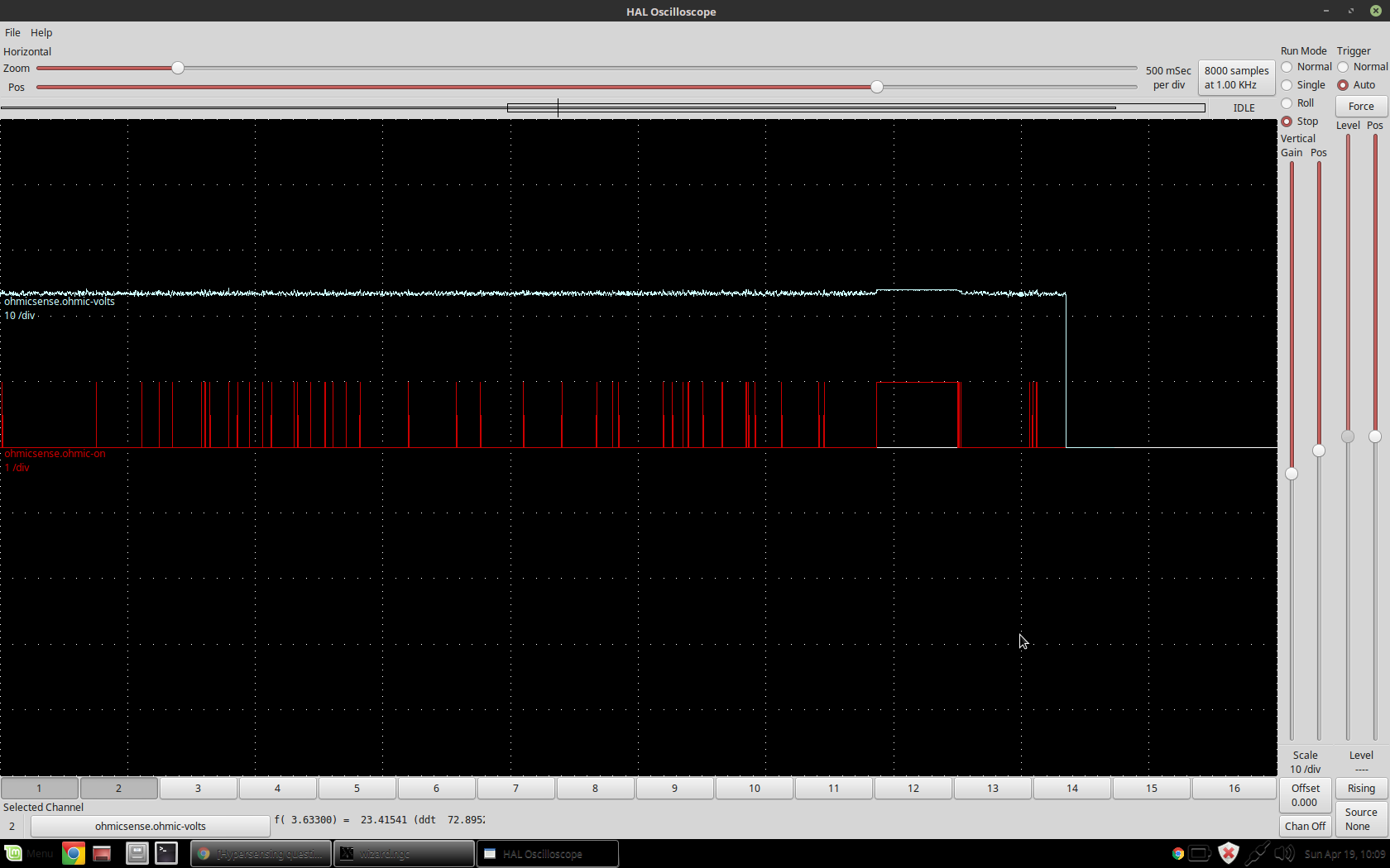

Well, I went to work on a Sunday to have a play for you guys. I have a Thermal Dynamics A120 120 amp machine.
So at the start, everything was nice and normal as everything was dry. Then I used my finger to splash some water into the nozzle and sure enough the volts went up to about 21.6 volts. This is the result of a probe event. I am really interested to see the behaviour when the contact is broken.
So what I'm seeing is a definite downward slope as the connection breaks. This is what I was expecting to see.
And when we zoom in
So it would be good if you guys could post similar screen dumps.
I'm still thinking about how best to proceed from here but clearly we can measure the ramp down as I expected.
I am wondering if the resting voltage could be sampled when is-probing goes true but I don't quite know what the next step would be.
I am assuming you guys are just seeing the 23.5 volts after the torch is wet and not on a dry machine. That is what I thought Uthayne said earlier. Can you confirm? All I hav eto do is blow some air through the torchand its clean again. But I have had to open the torch to dry it before.

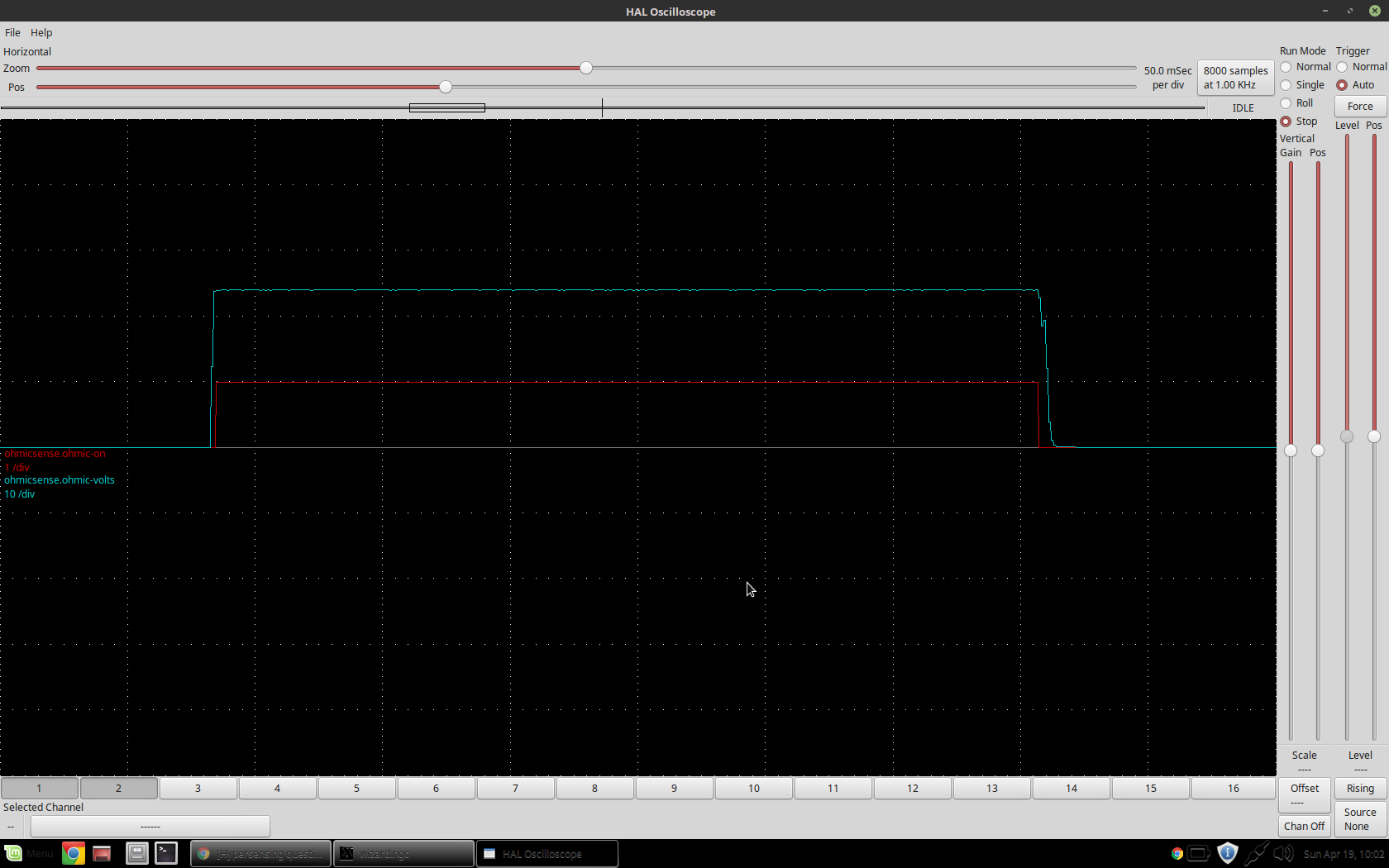

Took same data, here it is.
First off, a dry run. Water has not touched the torch, just going down and probing. Nice and clean.
Then I pulsed the torch over water (not close) to get some voltage. Torch was reading 19v, but still probed happily.
Close up view of the previous.

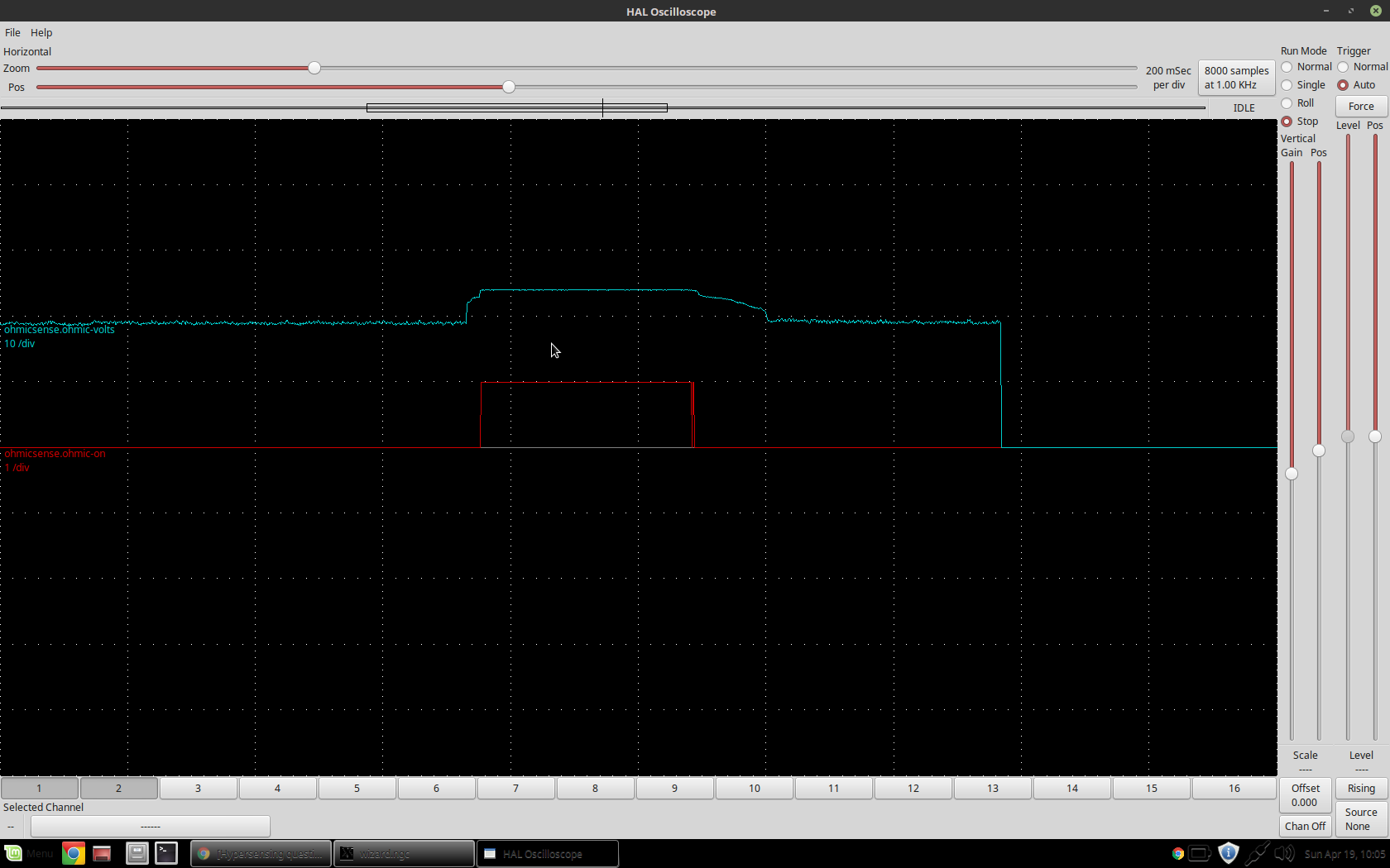

Then I simulated the end of a cutout where the torch is close to the water and gets drenched. 23v+ is what the torch is sitting at now, rapidly triggering ohmic.

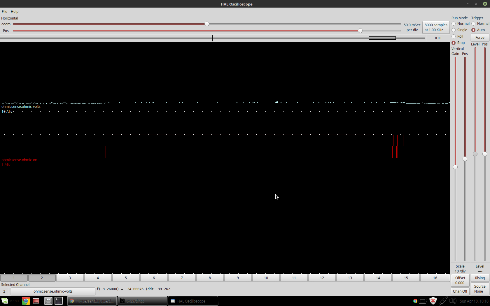

I did a probe event and you can see where it made contact because the ohmic-on signal is true for a bit longer
Close up of previous

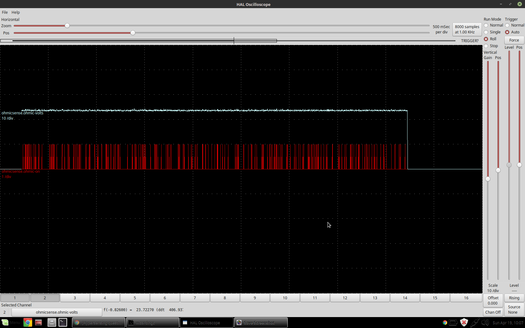

I then tried installing ohmic2 but it would not let me probe successfully as it was being triggered before moving to probe height. The reason I was able to in the previous picture is because I modified my own ohmic component to let it, but it was only for troubleshooting.
My "ON" signal for ohmic-volts is nice and clean. When it is floating and water logged, it is quite messy. Perhaps I should investigate wiring or employ some low pass filters?

Great feedback thanks. From what I can see, its still possible to identify a probe event among the noise which is something nobody previously has thought possible when water enters the torch.
I think it would be good to see if you could use ohmic2 with a high threshold of say 23.95 to 23.99 volts to see if we can capture a probe event and also plot the ohmicsense.dbg_avgv pin which is smoothed by averaging. If we could do that, it might give us a baseline for the next step which is:
to change the component under case 1: fromto
We would then be using a smoothed moving average (N=5) which should flatten out the noisy peaks.
Eg. every reading is the average of the previous N readings. You may need to play around with N so:
If we then change the value of ohmicsense.num-readings (our N) to say 10, it will increase the number of readings averaged. I think that would mean that you would need to be reading 24.0 volts for 10 servo cycles before you saw a reading of 24.0 volts.
This all assumes my moving average code works! I think it does but its hard to test in an interrupt service routine on the servo thread. It will support averaging up to 1000 readings (1 second but we want to keep it as low as possible, certainly no more then N=100 which is 0.1 second.
Hopefully, that will give you some homework and an eventual solution .

The best solution would be to to lower the sensitivity of the ohmic sense by adding a resistor between the probe and the table, raising the current threshold...

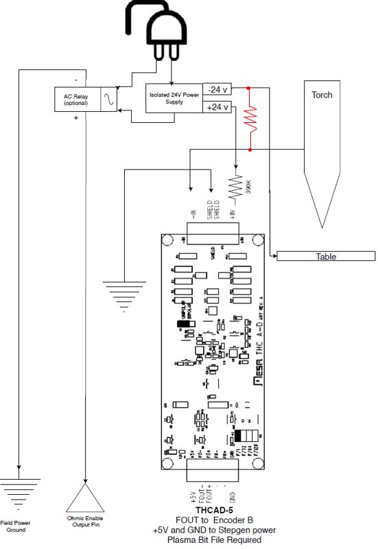

With no load (other than the THCAD-5) the sense current is 50 uA full scale
If you wanted 20X that (1 mA) , 24K would work.
Assuming that it needs to withstand 300V faults, (where it would dissipate 3.75W)
a 24K 5W resistor would be a good choice

This is what I would have expected. I dont see how the code is solving the problem that the hypersensing is too sensitive. It has a path to ground of 16.5k ohms, so of course it can easily overcome that.
Again, Maybe we are trying to solve two separate issues simultaneously. But until we reduce the false trips due to water intrusion, I'm not sure what the code is going to solve. This part of the ohmic problem seems to be circuitry based. I am with Peter, it needs to be less sensitive. The voltage for water in the torch needs to be lower than the voltage for shield contacting workpiece sitting on table.
I'm willing to try the resistor thing to see what happens, I just dont have any 5 watt or 10 watt resistors laying around, I'll have to order some.

@PCW
Is the placement of the RED resistor in the attached diagram screen shot what you mean?
Also, What would be the difference between a 10K 10W resistor mentioned previously and the 24K 5W resistor mentioned here?

Replied by tommylight on topic Hypersensing questions
That should do just fine.
Then again, i would try it with a smaller one, see if it burns to a crisp!
Normally it should not burn as it is isolated from the nozzle and the electrode, but PCW is right, during firing more voltage would be induced/conducted through water, and that is a risk not to be taken lightly.
