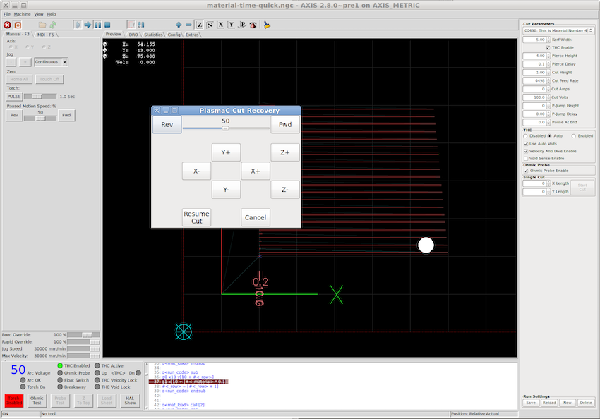

I saw this video from Clive and thought that the must be a better option for error recovery to minimize divots on a cut recovery.
I am toying with this idea, basically the Paused Motion section in the GUI would be replaced with a single button labelled Cut Recovery that only shows when paused.
This button when pressed will bring up a recovery dialog as shown.
Then the operater can move in reverse or forward to an appropriate position on the cut, then use the X/Y buttons to move the torch to the waste side of the cut.
The Z button is just a convenience to allow the torch to be close to the material to make sighting a bit easier.
Each button press would offset by one kerf width as displayed in the cut parameters.
When a satisfactory starting point is reached then there are two options:
  • Cancel in which case the the offsets are cleared and the dialog box closes.
  • Resume Cut which will move X to the original height if required then start a cut at the current position then the torch will move to the the cut line at the position where the offsets were applied then continue on with the cut.
I am not 100% sure if this is feasible or even if it is a good idea so I thought I would put it out there for any comments.

So I like the premise of the idea, but I'm a bit fuzzy on the execution. A few questions:
1. Will the jog keys on the keyboard work, or will the user HAVE to use the buttons in the dialog box?
2. I'm confused as to why it's offset by one kerf width? If you move into the waste area, does it matter that it's offset? I'm not following here.
3. So, the idea is that I move the torch to an area where there's waste material, and when I press go, it's going to take the shortest path back to where it stopped when it paused? I'm wondering if that will still leave a divot? Any chance of a flame out if it crosses the kerf? I think leaving a little bump of material may be better than a divot, at least it's usually easier to grind those off.

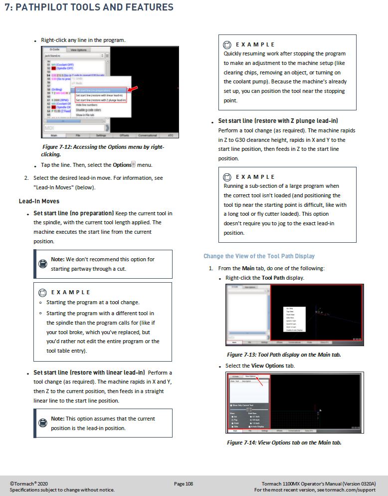

4. This sounds a bit like something Tormach does for when the operator stops the program. It highlights last executed line. Then you can right click on that line and choose from a slew of options. See the attached pic from their 1100MX manual below. Just reminded me of that feature, and thought I'd share.
You would have to use the dialog box buttons. It may be possible to modify the existing buttons in Axis but I don't think it would be possible in Gmoccapy. I like to keep both the same if possible as it is a PITA supporting two GUIs.
Well you need to set the amount you offset so I figured that would be a good starting point plus there is no units specific code. If you want to move X three kerf widths positive you press X+ three times.
Yes, it probes, starts the cut and moves in a straight line to were the offset started from then continues the original cut.
The idea is that with some practice you could find the place where you don't, you can use the Fwd/Rev of Paused motion to set the start point of the cut then set the offset you want.
I don't know, my machine is in permanent CPA mode so I don't see that.
I agree.
