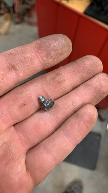

I’ll definitely give it a go when I am back up and running! I’ll be looking forward to errors while cutting
I have to mill and pin my rack and pinion tensioning solution... I think it sees more force than I anticipated, or hydrogen embrittlement got the best of my bolt. Either way I welded out the M4 broken off portion (attached if anyone’s curious (I impressed myself on this one)) so at least I don’t have to remake it.

Yup, that is impressive.
But an M4 bolt is to small for anything on a rack and pinion system, except the motor mount.

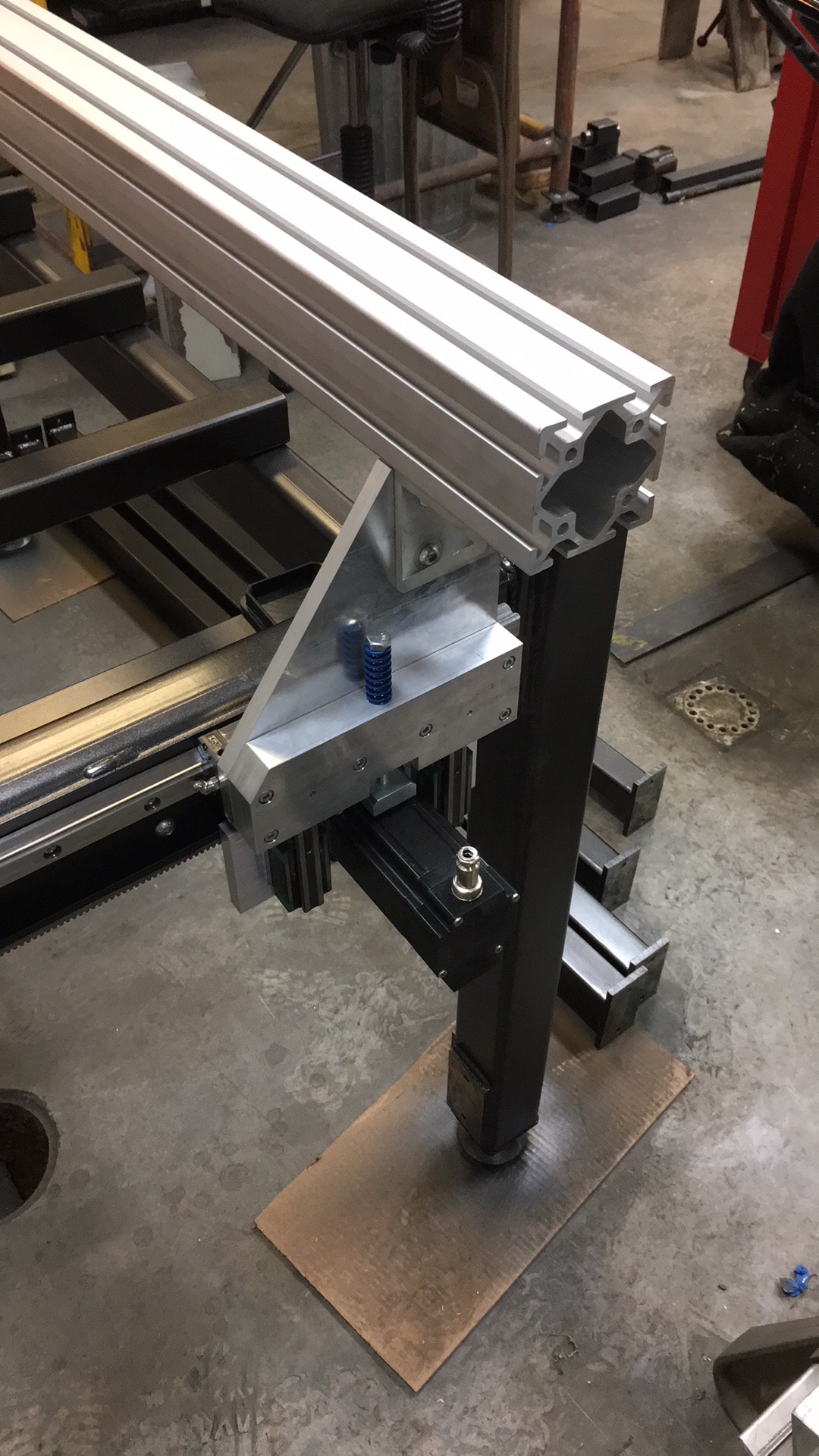

True, but it's the size the linear rail comes pre-drilled to. Also the pocket for the rail is milled so that the rail is tight left to right and to the top of the pocket. I guess that's what leads me to believe I either over torqued it or had a bad bolt. The other 5 are fine... But they're all getting pinned anyhow.
Attached is a pic of the tensioning system I came up with which until the bolt incident, was working awesome.

Nice, that is the best way of tensioning a rack and pinion system, the side spring ones cause wear on one side more than on the other and they tend to slip on one direction consistently. This way none of those issues exist.Attached is a pic of the tensioning system I came up with which until the bolt incident, was working awesome.

Yea, I wasn't sold on the standard 3:1 reduction system other people sell, and it seemed like they take a ton of tension to "stick". I dont have a heck of a lot of tension on this and it's never slipped once, and I drive the thing at 1200in/min in Y and 1500in/min in X... So, I'll pin the guides to make sure I dont have issue again, and send it. I could also mill down the stock a bit so that the rail is slightly protruding to give a little bit of clamp force so it's not relying on that one tiny M4 bolt. Now that I type that, I think I am going to do that. Honestly that would probably even negate the need to pin them. I'm a bit nervous to mill the hardened rails.
