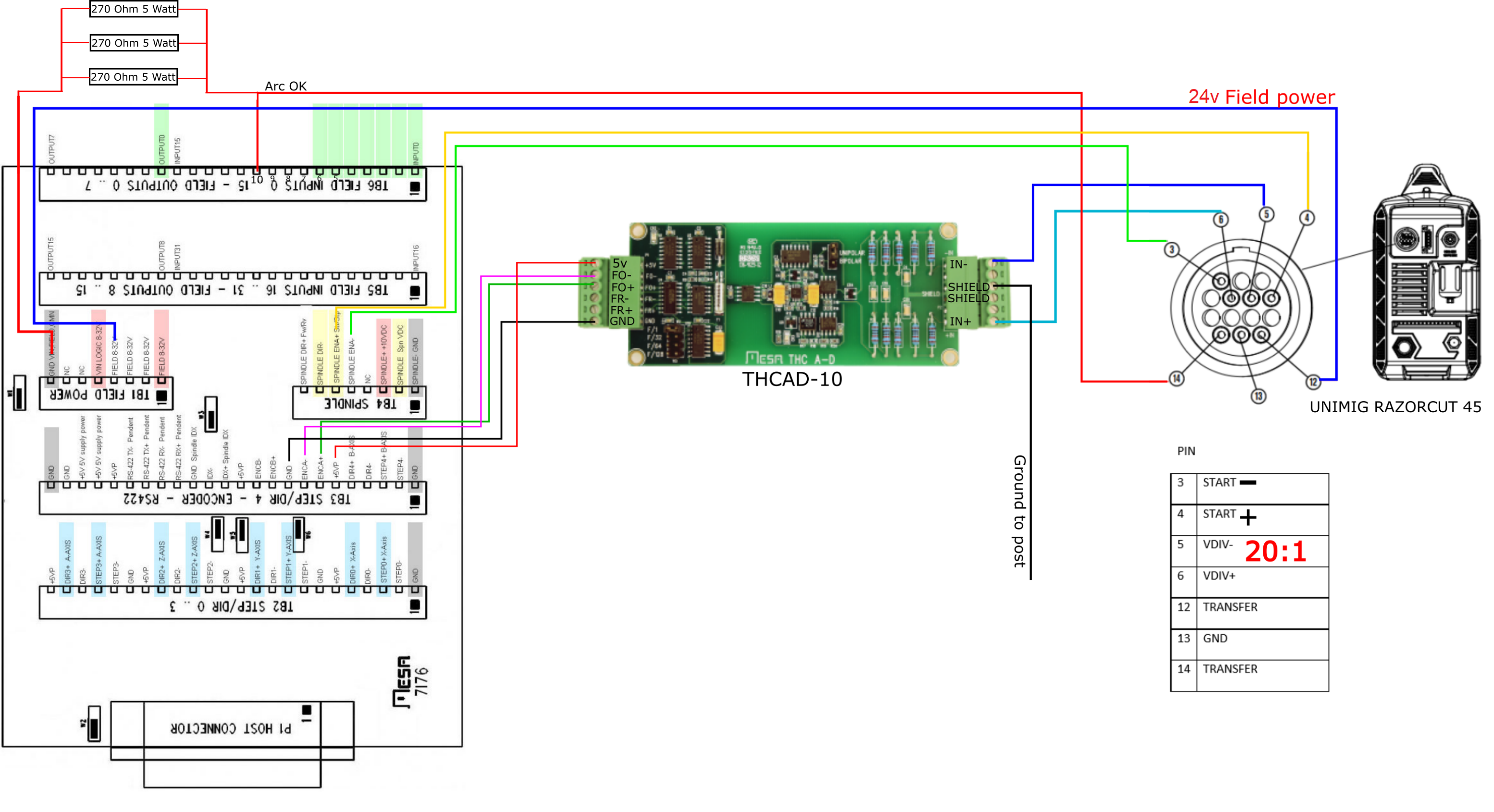

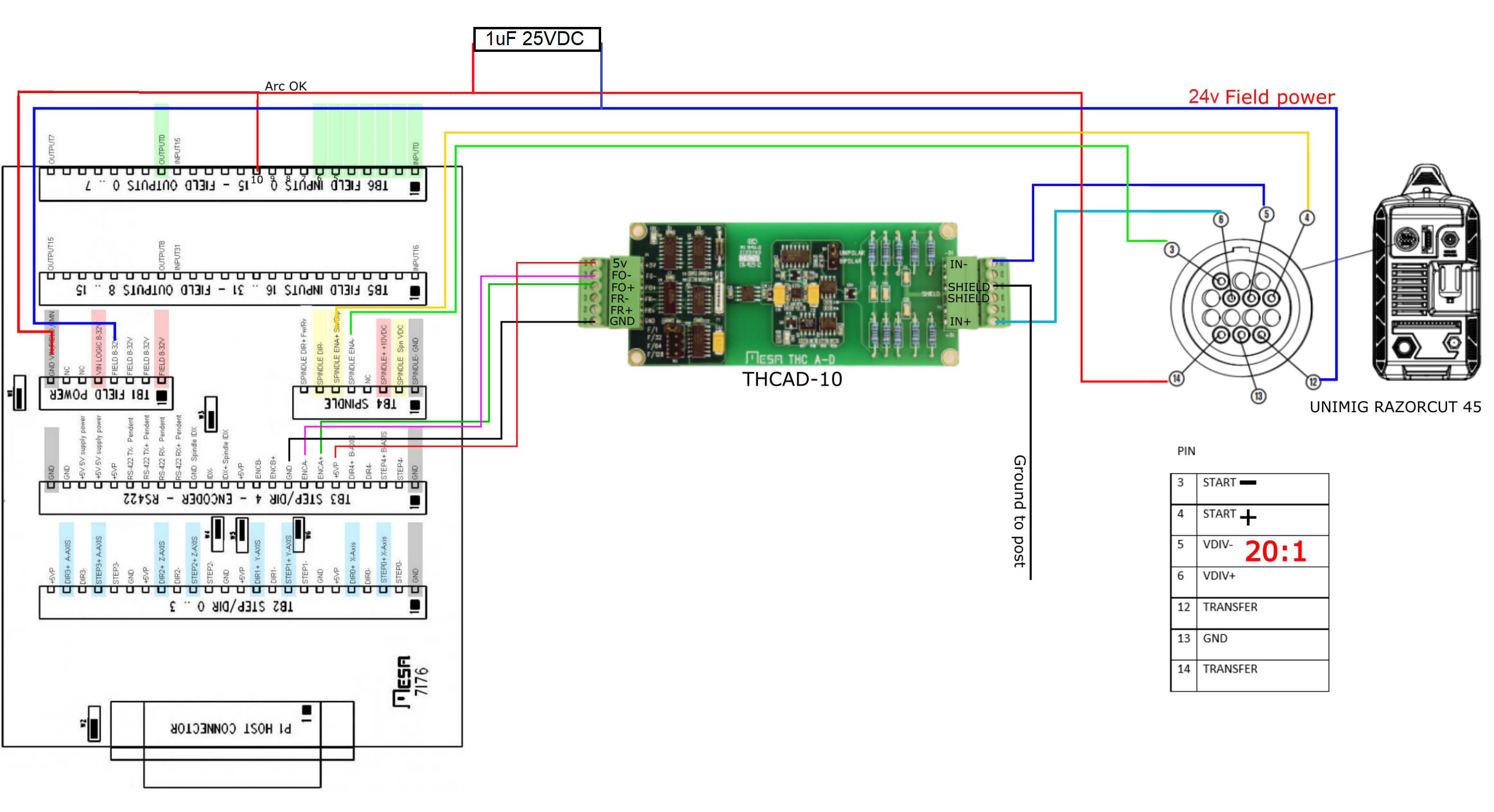

Replied by txtrone on topic Arc OK intermitent issues on torch fire
Last post first schematics shows a wiring error that will cause the ARCOK (transfer) to short the VFIELD power.
I really hope it is not wired like that.
Are you referring to the cap going across the pos and neg, rather than being inline on the pos?
Do you have an opinion on using a resistor vs cap in this setup?
I am currently wiring my hypertherm pm85 and my head is about to explode from all of the (well intentioned) conflicting information I am getting. It reminds me of conversations/debates/arguments I have witnessed over the years between master electricians and electrical engineers. "You can't do that! It will NOT work!!!" ... "That's interesting, I've been doing it like that for 30 years!!!" etc etc

31 Mar 2021 19:09 #204267
by snowgoer540
In the diagram that post is referring to, the field power + side is wired directly to the input for arc ok. It was a mistake in the diagram.
As for resistor vs cap, it’s two different ways to skin the same cat.
From my rudimentary understanding, resistor forces extra current all the time, and does not account for mfg’s different ratings of minimum switching loads at different voltages. Capacitor provides a burst of electricity for cleaning the contacts at close but doesn’t pull extra amperage all the time.
Here’s a link that may help: en.m.wikipedia.org/wiki/Wetting_current
There are plenty of resources out there to research and draw your own informed decision.
I’m not an electrical engineer. But if I were going to run one (have not yet found this to be necessary with my hypertherm 65 (but the fact that contact oxidation and minimum switching currents are a real thing is filed away for later)) I would likely pick the capacitor. It was far more important in my setup to add a debounce to the arc ok input. Which is now standard at 5mS. I’ve seen others need as much as 10mS. At any rate, your local humidity/temperature/etc may be different.

31 Mar 2021 20:40 - 31 Mar 2021 20:42 #204288
Replied by tommylight on topic Arc OK intermitent issues on torch fire
The above has the red wire directly connected to Vfield, that is wrong as the arc transfer relay will connect that to ground causing a short to the power supply.
This is correct, notice the resistors between the input and the Vfield on the red wire.
