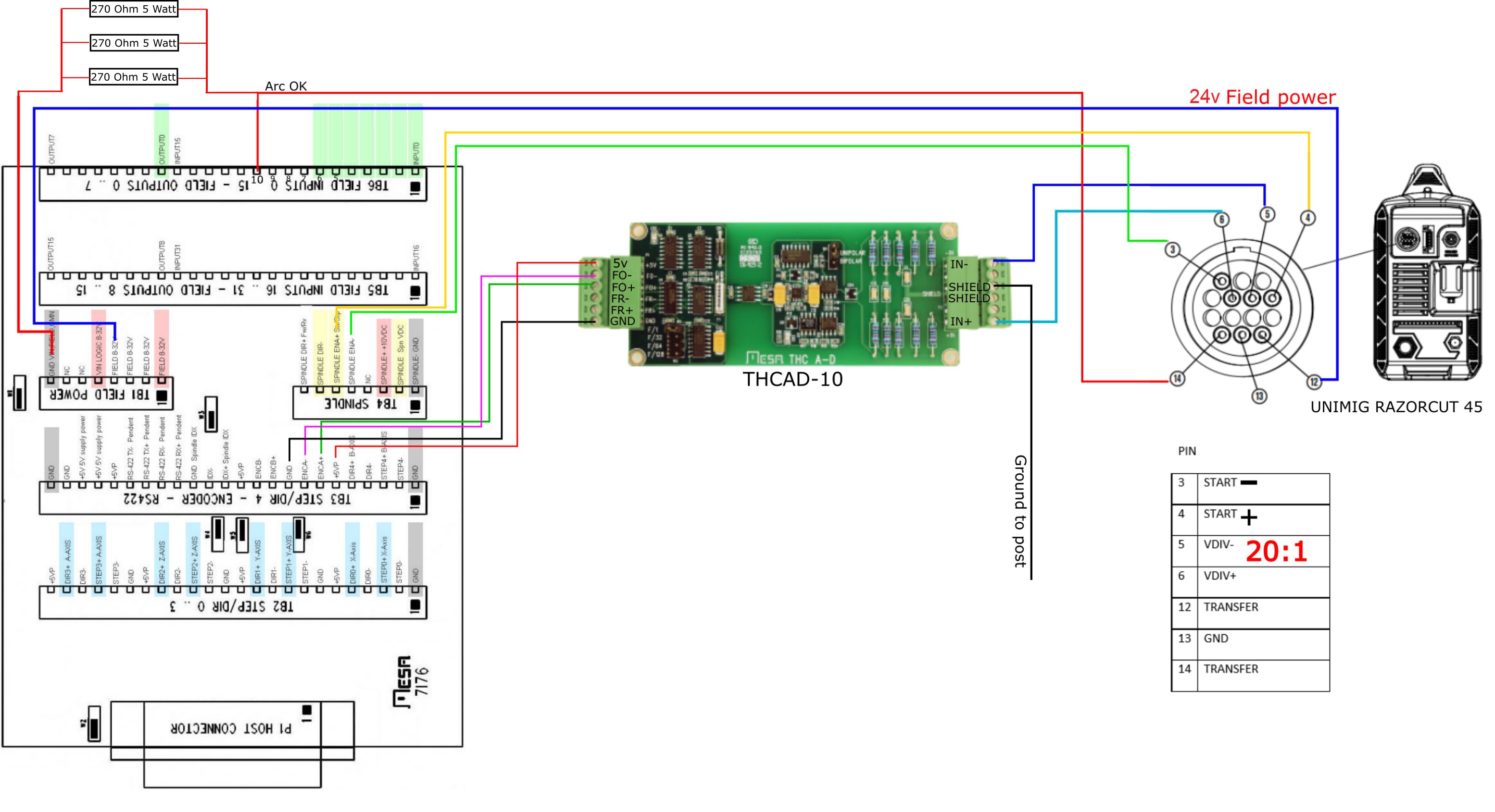

11 Dec 2020 09:05 - 11 Dec 2020 09:09 #191657 by luftlupus
Replied by luftlupus on topic Arc OK intermitent issues on torch fire
That will give you around 24mA which would "probably" be adequate.
24 mA is well below the min current rating of most internal Arcok relays of 100 mA (certainly hypertherm, Everlast and Thermal Dynamics).
You need to add a pulldown resistor of around 90Ω 10W assuming a 24 volt ArcOK circuit and a Mesa card. Connect it from the Mesa input to -24 volt.
To achieve this from readily available parts we recommend to:
Get 3 x 270Ω 5W Resistors (Jaycar PN RR3284) and wire them in parallel. This will give 90Ω with 267mA and 6.4W of dissipation. 3 x 5W resistors in parallel will give you 15W power dissipation capability, so plenty of margin. Leave an air gap between the resistors though.
Expect to have to cycle the ArcOK a few times to burn off oxidisation. The last time this came up the user said
"After all this, and Rod's new arc ok resistor resistor blowing away the built up oxide, I am getting reliable cuts with about 30 minutes of cut time not throwing up a single error yet."
I'll leave it to you to find the thread.
Thanks for the advice its very much appreciated, so pretty much like this? (i just ordered the resistors)
Last edit: 11 Dec 2020 09:09 by luftlupus.

12 Dec 2020 08:17 - 14 Apr 2021 12:56 #191714 by luftlupus
The required contact wetting current is dependent on switched voltage.
For example for one manufacturers silver contact relay the minimum wetting
current was 160 mA at 5V but just 26 mA at 30 VDC. The significant parameter
is the energy available to clean the contacts.
Another way of providing wetting current without any added power dissipation
is to parallel the contacts with a small film capacitor circuit (say 1 uF
capacitor for a 24V circuit) This provides a high surge current on contact
closure but the total energy is limited (~.03 mJ)
Sorry guys i am slowing learning but im a bit slow. i did however confirm that the machine relay is the issue i am having as i put another machine on and had zero issues while cutting.
I also contacted the manufacturer but wont hear back for a few days and asked what the minimum wetting current is of the relay they are using internally but if it ends up being pretty much like the hyper therms/everlasts i can go the way of adding the 3 resistors in parallel that was mentioned earlier like this.
Cheers everyone.

12 Dec 2020 17:54 #191753 by tommylight
Replied by tommylight on topic Arc OK intermitent issues on torch fire
Last post first schematics shows a wiring error that will cause the ARCOK (transfer) to short the VFIELD power.
I really hope it is not wired like that.
