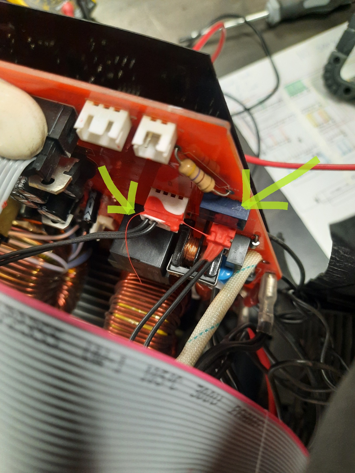

Replied by rodw on topic Arc OK intermitent issues on torch fire
Can you check for continuity from the relay pins to the connector? Maybe it has a trace on the board going to the bigger one.

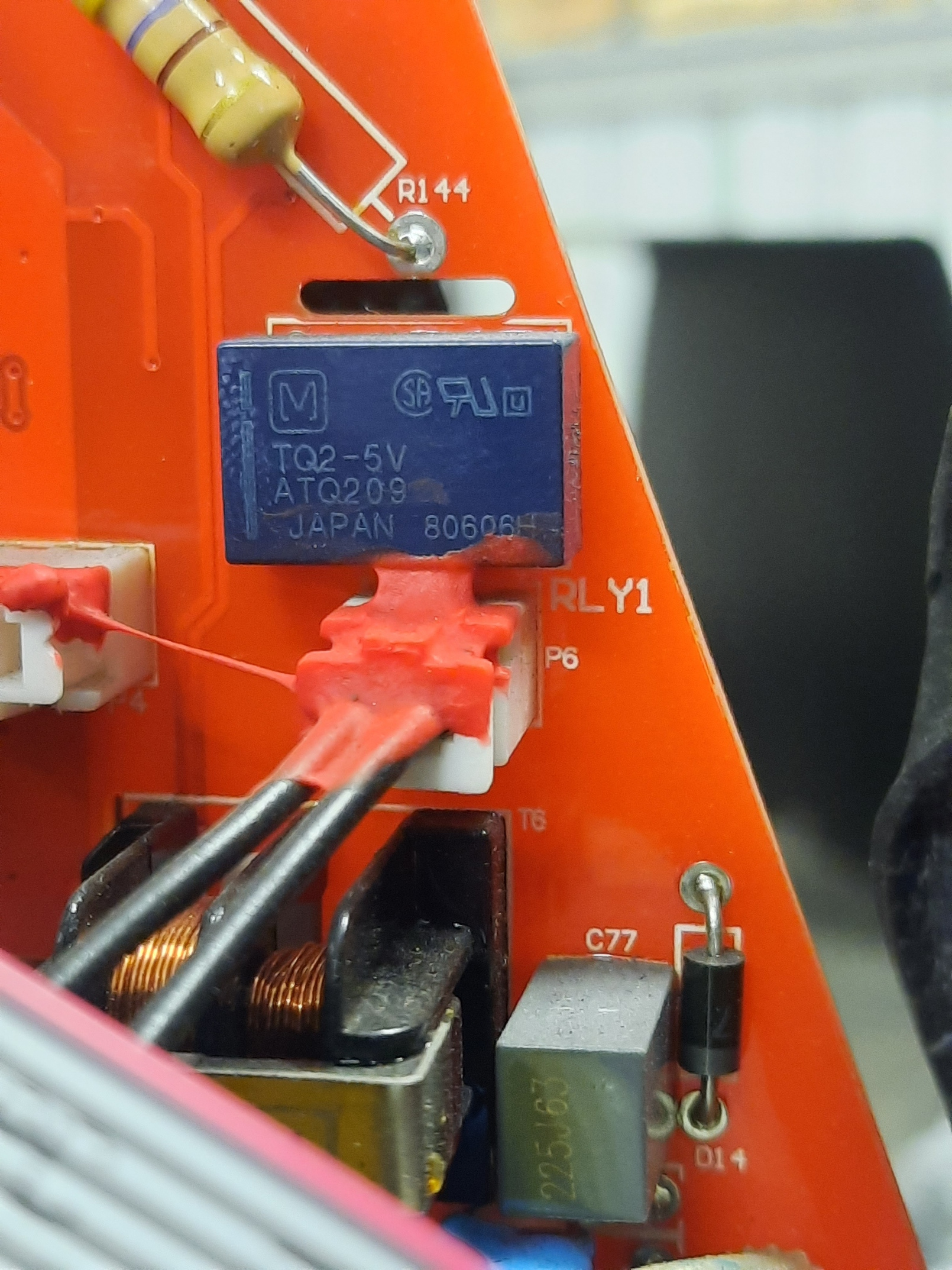

So this appears to be the 5V relay docs
4donline.ihs.com/images/VipMasterIC/IC/P...02568146F3353EA87419
It appears to be 1 amp at 30 volt DC so the 90 Ohm resistor ( 2 x 270 Ohm) will give 267 mA @ 24 Volt so its still within spec.

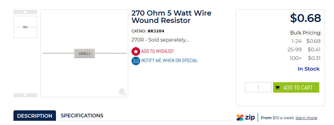

So 2 of these would do the job?
I checked for traces and connectivity but neither connect them together.

If that is the transfer relay then you shouldn't need any contact wetting. The minimum switching current for it is 10uA at 10mV.
Replied by phillc54 on topic Arc OK intermitent issues on torch fire
So this is the relay at the end of the transfer pins but it seems a lot smaller from what i was expecting to find.

My mistake, you need three!

only following through with this as i had swapped my one 1k 1watt resistor for one of the 270ohm 5 watt. because the manufacturer was vague so i didn't want to overload the relay with all 3 at once. But on that note was cutting great with the new 1 resistor until this afternoon when i can only assume something has let the magic smoke go as when the torch tries to fire now there is no pilot arc or ArkOK signal coming back to the GUI. so maybe i have blown the transfer relay i am thinking.
