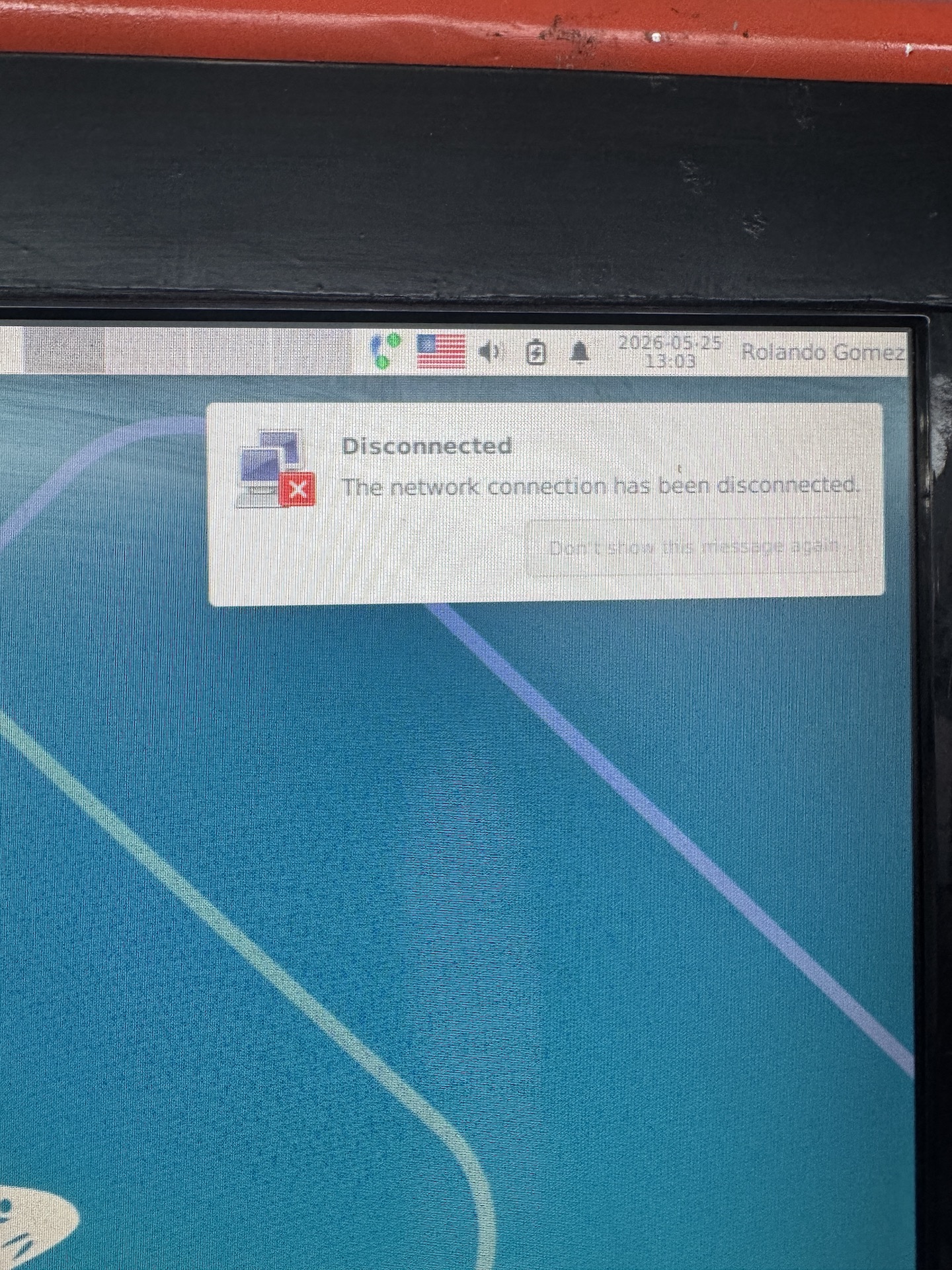

I ran pnconf wizard and made a configuration for my CNC plasma table. I am able to home and jog my machine for about a minute until I get this error.
It seems like the ethernet connection is disconnecting on its own somehow. Any ideas on how I could get the ethernet to stay connected so I can use my machine.

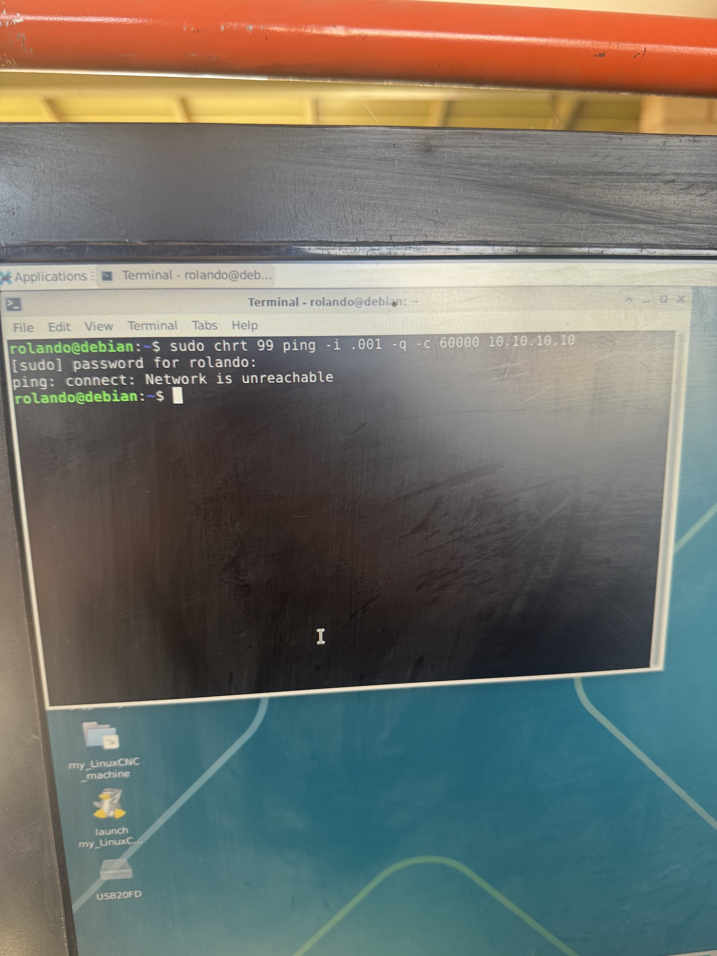

25 May 2026 23:04 #346630
Replied by PCW on topic Ethernet connection to Mesa 7i76e disconnecting on its own after one minute
What does:
sudo chrt 99 ping -i .001 -q -c 60000 [card_ip_address]
report? (it will run 1 minute then print statistics)
[card_ip_address] is either 10.10.10.10 or 192.168.1.121 depending on 7I76e jumpering
- RMJ fabrication
- Posts: 59
- Thank you received: 4
26 May 2026 00:31 #346632
by RMJ fabrication
Replied by RMJ fabrication on topic Ethernet connection to Mesa 7i76e disconnecting on its own after one minute
- Posts: 18111
- Thank you received: 5330

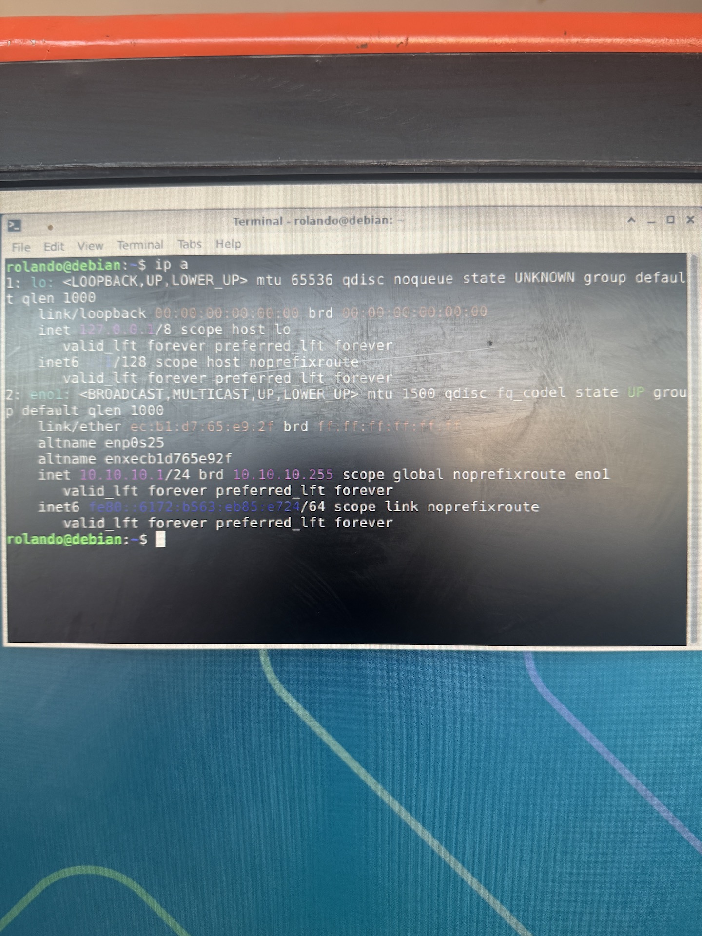

26 May 2026 01:38 #346636
Sounds like host or 7I76E issues
Whats does
ip a
report?
Whats does
ip a
report?
- RMJ fabrication
- Posts: 59
26 May 2026 01:52 #346638
