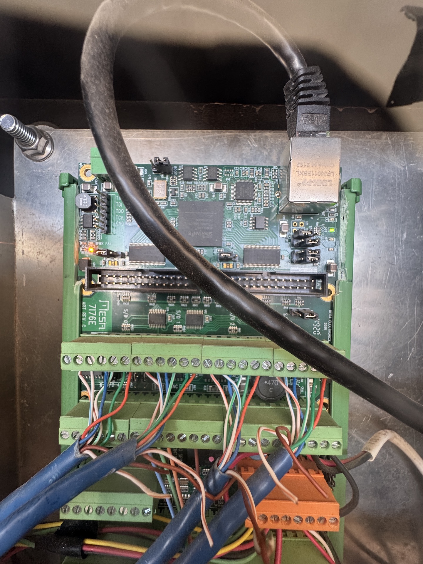

Also from photos of the board, it would be great if PCW could confirm that the links are set for the 10.10.10.10 address is set correctly. W2 down, W3 Up

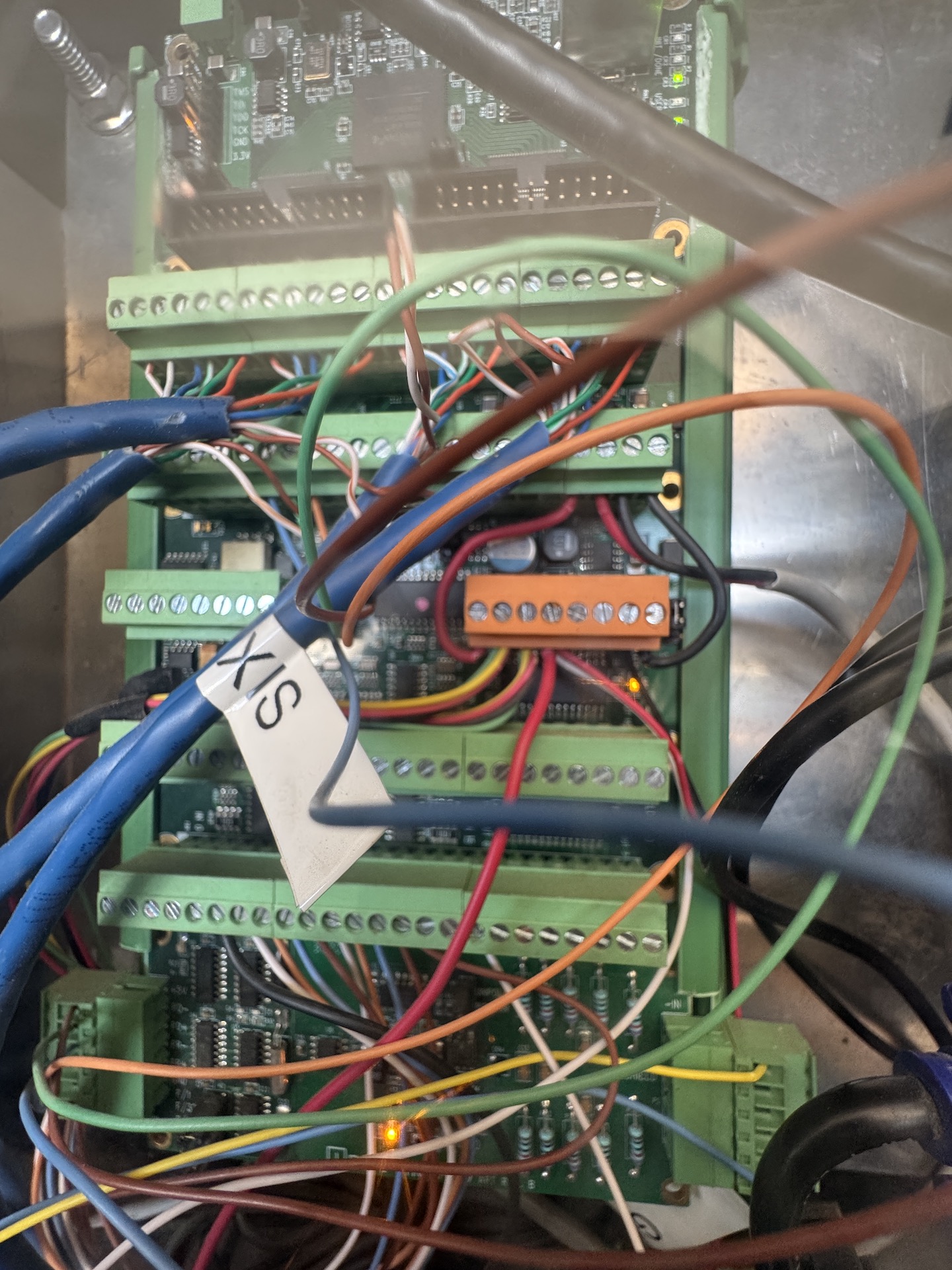

These are my HAL and INI files

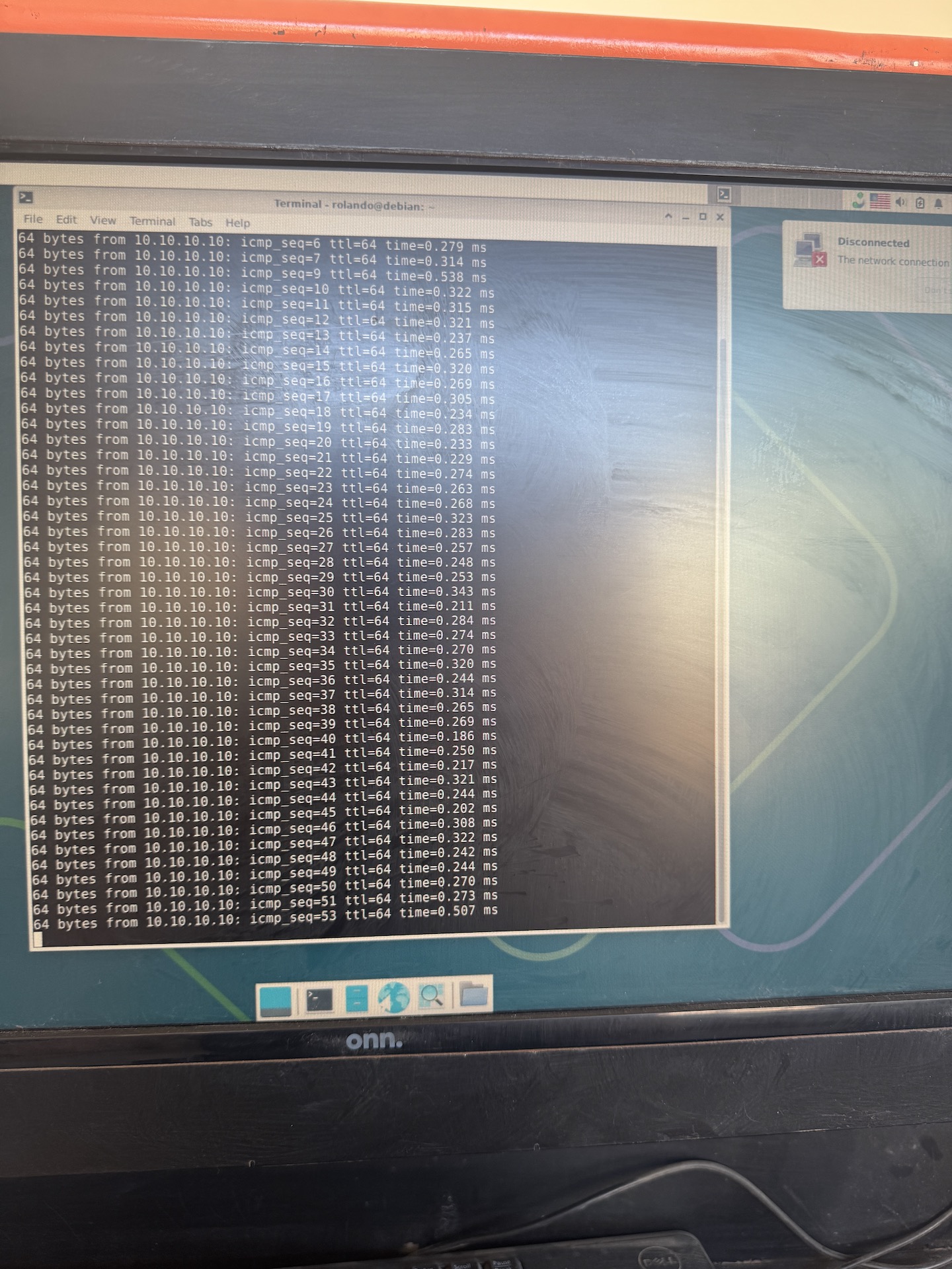

I can ping 10.10.10.10 but every time it goes over 0.500 ms it throws the error
These are my W2 and W3 jumpers

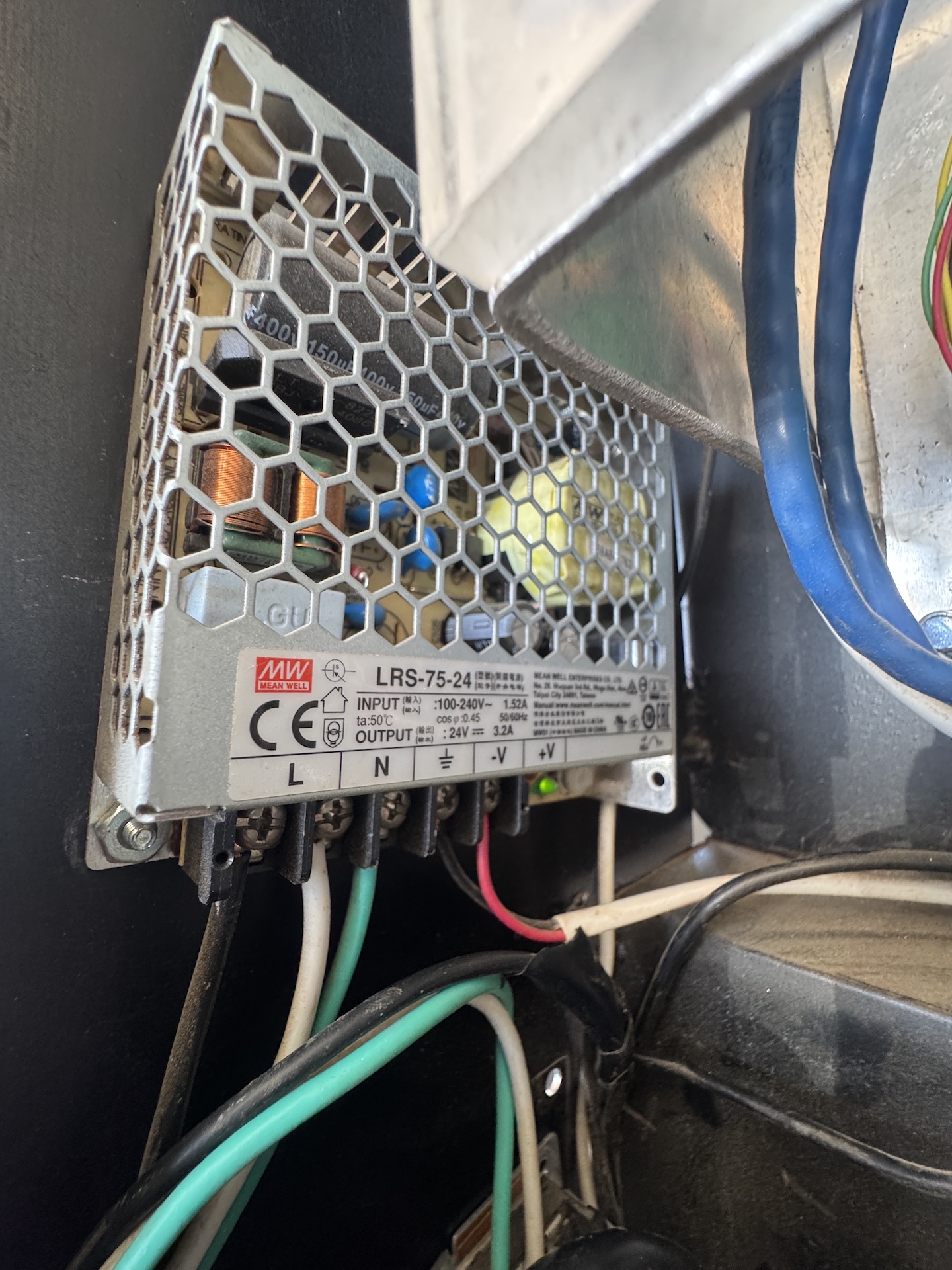

This is power to the board
This is the power supply to the board

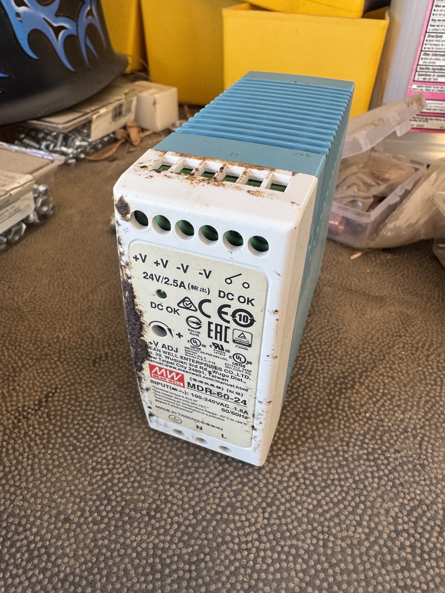

And I also have a Meanwell MDR 60 24 for testing its just a really old one.

Do you have anther PC or another Mesa card to see which device is dropping the connection?

Ooops, I saw the pings but missed the disconnect window. So to my mind, the only things that could cause this is faulty hardware, crappy network cable or a flakey power supply on the Mesa card. The Mesa power can be eliminated at this point. Time to follow PCW's advice to isolate that piece of hardware is causing it.
But the ping times are also too slow.
