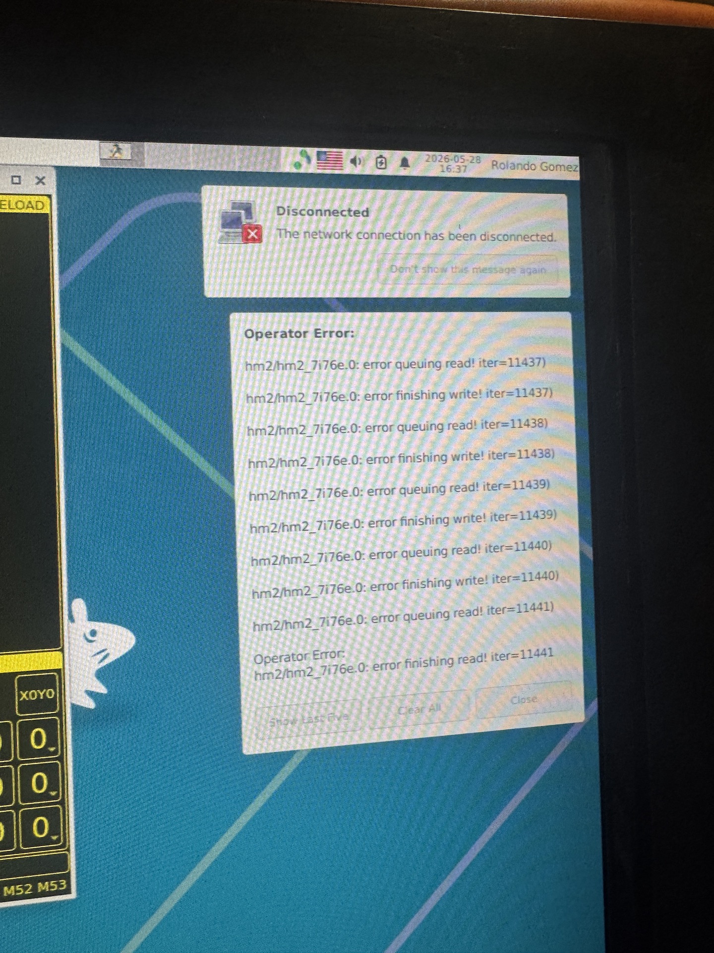

Ethernet connection to Mesa 7i76e disconnecting on its own after one minute

27 May 2026 23:43 #346695
by RMJ fabrication
Replied by RMJ fabrication on topic Ethernet connection to Mesa 7i76e disconnecting on its own after one minute
I turned everything off except the PC and it no longer disconnects on its own and it doesnt show my mesa connection. But when I turn the mesa board and the machine on it starts disconnecting again every 45 seconds. So now I think you guys have a good point and maybe this could be hardware related.

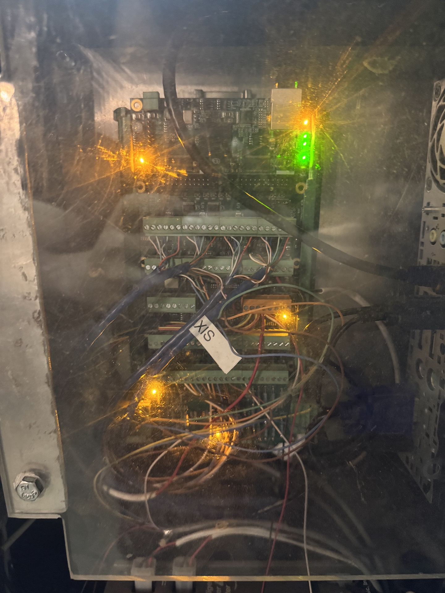

28 May 2026 00:16 #346697
Replied by PCW on topic Ethernet connection to Mesa 7i76e disconnecting on its own after one minute
When is disconnects, is the init light illuminated on the 7I76E?

29 May 2026 06:28 #346725
by RMJ fabrication
- Posts: 18111
- Thank you received: 5330
29 May 2026 14:08 #346736
OK, the /INIT LED is illuminated on the 7I76E which means this is not a 7I76E power issue
but either a host or 7I76E network issue. (The /INIT LED indicates a watchdog bite)

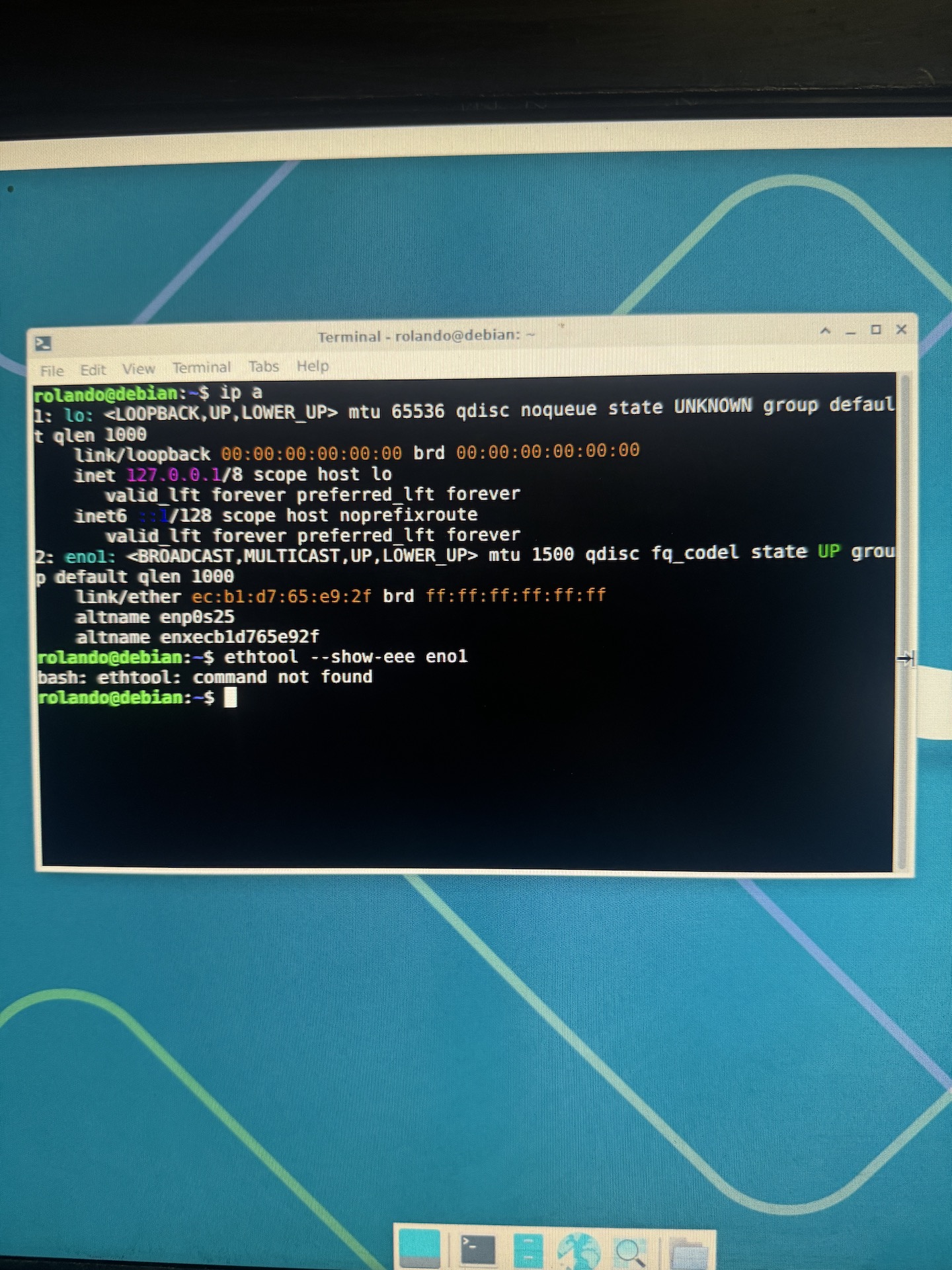

29 May 2026 16:41 #346739
It sounds like the maybe Ethernet on the host has power management or enabled or something similar
what does:
ethtool --show-eee [ethernet device name]
report?
[ethernet device name] is the name of the Ethernet device connected to the 7I76E,
something like eth0 or eno1. You can get the device name from a the results of
the command
ip a
what does:
report?
the command
ip a
- RMJ fabrication
- Posts: 59
- Thank you received: 4
30 May 2026 03:19 #346754
by RMJ fabrication
