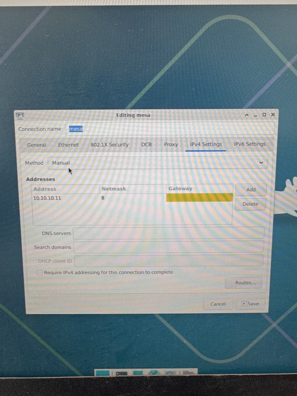

06 Sep 2026 21:37 #349401
forum.linuxcnc.org/27-driver-boards/3559...ethernet-mesa-boards
It clearly states to change that to manual.
Replied by tommylight on topic Ethernet connection to Mesa 7i76e disconnecting on its own after one minute
If you used this:All I had to do was switch this setting from automatic to manual in the network settings and boom works now!
