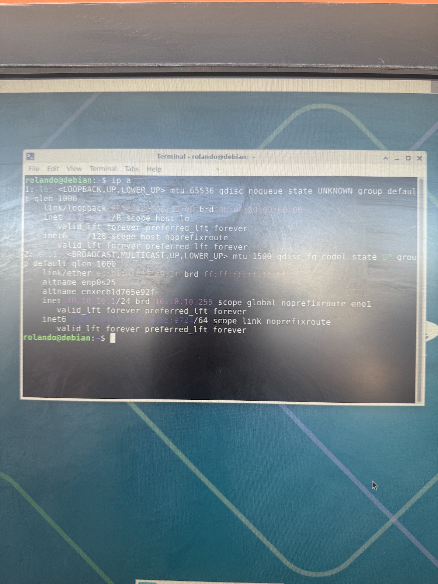

is the
ip a
result still reasonable?
What is the host hardware?
ip a

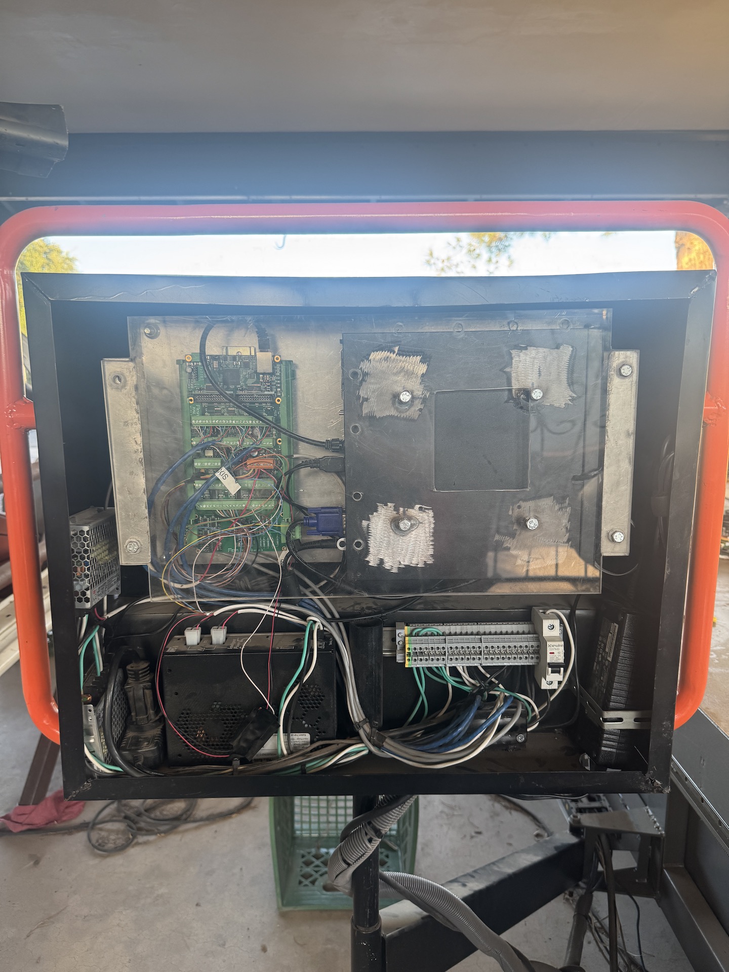

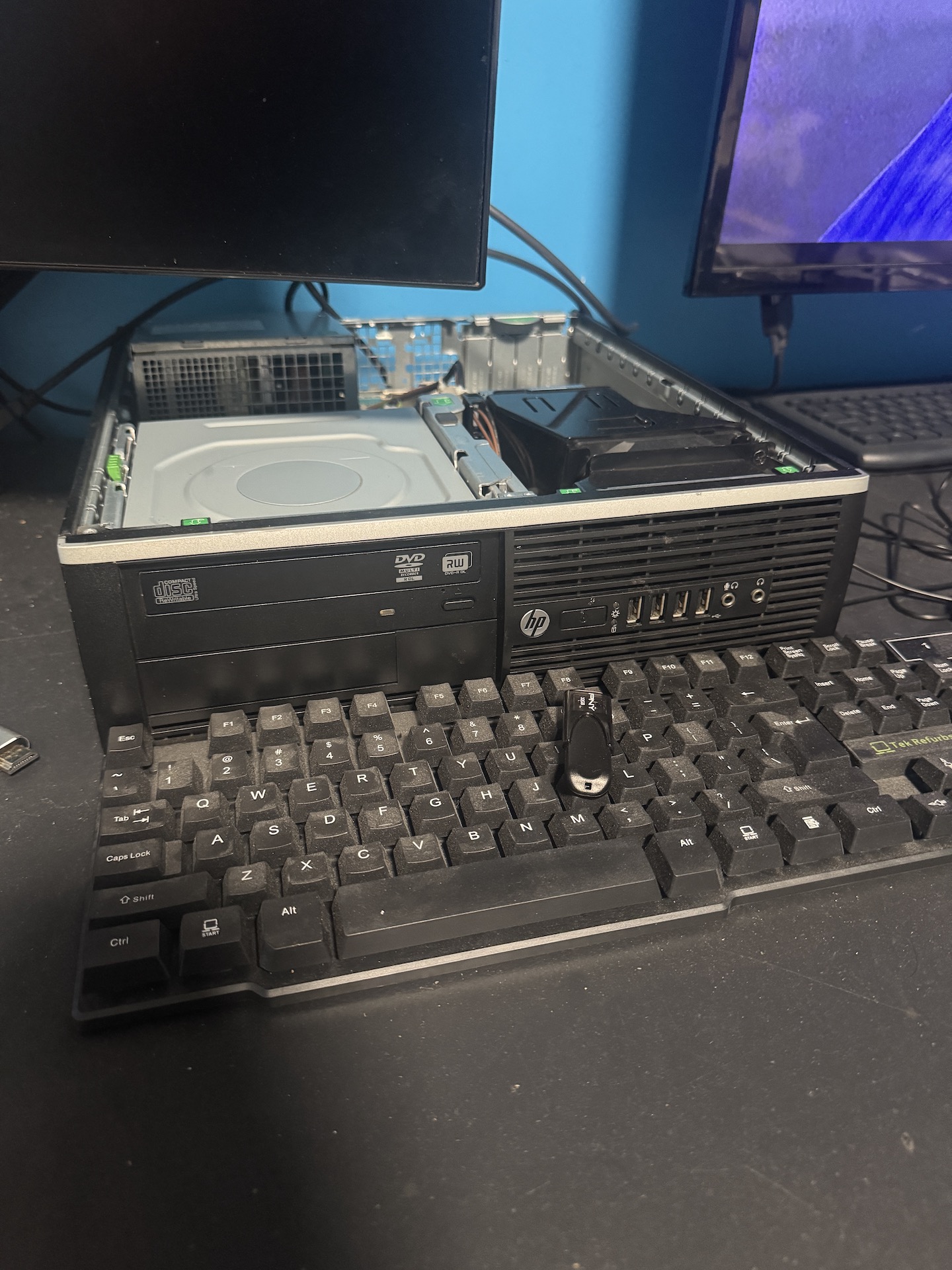

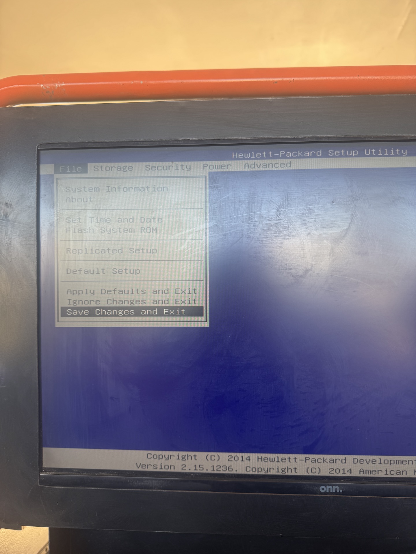

So some background information my plasma table electronics and mesa 7i76e are not new the PC is new a newer HP elite 8300 USDT I swapped it out recently following issues with this post forum.linuxcnc.org/plasmac/53087-qtplasm...e-0-in-middle-of-cut
- Posts: 18111
- Thank you received: 5330
30 May 2026 21:57 #346784
Replied by PCW on topic Ethernet connection to Mesa 7i76e disconnecting on its own after one minute

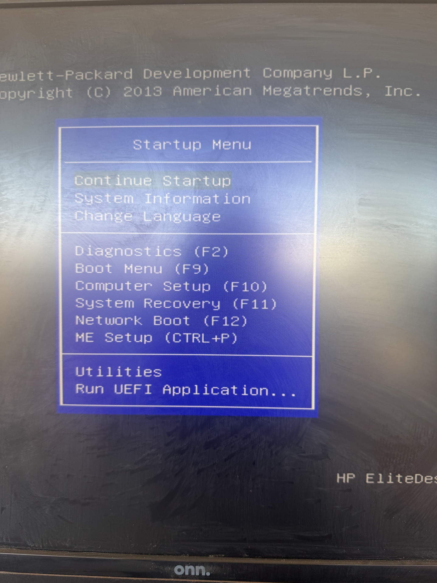

OK a 8300 USDT uses Intel hardware and should be fine
Is AMT disabled in the BIOS?

- Posts: 12159
- Thank you received: 4151
30 May 2026 23:40 #346786
Replied by rodw on topic Ethernet connection to Mesa 7i76e disconnecting on its own after one minute
There are a lot more tuning settings required but lets get the main one
Can you type: echo $(nproc)
and then back in grub customizer add isolcpus=X where X = $(nproc)-1 from what is printed from the line above.
Then reboot.
Then reboot.

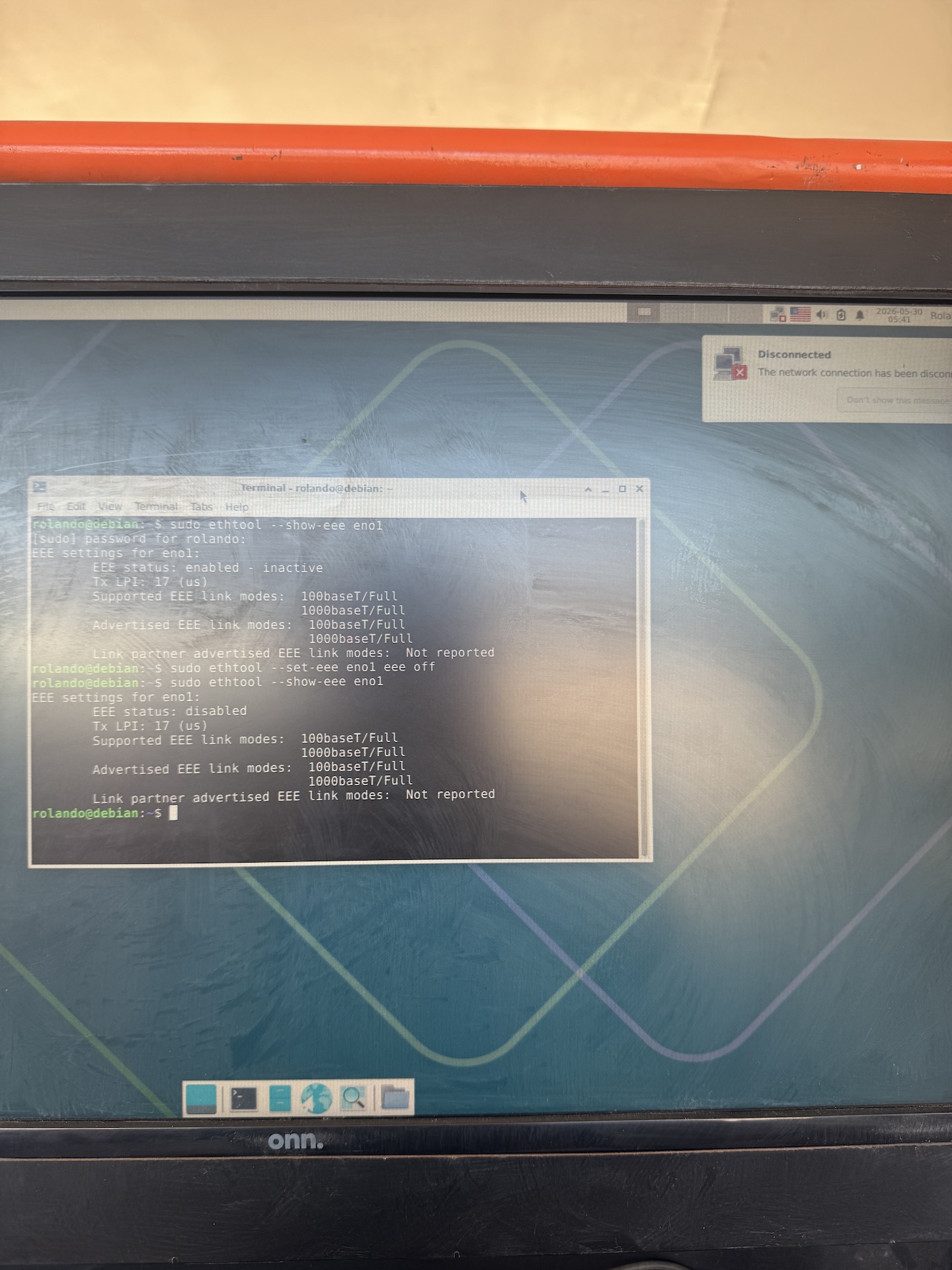

Replied by tommylight on topic Ethernet connection to Mesa 7i76e disconnecting on its own after one minute
Rod, no amount of tuning is gona help on a disconnected link.
Did you change the cable?
Do you have a USB-to-LAN adapter to test with?
Do you have another PC to test with, any PC with a different cable.
-But, only after the Mesa is connected and trying to run LinuxCNC.
