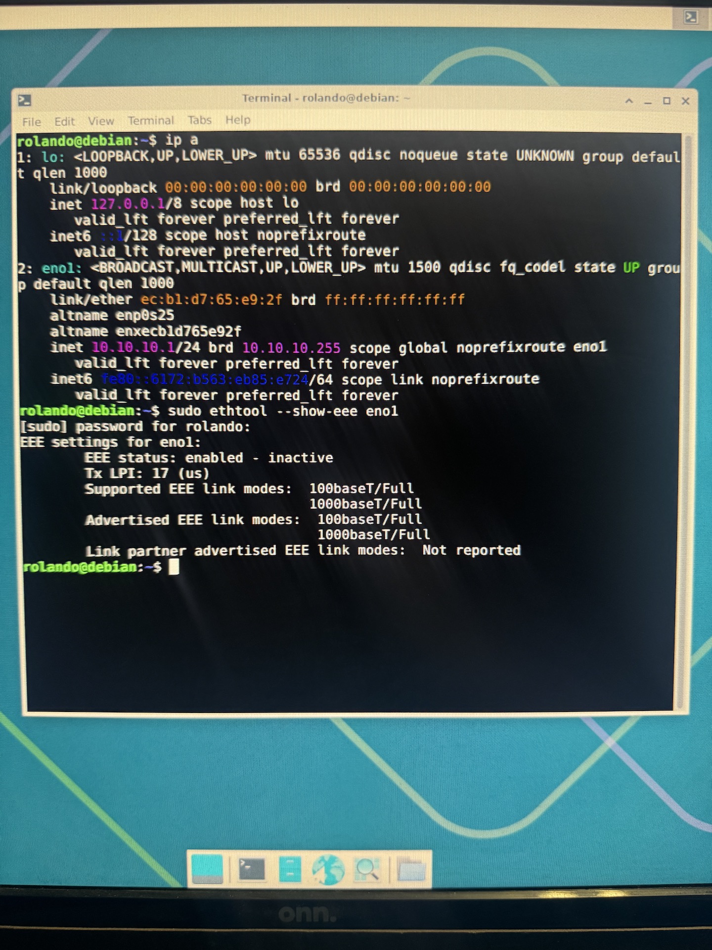

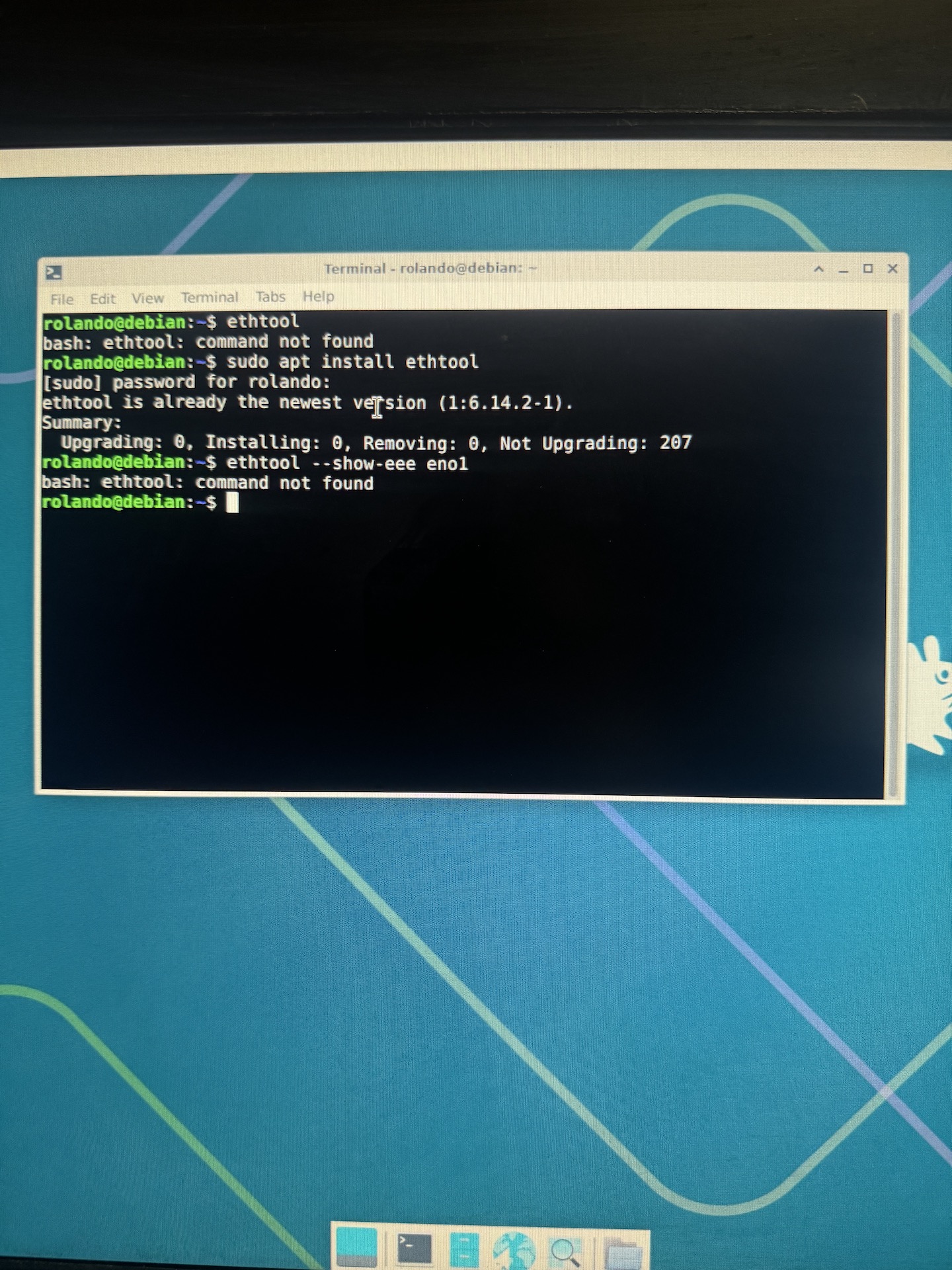

Replied by tommylight on topic Ethernet connection to Mesa 7i76e disconnecting on its own after one minute
sudo apt install ethtool
And the network is not set up properly or not connected???
- Posts: 18111
- Thank you received: 5330
30 May 2026 03:34 #346756
Replied by PCW on topic Ethernet connection to Mesa 7i76e disconnecting on its own after one minute
Yes, the network is not setup properly (no fixed IP address)

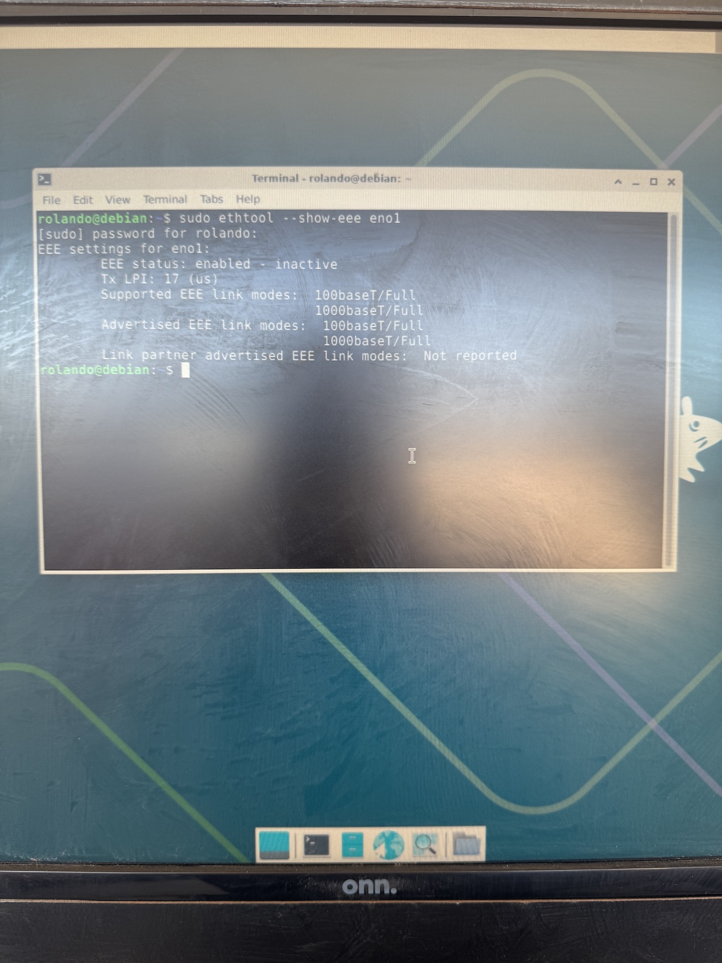

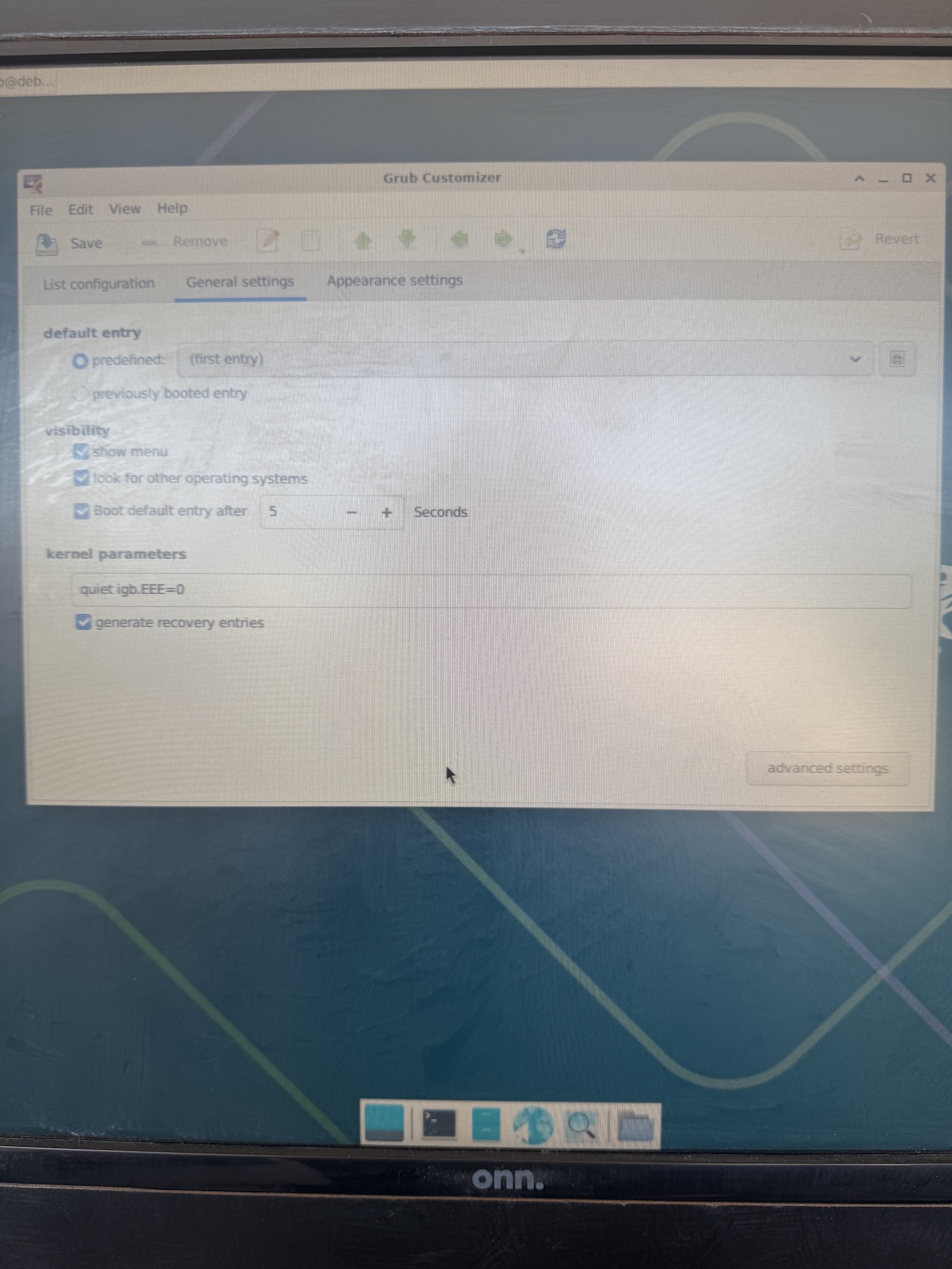

30 May 2026 10:23 - 30 May 2026 10:28 #346765
Replied by rodw on topic Ethernet connection to Mesa 7i76e disconnecting on its own after one minute
type: sudo ethtool --set-eee eno1 eee off
this will be lost on boot so to make it permanent
type
sudo grub-customizer
open the second tab and on the line it says quiet, add: igb.EEE=0
save and reboot.
check eee is off again with ethtool
With energy efficient Ethernet enabled, sometimes your NIC has a holiday which is not good for latency
Also type man hm2_eth and follow the instructions so disable coalescing if you have not done that yet on your 10.10.10.1 NIC

30 May 2026 10:27 #346766
once all that's done, do the ping command PCW asked for and share it. It should be pretty good now.
- Posts: 18111
30 May 2026 14:45 #346771
The reason ethtool is not found is that it's installed in /usr/sbin/
and that's not on the default user path. (but is in the default root path)
