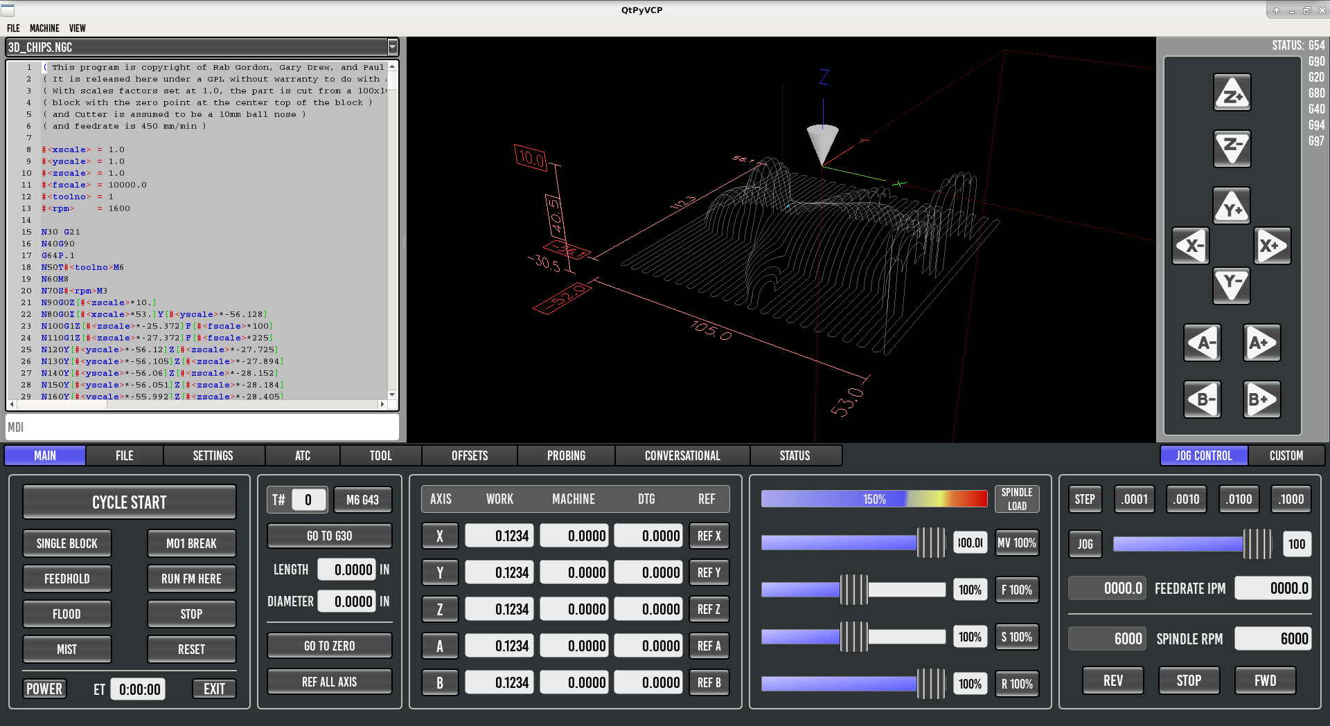

due to popular requests, we have added jog control and made it a tabbed item on the main window so that its available always, but also there is a customizable second tab that will allow users to add their own flavors of buttons, widgets and what not to personalize their installation of the gui for specific use. we also reconfigured the main window layout to accommodate these changes to make better sense logistically for the new jog feature putting the jog control step increments and such directly underneath it for ease of access. there is plenty of room on the wide screen version for this feature so no worries there, however it may be a bit of a challenge to figure it out on box screens, but we will do our best to see what we can come up with for you guys once we complete this one and have everything wired up!
here is a preview! as always thoughts are welcomed! it was also noted a few times about the 5 axis being shown when most only need 3, the short answer for that is we still have to design for the 5 axis if we will offer it, the 3 and 4 axis will be similar just without the extra buttons and a little more room between things in those groups, they will be probably bigger buttons there as well since less needs to be packed into the same space! so bear with us on that front!
and if you would like to donate your time and coding experience to help finish this sooner! head on over to #Hazzy on the irc, we would welcome some experienced coders who know python, qt, pyqt and are familiar with the LCNC connections as we are at the point of getting things tied together now! thanks in advance!
a very special thank you to Turboss, Hazzy, jschi for all their hard work in bringing this to fruition so far! it is a blast working with you guys!

I have to say, it is looking better and better with every iteration! I like the jog thingy very much as i plan to get my mints on a 17" touch screen, bigger ones are prohibitively expensive.
Great work from all of you. Thank you.

i would suggest you look for a 1920x1080 sized screen if you are wanting the jog buttons as the 1024x768 screen may be a bit difficult to squeeze those in on with everything else.. just giving you fair warning!!

Why don't you just dynamically add the axis buttons/controls based on the [TRAJ] COORDINATES when in world mode and jog controls in joint mode based on [KINS] JOINTS?

JT,
you are spot on! That is precisely how it will work, I expressed it poorly i think.. the graphical representation you guys are seeing is a representation for the master coders to use to code the proper sizes for the buttons, dro's, labels, layout boxes spacing etc so when the ini is modified for how ever many axis, or jog increment types etc, it knows how to format the ui items so things fit without going wonky looking. I am using 5 axis as the base model as it will consume the most space and we know everything under 5 axis will fit easily. so sizing for 5 axis ensures good clarity on font size, button size, spacing etc.. hope that makes a little more sense and was explained with less clumsiness...lol
for 2, 3, 4 axis we can set some constraints for the max and min stretch on the layout boxes, button sizes etc to allow for larger buttons if that will look good and make the interface easier to use etc. so when those are chosen it will expand/shrink to fit in the areas it needs to to accommodate without over stretching and looking funny. but everything begins with the biggest space requirement item which is the 5 axis ui configuration.
Thanks JT!
Chris

The DROs and jog controls for non active axes will be automatically hidden, or at the very least disabled.
