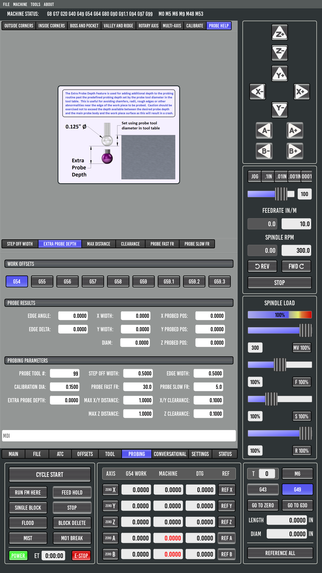

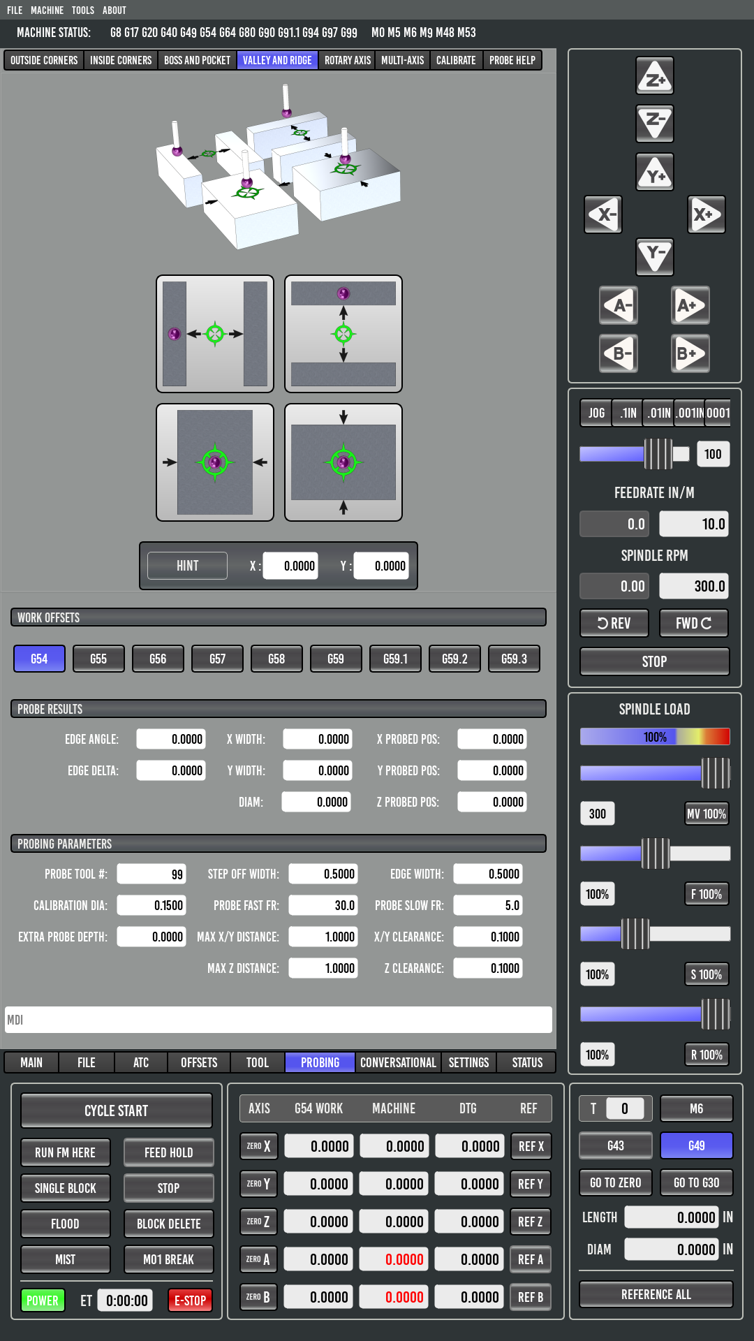

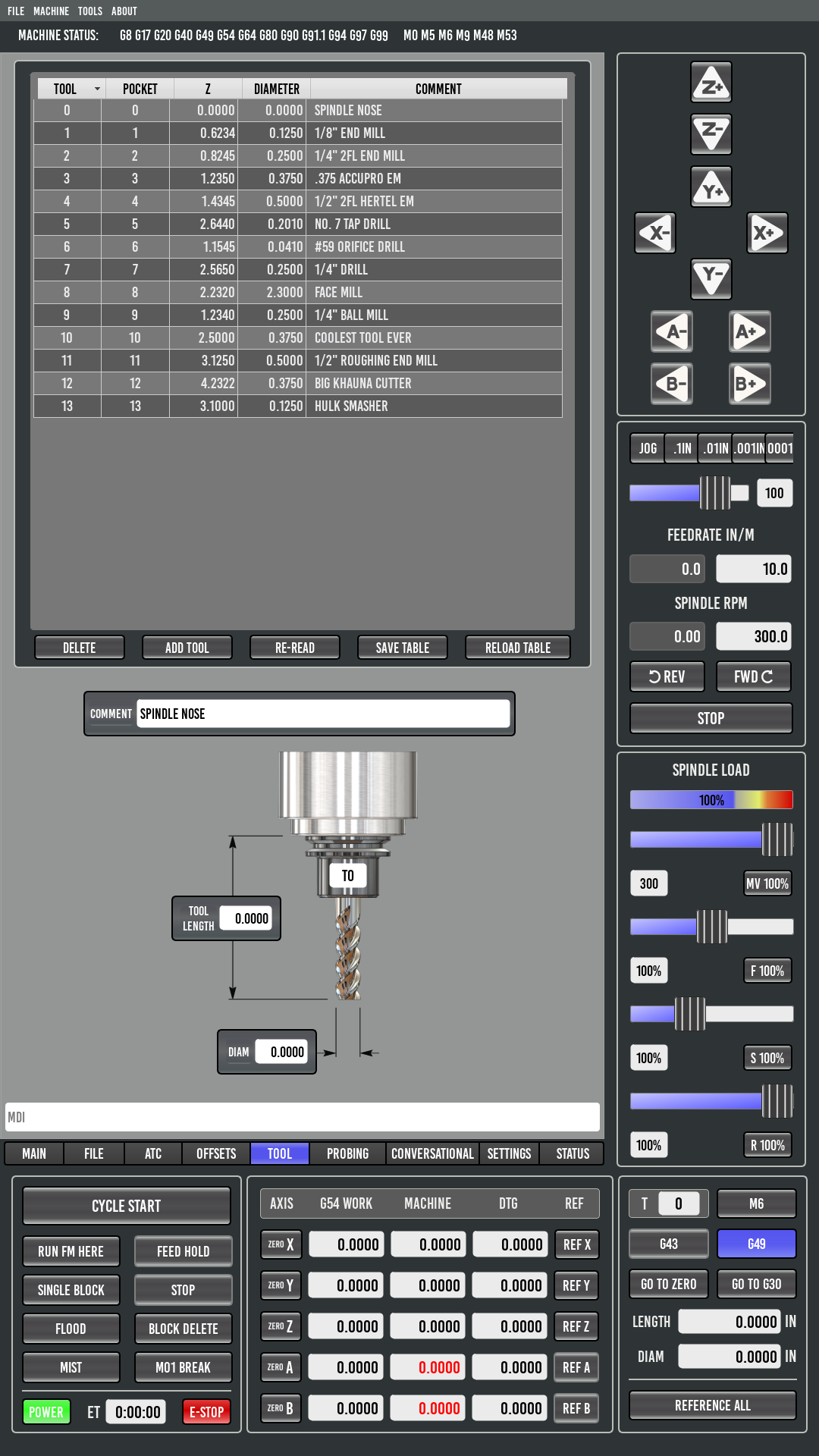

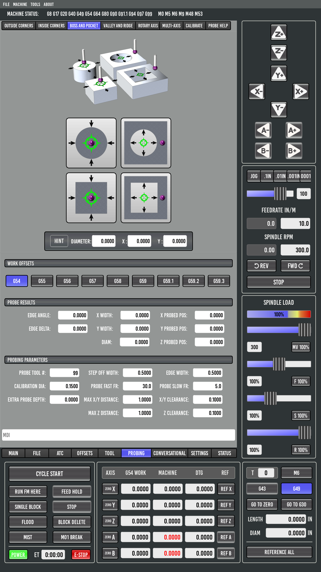

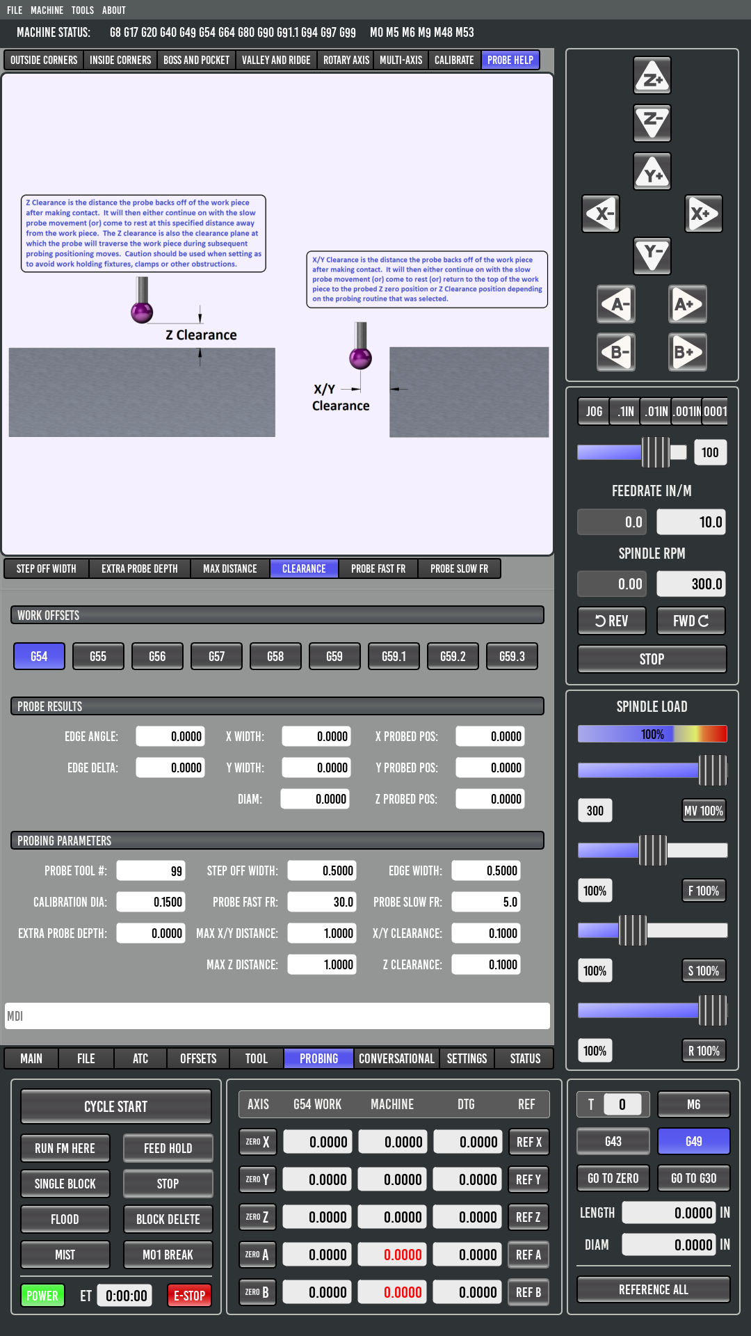

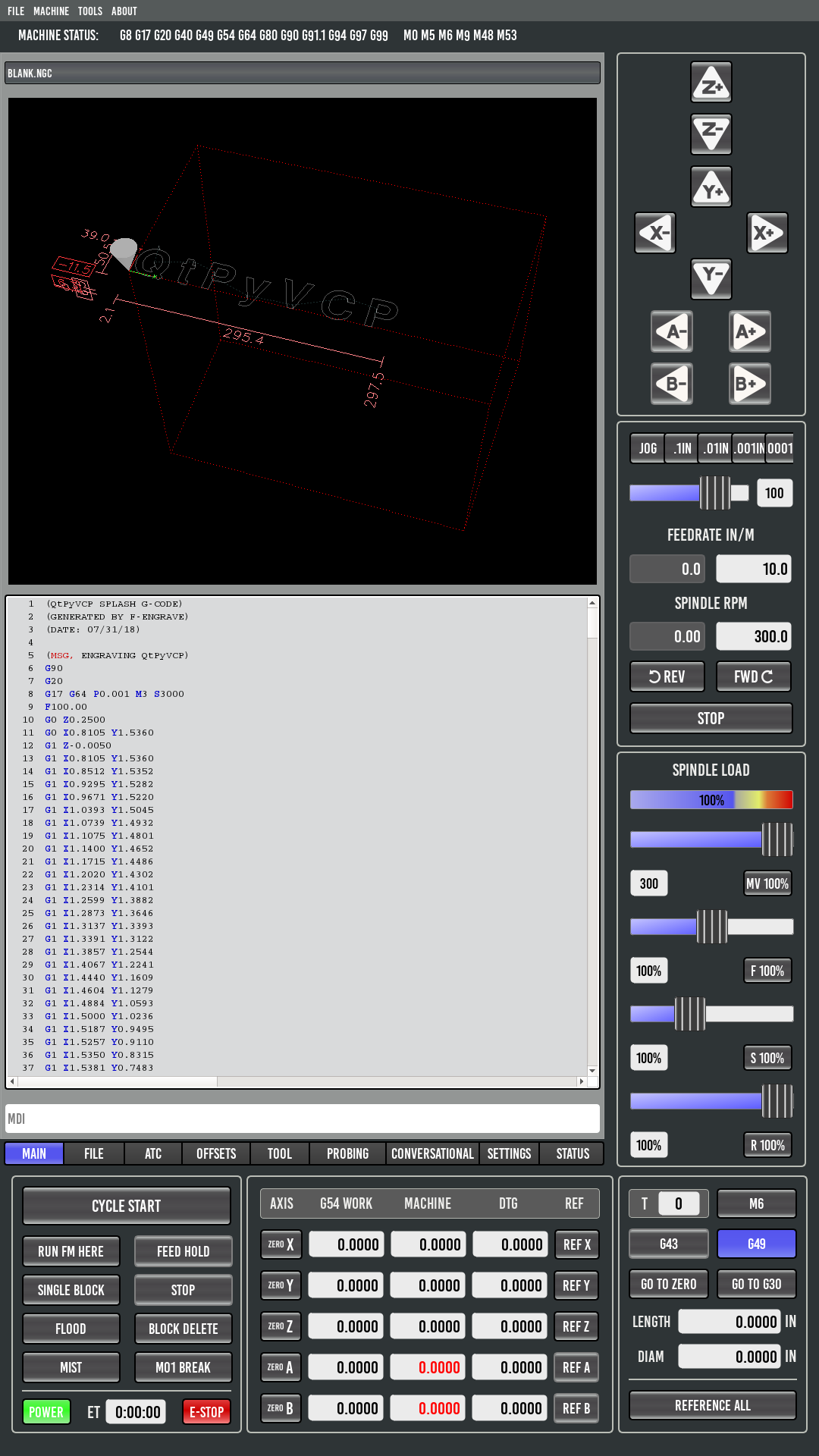

We had many requests on Instagram and via email for a vertical screen so while Hazzy and Turboss are finishing up the backend i took the liberty of putting a vertical layout together for those wanting that style screen. thanks to Hazzy's awesome VCP builder setup, it took very little time and as far as I could test all connections remained intact which means changing layouts should be pretty easy if you familiarize yourself with the QTDesigner software and the screen builds you are working within. pretty exciting times for Linuxcnc interfaces!!

Hello, this GUI is really nice looking!
I'm curious how this preview works?
How can be zoomed, moved and changed X Y Z? There are no buttons.
I'm searching for more than 2 weeks now how could I do some changes on preview but no success.
If you could help me with any informations I would be more than happy. (Already opened topic in forum with my issue)

Lcvette has not added any view control buttons, but the backplot has Slots for setting the view and clearing the live plot so they would be very easy to add.
With a mouse and keyboard you have good control over the backplot, but it's a little harder on a touchscreen, because you have no way to right click to get a menu. I would like to try using gestures, pinch to zoom etc.
With QtPyVCP you can change backplot colors from within QtDesigner. Eventually I plan to expose a lot more settings there, as well as make them settable from QSS stylesheets and from the .yaml config files.
Looking at the other topic you started it sounds like you are using QtVCP, this UI is made using QtPyVCP which was originally a branch of QtVCP, but at this point shares very little code.
You can find out more about QtPyVCP here: qtpyvcp.kcjengr.com/
