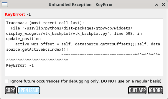

I got Probe Basic up and running now but as soon I do any movement of the machine I get this error (the servos still move however).
[qtpyvcp.app.launcher][CRITICAL]  Unhandled exception in vtk_backplot.py line 598 (launcher.py:37)
  File "/usr/lib/python3/dist-packages/qtpyvcp/widgets/display_widgets/vtk_backplot/vtk_backplot.py", line 598, in update_position
    active_wcs_offset = self._datasource.getWcsOffsets()[self._datasource.getActiveWcsIndex()]
KeyError: -1
I don't know if it's related but I also get this error on startup in the log.
[qtpyvcp.widgets.display_widgets.vtk_backplot.linuxcnc_datasource][WARNING]
KeyError: Likely means no program loaded. (linuxcnc_datasource.py:176)
Any idea what could be causing this?
07 Dec 2023 16:36 #287493 by dpslwk
a fix to qtpyvcp has just been pushed, apt update, apt upgrade should clear that up

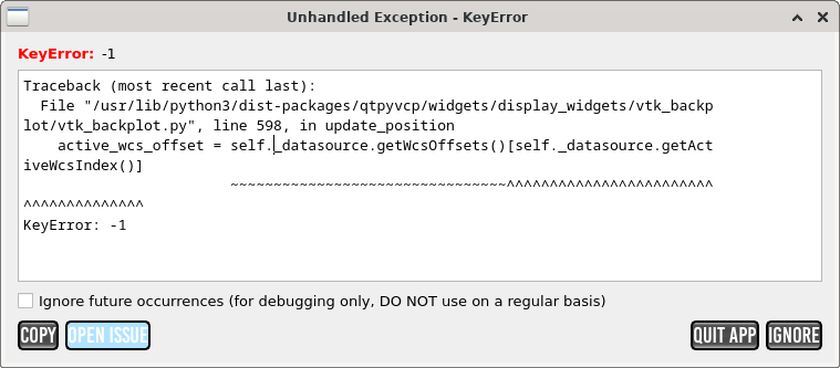

08 Dec 2023 03:42 #287507 by Unlogic
I installed the updated qtpycp package but I'm still getting the same error as soon as I do any movement of the machine:
KeyError: -1
The warning in the log during startup is also still there:
If I home the machine and select an offset like G55 the error goes away. Could it be that it always expects an offset to be set?
However when I get past the error and start moving the machine I instead get a segmentation fault, but that may be related to the graphics card in this machine so I'm gonna try this on another machine now.

08 Dec 2023 05:29 #287520 by dpslwk
hmm
well yes, seem it does expect be have an active wco g54-g59.3,
but I did not eve think it was possible to not have one set!
and most have G54 in there [RS274NGC]RS274NGC_STARTUP_CODE its in the recommended INI changes at the start of this guide for pb.
perhaps future posts on this should be moved to there own thread
