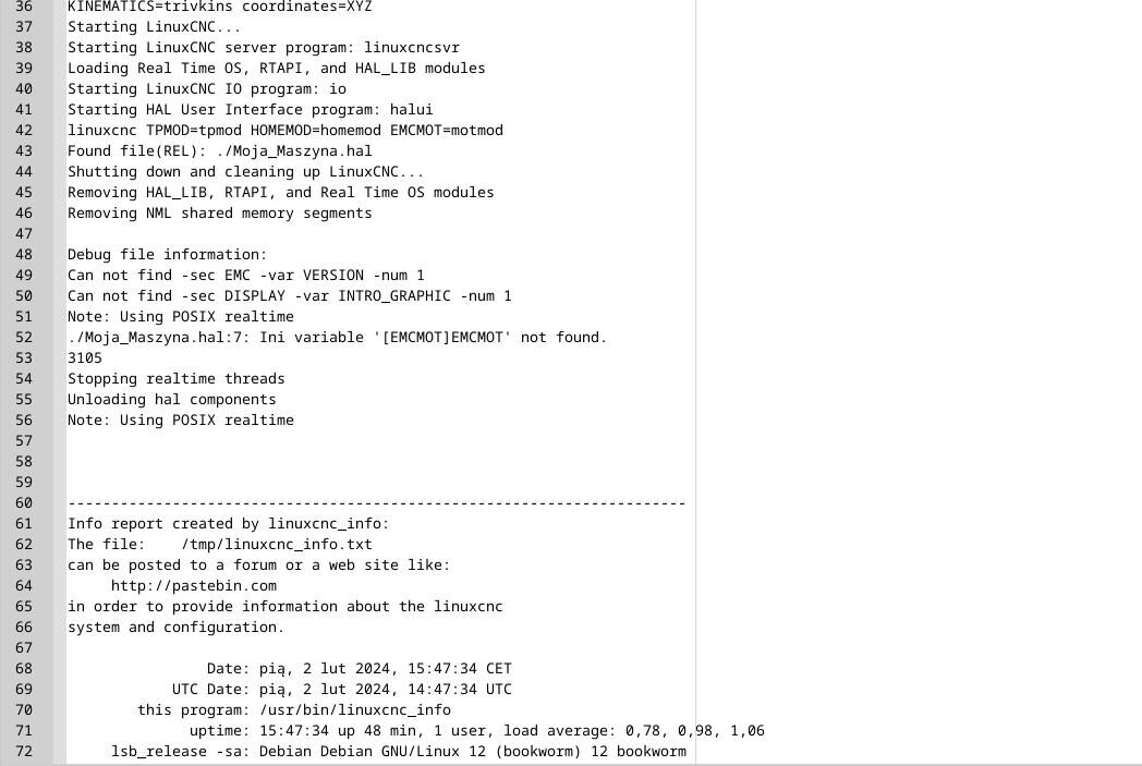

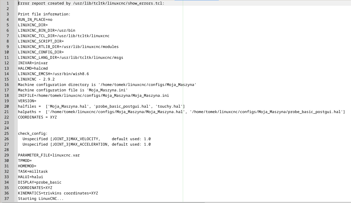

Hello.
I'm an absolute novice on the subject and I need help.
I installed Debian 12 from the website kcjengr.github.io/probe_basic/quick_start.html
I followed all the instructions.
The installation was successful, and the Probe Basic simulation starts up.
I configured the machine in Pncconf in Axis version, and everything seems to be okay.
Then, step by step, I followed the conversion instructions mentioned above. It seems to me that I did it correctly, only changing in the ini file in the "TRAJ" section from 5 axes to 3 axes and from XYZAB to XYZ. Previously, I changed G20 to G21.
Unfortunately, the program does not start, and an error pops up.
I'll add that the card I'm using is the Mesa 7i76e.
I attach the report generated by Linuxcnc to the post.Perhaps someone will notice something?

- Posts: 21900
- Thank you received: 7465
02 Feb 2024 18:43 #292238
Replied by tommylight on topic Py3 - Probe Basic Config Conversion Doc Lcnc 2.9+
The file
moya_maszina.hal
is missing some stuff, like for example :
moya_maszina.hal
loadrt [EMCMOT]EMCMOT servo_period_nsec=[EMCMOT]SERVO_PERIOD num_joints=[KINS]JOINTSPlease Log in or Create an account to join the conversation.
- Golab
- Posts: 12
02 Feb 2024 19:09 #292240
by Golab
Replied by Golab on topic Py3 - Probe Basic Config Conversion Doc Lcnc 2.9+
I think this entry is located in the file Moja_Maszyna.hal.
- Posts: 4811
- Thank you received: 2164
02 Feb 2024 19:28 - 02 Feb 2024 19:34 #292241
Replied by Aciera on topic Py3 - Probe Basic Config Conversion Doc Lcnc 2.9+
But the [EMCMOT] section in your ini file is empty.
[edit]
for your setup I would have expected something like this:
[EMCMOT]
EMCMOT = motmod
COMM_TIMEOUT = 1.0
SERVO_PERIOD = 1500000
[edit]
[EMCMOT]
EMCMOT = motmod
COMM_TIMEOUT = 1.0
Last edit: 02 Feb 2024 19:34 by Aciera.
