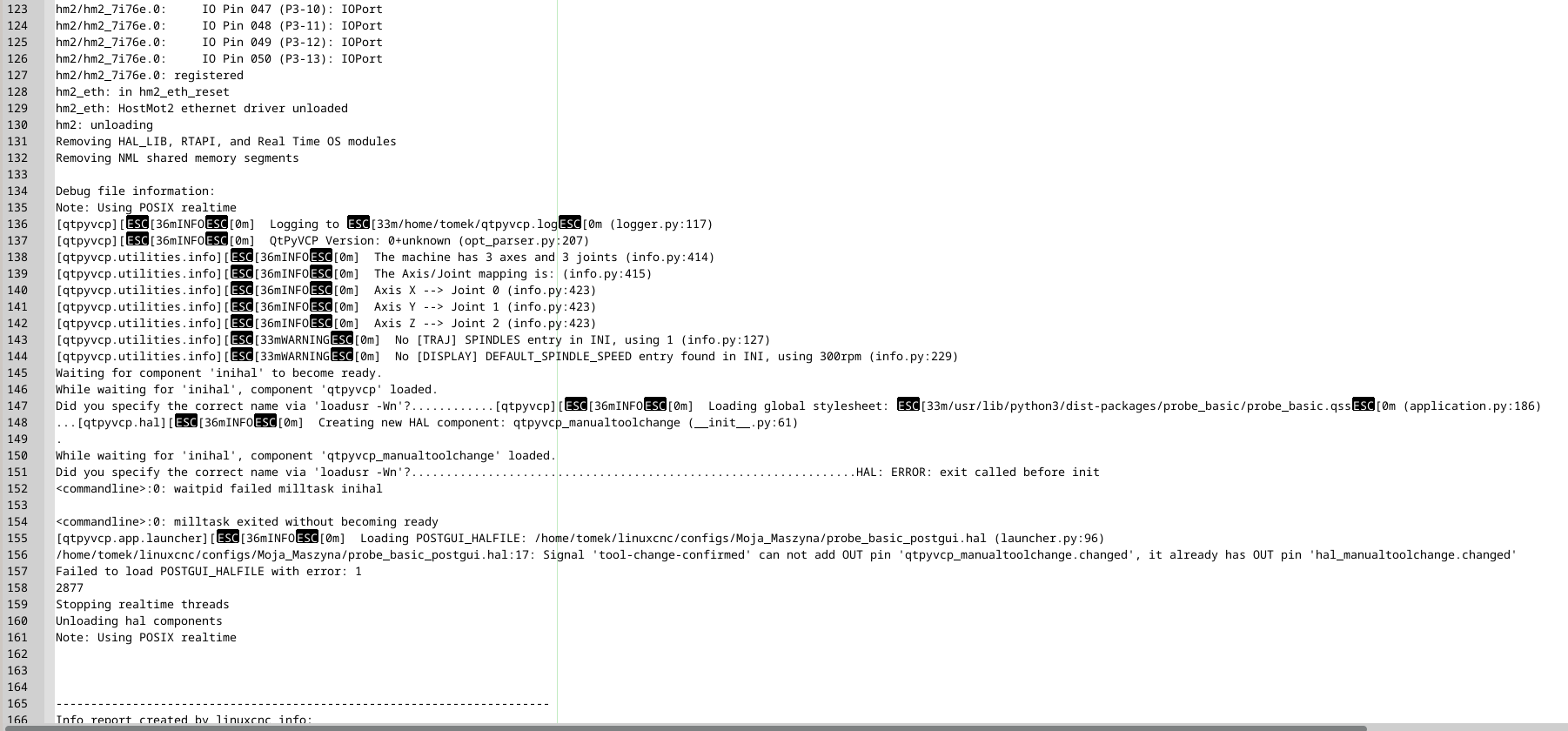

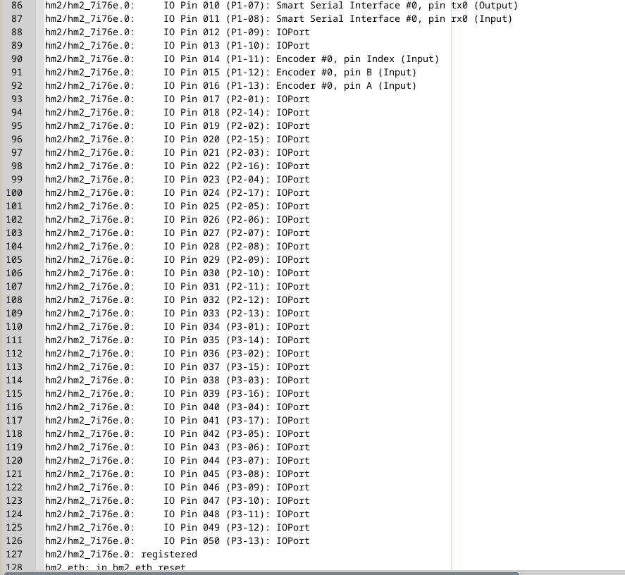

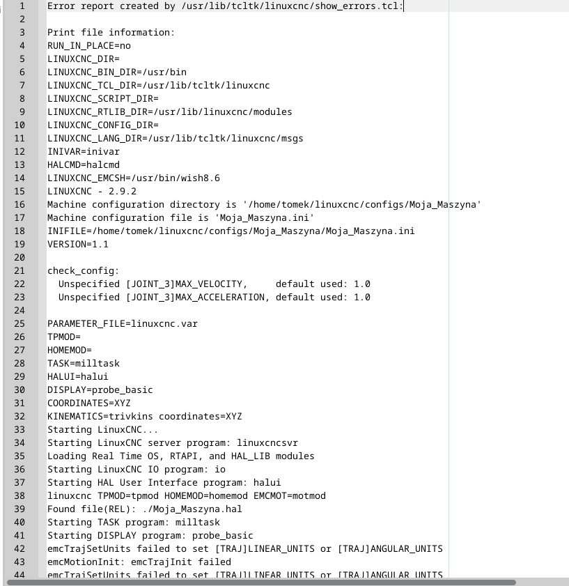

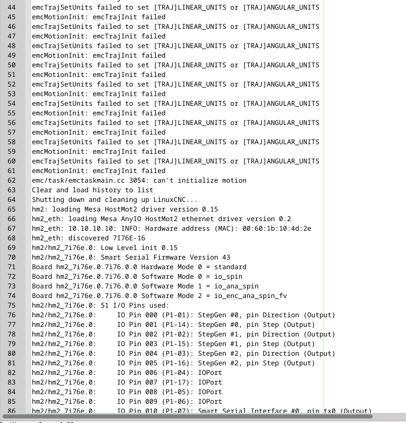

04 Feb 2024 10:21 #292412
by Golab
Replied by Golab on topic Py3 - Probe Basic Config Conversion Doc Lcnc 2.9+
In my ini. file, there was no such line at all.
I had to remove INTRO_GRAPHIC before. After adding it, the message in the report disappears.
Commenting out this line, of course, causes the message about looking for this line to appear. Overall, the program still does not start. It seems that this is not the main cause.
I attach the last screenshot report and the ini file.

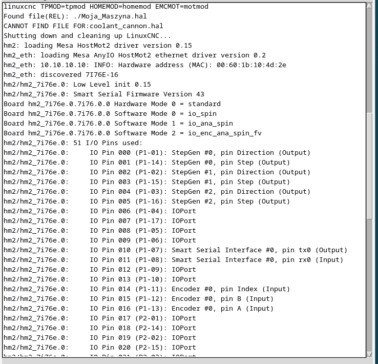

04 Feb 2024 13:43 #292430
Replied by tommylight on topic Py3 - Probe Basic Config Conversion Doc Lcnc 2.9+
You did not omit the "coolant_cannon.hal" file in the ini file, it is still looking for it.
- Golab
- Posts: 12

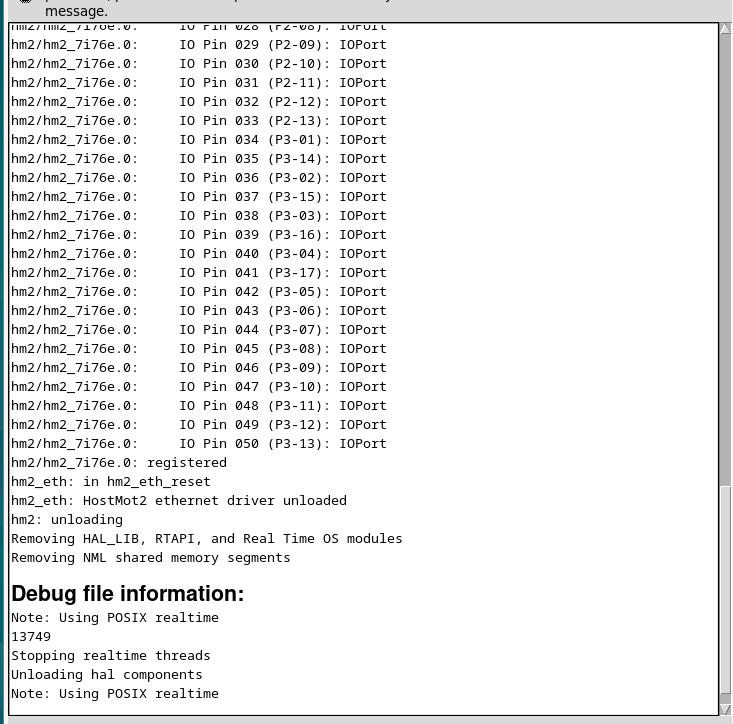

09 Feb 2024 07:29 - 09 Feb 2024 08:33 #292936
by Golab
In the HAL section of the ini file, I commented out the file "coolant_cannon.hal".
The program still doesn't start.
Ps.I pasted an image here and some gibberish popped up. Sorry

- Posts: 22030
- Thank you received: 7504
09 Feb 2024 09:18 #292942
OK, most of it is correct, the Mesa board gets set up fine, but there are errors with filename or missing file required by QtPyVCP.
Sorry, i have no experience with it.

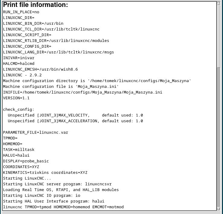

11 Feb 2024 09:19 - 12 Feb 2024 12:37 #293099
by Golab
I reinstalled the system (debian-12.5.0-amd64-netinst.iso).
Last time it was LinuxCNC_2.9.2-amd64hybrid.iso.Perhaps that was the cause of my failures.(mayby not)
I followed all the necessary steps provided on the Probe Basic .deb Installation instructions page, then tried to follow the instructions provided in this topic.
The program still doesn't start, but it seems I'm getting closer. Adding the line; USER_TABS_PATH = user_tabs/ to the DISPLAY section in the ini file, the interface appears along with the error message window (I'm attaching a screenshot).Unfortunately, when I press Ignore, the interface/program closes :(I'll add that GUI AXIS works. Sim PB too.

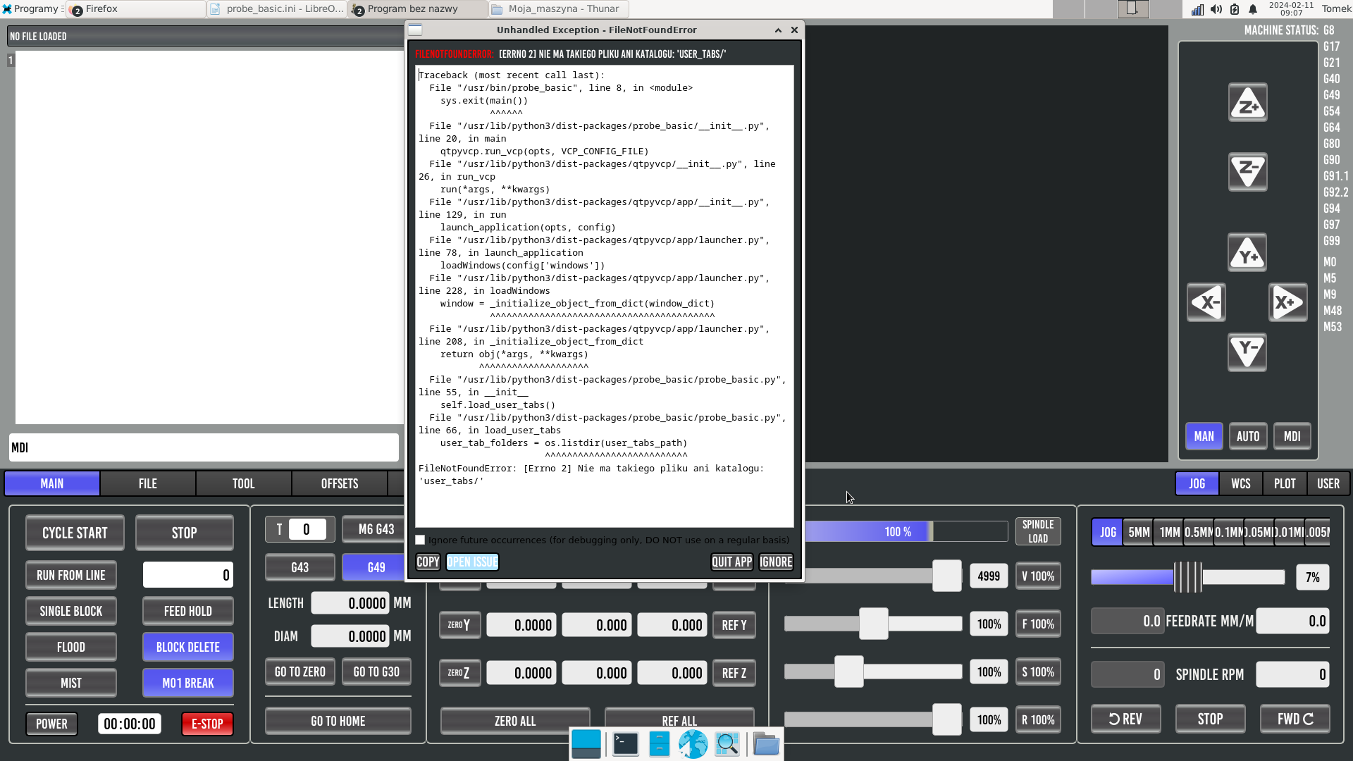

08 Aug 2024 13:02 - 08 Aug 2024 14:35 #307270
by anfänger
Replied by anfänger on topic Py3 - Probe Basic Config Conversion Doc Lcnc 2.9+
Hi I installed the development system with 2.9.3 and the deb files like in the tutorial described.
kcjengr.github.io/probe_basic/development_quick_start_apt.html
Then I tried to open my config I used with probe_basic under 2.8.2. Fixed the python3 issues with my own Hal components.
now it ts trying to start an I am expecting to fail due to missing Hal pins from qtpyvcp, cause I heavyly modified the ui file to match my machine.
but I get this error:
I guess try coming from my custom_config.yml
ad related files.
and when I emote the custom widget (its for setup sheets)
I come to the point where it fails due to missing pins.
copying my ui file over the one in the deb package let it fail again.
I guesss there were some changes which make it fail.
I'll made all ma chalets just to one tab I added.
So I did edit this section in the ui file. and still run into errors.
I am afraid I need to redo all ma work. maybe its faster since I've done it before
will there be a better option in the future keep custom tabs?
for more complex machines this might help a lot.
Thanks Patrick[/code]

File "/usr/lib/python3/dist-packages/PyQt5/uic/uiparser.py", line 806, in traverseWidgetTree
handler(self, child)
File "/usr/lib/python3/dist-packages/PyQt5/uic/uiparser.py", line 546, in handleItem
self.traverseWidgetTree(elem)
File "/usr/lib/python3/dist-packages/PyQt5/uic/uiparser.py", line 503, in createLayout
File "/usr/lib/python3/dist-packages/PyQt5/uic/uiparser.py", line 264, in createWidget
self.stack.push(self.setupObject(widget_class, parent, elem))
File "/usr/lib/python3/dist-packages/PyQt5/uic/uiparser.py", line 228, in setupObject
obj = self.factory.createQObject(clsname, name, args, is_attribute)
File "/usr/lib/python3/dist-packages/PyQt5/uic/objcreator.py", line 116, in createQObject
raise NoSuchWidgetError(classname)
PyQt5.uic.exceptions.NoSuchWidgetError: Unknown Qt widget: HalLCDNumber

for the vtk error, check the latest sim configs for changes there are many including the var file, Ini File, custom_config.yml, subroutines just about all of them, and the ui has received some pretty serious updates. that is one of the issues of trying to do customizations without using the user tabs. if you decide to make edits i strongly recommend using only the user tabs to do so which are not changed on updated and are loaded from your config folder.
Chris
Chris
