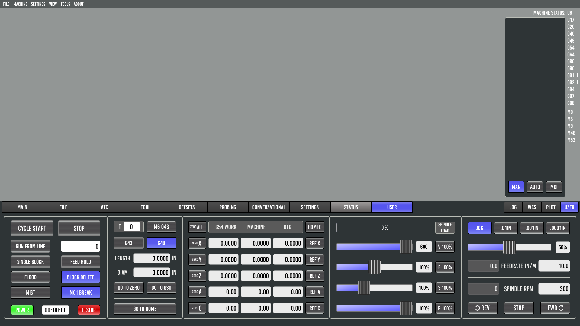

I started this project three years ago.
and relied in my experience of my first machine with prob basic. So i used my knowledge from five to six years ago. so there was not much documentation how to setup user tabs especially to find with my skills and my personal dislike for python.
I'll have a look at the latest Samples. And see where it brings me maybe there are now examples with user tabs.
But also a look at qtdragon was quite promising but its lacking a lathe interface for other projects. And I would like to have a similar look and feel.

user tabs are in the sim config folder, you simply turn them on or off in the ini file, there is one for the main tab group and the side bar, so it pretty much covers you for being able to add any functionality you may need.
now it doesn't work if you are changing the main ui and need to add things in, but if you have a good idea for a change or addition you can alway voice that here or on the qtpyvcp chat. we incorporate many ideas to make Probe Basic better often. that is where many of the latest update changes came from, made to fix some shortcomings and add some feature functionality!.
Below is an image of the user tabs. those should also be available in the stable version. you would simply edit those two files in qtdesigner and they are loaded on start up. this was they travel with your config and are never overwritten on updates. you can nest tabs to make them infinitely deep to accomodate the most intesnse project additions.

many thanks this way I can keep a lot of my own ui stuff just need to move it.

The user tabs are predefined ui's, you should be able to copy and paste to them. The latest version uses the var files for all parameters so they are callable from toolchange remap, same for all probe paramaters so they work if called from gcode etc.
Qtdragon is a good option too, more flavors is a good thing. As for leds for IO, I had that in there at one point but it caused some issues on faster machines and some computers, it slowed the non realtime layer down for some reason so I removed. But all that is available with halshow.

thanks the user tab works. and I am back on testing.

Just set it's window for airways on top
