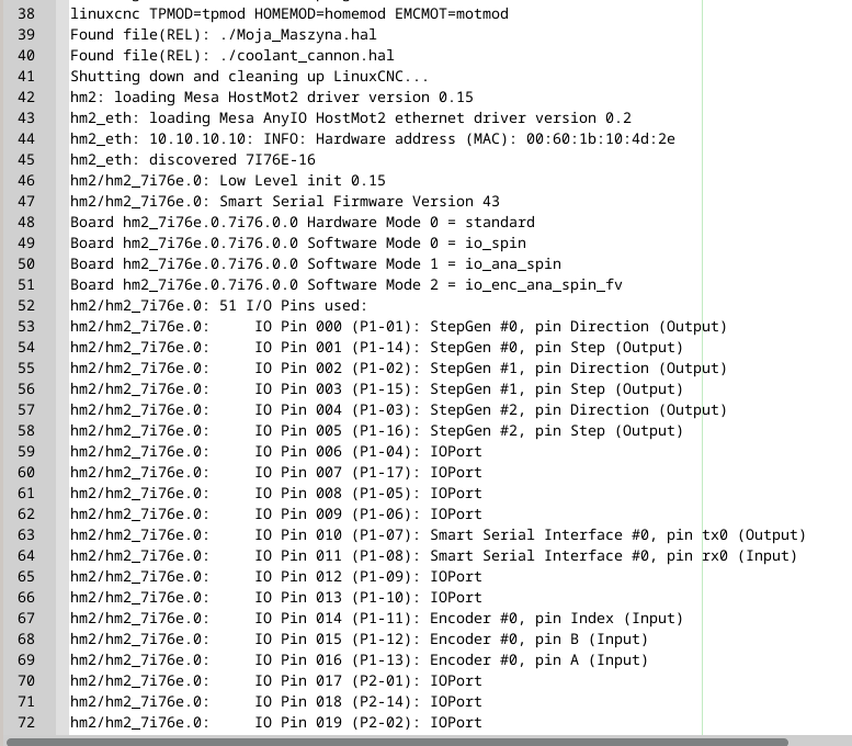

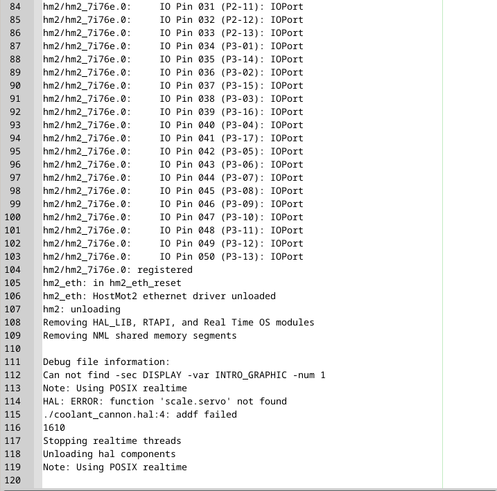

02 Feb 2024 20:24 #292245
by Golab
Replied by Golab on topic Py3 - Probe Basic Config Conversion Doc Lcnc 2.9+
Better, better, but the error still pops up.
I'm pasting a screenshot with the report.
- Posts: 21999
- Thank you received: 7488
02 Feb 2024 23:04 #292259
Replied by tommylight on topic Py3 - Probe Basic Config Conversion Doc Lcnc 2.9+
Attach here "coolant_cannon.hal"
- Golab
- Posts: 12
03 Feb 2024 06:41 #292282
by Golab
I'm attaching the file.
- Posts: 21999
03 Feb 2024 10:14 #292292
Several things seem wrong in that file, but first, is there any reason for not using the PWM own scaling?
What is that file supposed to do?

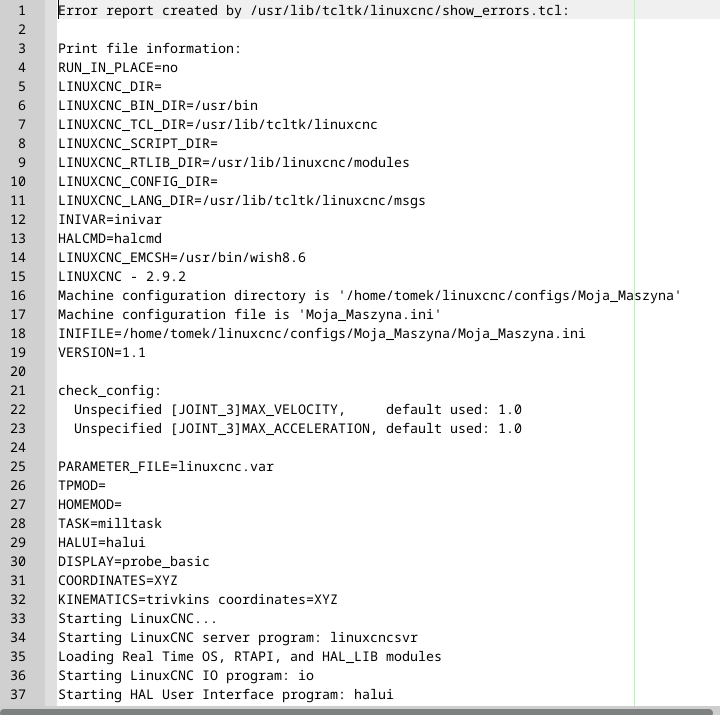

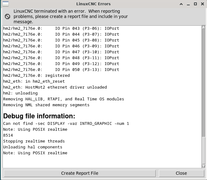

- Golab
- Posts: 12
04 Feb 2024 14:04 #292388
by Golab
I tried to run it without this file.
The error no longer appears, but the program still doesn't start.
I'm sending a screenshot of the report.
- Posts: 21999
04 Feb 2024 14:17 #292392
Nothing showing there, go up a bit and take another screenshot.
- Lcvette
- Posts: 1682
- Thank you received: 784
04 Feb 2024 14:25 #292397
by Lcvette
Replied by Lcvette on topic Py3 - Probe Basic Config Conversion Doc Lcnc 2.9+
Comment out the intro graphic line in the display section
- Posts: 21999
04 Feb 2024 14:29 #292400
Was looking for complicated stuff, as usuall.
I missed that, sorry.Comment out the intro graphic line in the display section
