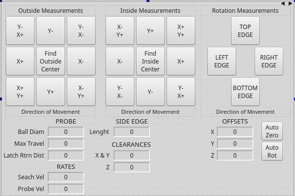

I have started to do some work in the probing panel layout. There is more to be added but I think that it will turn out ok. This is one panel where overlays will be desirable.
I think that it should be able to tie into the .py file by Serguei Glavatski and available on git hub at:
github.com/verser-git/probe_screen.git.
Overlays are available there also. I have used Serguei's probing for quite a while an it works very well. it uses glade so it may need a bit of conversion work to get it compatible qtvcp.
Here is the layout that I'm working on for the probing panel.

08 Nov 2018 01:18 #120235
Replied by cmorley on topic qtvcp issues
What do you mean by overlays?
I pushed a MDIHistory widget
and now ACTION can be used in button's python commands
Chris M
Chris M

08 Nov 2018 05:12 #120247
by auto-mation-assist
Replied by auto-mation-assist on topic qtvcp issues
Overlaying a button with a picture. Or putting picture on top of a button.
Overlay may not be the right word for QT.

08 Nov 2018 13:47 #120288
That was my guess but I didn't want to assume again
Icons are small images representing function. That would be the best parallel.
Chris M
Chris M

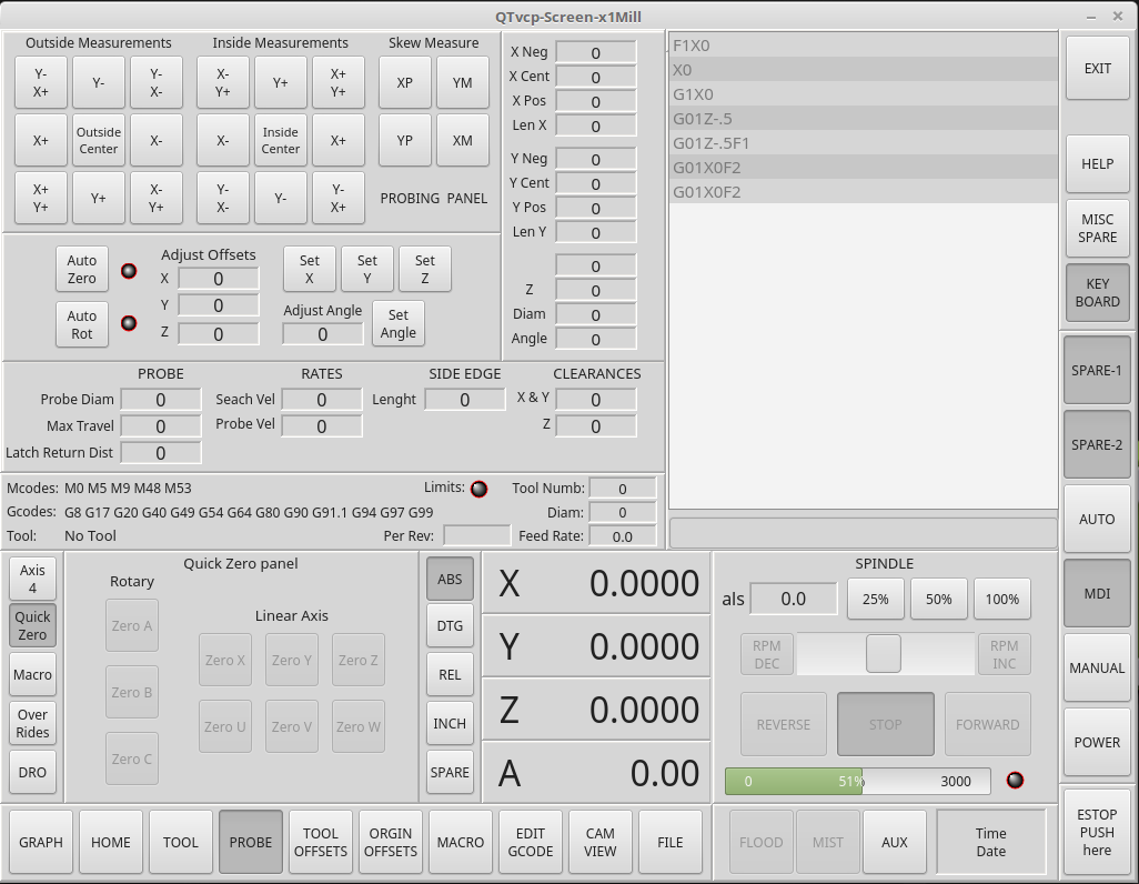

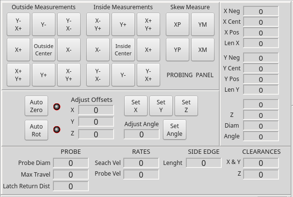

08 Nov 2018 22:28 - 08 Nov 2018 22:32 #120303
I have loaded the mdi history but have not been able to check it out because it appears to disabled for for input. You can see it in the picture I have attached for the updated probing panel. I believe the bottom is the input area for it and that should be raised up just a bit.
I have updated my initial panel layout for the probing interface. I think it includes everything that it needs for now and will allow coding to begin by using the verser version 1 .py as a a base to work with. The panel uses the same buttons although they have names that are renamed to be more compatible with the naming convention used in the x1Mill gui.
I will be making links to the probing related buttons and labels in the .ui and handler files in the next few days.
I have not been able to get any output from the onboard keyboard to display in a text label, or the mdi input and need a bit of help with that. Also when the panel is closed that the onboard keyboard is in, that need a keyboard kill or close cmd.
Her are a few pictures that show the current probing panel and mdi history off to its right. there are no images on the probing panel buttons right now.
