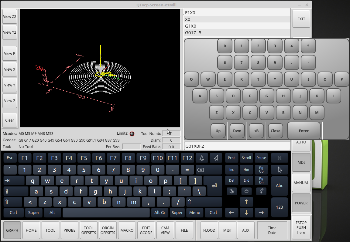

I went ahead and got the homing simulation working and was able to test out the the mdi history panel and it works fine. I think that it will beneficial to have a way to switch between the two keyboards shown in the picture. Perhaps there is already something like that that I'm not aware off..
I will start making the def items in the handler and .ui files today for the probing panel.

Replied by cmorley on topic qtvcp issues
The MDIHistory widget has a soft-keyboard property that can be changed.
Chris M
