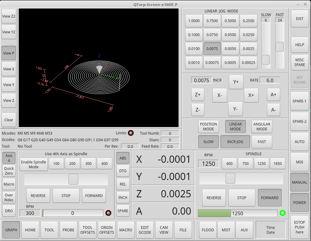

I have been working on getting my spindle functions working and I ran into a little problem with some motion pins not being available to my normal spindle control configuration. I had commented these out to get things running but as I progress and start activating those items it has become problem with getting my spindle control functions to work properly.
In my linuxcnc-dev configuration in the shop they all show up. I’m wondering now If this possibly a linuxcnc version related issue and if I need to add the qtvcp items into a standard Linuxcnc_dev configuration and then recompile to precede further. Documentation for motion.9 indicates that they should be available.
Here is a partial list of hal pins that cannot be accessed from within my .hal file.
Pin 'motion.spindle-index-enable' does not exist
Pin 'motion.spindle-orient' does not exist
Pin 'motion.spindle-orient-angle' does not exist
Pin 'motion.spindle-forward' does not exist
Pin 'motion.spindle-reverse' does not exist
Pin 'motion.spindle-revs' does not exist
Pin 'motion.spindle-speed-in' does not exist
Pin 'motion.spindle-speed-out' does not exist
Pin 'motion.spindle-on' does not exist
Pin 'motion.spindle-at-speed' does not exist

12 Dec 2018 17:11 #122327
Replied by rodw on topic qtvcp issues
IF you are running v 2.8, its multi spindle now so there is a .0. in the pin names somewhere.

12 Dec 2018 17:46 #122333
Replied by cmorley on topic qtvcp issues
Rod is correct qt5vcp is behind master a bit but it did get multi spindle work in.
The pins also don't have 'motion' in the name anymore, look here for info:
linuxcnc.org/docs/devel/html/config/core...html#sec:motion-pins

- Posts: 19902
13 Dec 2018 04:25 #122358
Replied by andypugh on topic qtvcp issues
See also here: linuxcnc.org/docs/devel/html/getting-sta...iple_spindle_support
(If you set your INI version to 1.0 then conversion to the new spindle pin names and version 1,1 should be automatic)

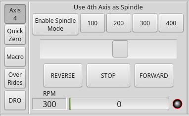

I was able to implement the changes for the new required spindle commands and those all work fine now. I’m proceeding to work on the spindle control for my horizontal 4th axis which will use some code I developed about a year age but which requires some changes to the mesa driver to allow some parameters to become pins.
The spindle rates are fully adjustable via the sliders and can also be pre-set via the four buttons. Those are defined in the .ini file and buttons are name automatically. The jog increment buttons and there slow fast rate sliders work the same way.
4th axis control area and overall picture update.

I have read the documentation for additional spindles again and now have a second spindle showing up in hal show. I will configure this spindle for closed loop operation for position and velocity modes and orient. I did notice that the second spindle does not show up in halui.
I’m using the below code to control spindle.0 which works fine and wonder if qtvcp can handle routing similar code to control spindle.1
# set spindle 0 speed
def scrb_spindle_0_rpm_setValue(self,value):
spin_0_rps = float(value)/10000
self.cmnd.spindleoverride(spin_0_rps)
self.w.lab_spindle_0_rpm.setText(str(self.w.scrb_spindle_0_rpm.value()/100))
def pbtn_spindle_0_forward_toggle(self):
ACTION.SET_SPINDLE_ROTATION(linuxcnc.SPINDLE_FORWARD)
def pbtn_spindle_0_stop_toggle(self):
ACTION.SET_SPINDLE_STOP()
def pbtn_spindle_0_reverse_toggle(self):
ACTION.SET_SPINDLE_ROTATION(linuxcnc.SPINDLE_REVERSE)
