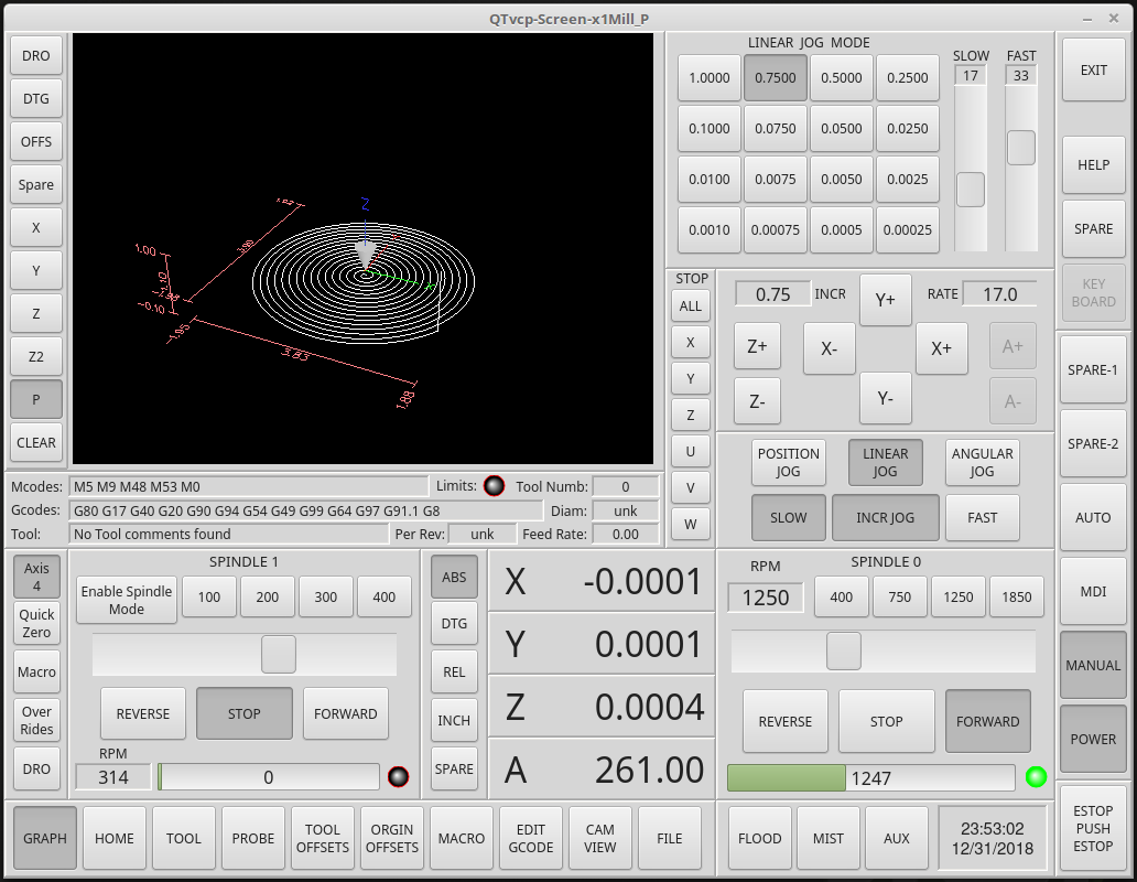

Happy new year everyone.
I have been busy these last three weeks but continue to work on my gui project as time allows. I plan to upload what I have completed so far after I draw a layered map of the gui that allows cross referencing buttons and other items to specific areas and layers.
Current picture is attached. of the main panel.

Looking great!

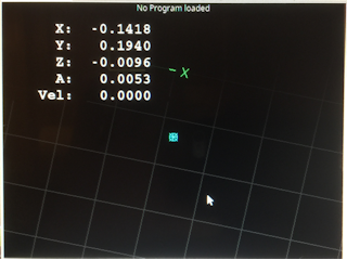

Yesterday while doing some work on switching between inch and mm unit mode I ran into a problem that I think was caused by some code that I had placed in the ini file just to have something to load. I suspect it may have been this but I could have nothing to do with it.
[X1GUI]
POSITION_MAX_RATE = 50
POSITION_SLOW = 10
POSITION_FAST = 30
POSITION_CMD_0 = ('NAME0),('G10 L10 P{0} {1}{2}".format(self.stat.tool_in_spindle, axis, value)')
POSITION_CMD_1 = ('NAME1),('G00 X0 Y0 Z0 A0 F10')
When looking at the .ni file after my problem developed In noticed that everything after
'POSITION_CMD_0 = (' is being displayed in pink with the exception of G10 L10 P {} {}{}
So obviously a damaged ini file.
Now the problem is that the x1Mill gui will not allow the screen to become enabled. Only the Estop, power, help and exit buttons can be pushed. The power button will not turn the machine on. If I modify the handler code to disable the button disable feature then when pushing the power button I get a voice message saying estop is active. But this is a internal QTvcp estop and not an actual estop condition.
I suspect based on a alarm message I found in the terminal that was generated from one of my own error catching routines that there is not a valid 'inch or mm' unit value being detected by QTvcp itself. I disconnected my network into the machine and successfully ran gmoccapy and qtvcp (earlier version) from its normal network connected computer. Thus no issue with the machine itself.
In looking at the grid display that is displayed in the graph area of gmoccapy i noticed that the grid is canted like the machine axis are skewed and suspect that this could be the cause as to why most of the gui is being kept in a locked out condition. The skewed grid lines make me wonder if QTvcp can handle such a condition is this is real and how to get un-skewed. I have never seen the grid lines skewed before. Picture below.

It seems like nothing more than missing closing quotation marks, looks like an easy fix. (and this is an example of just how useful syntax highlighting can be)
