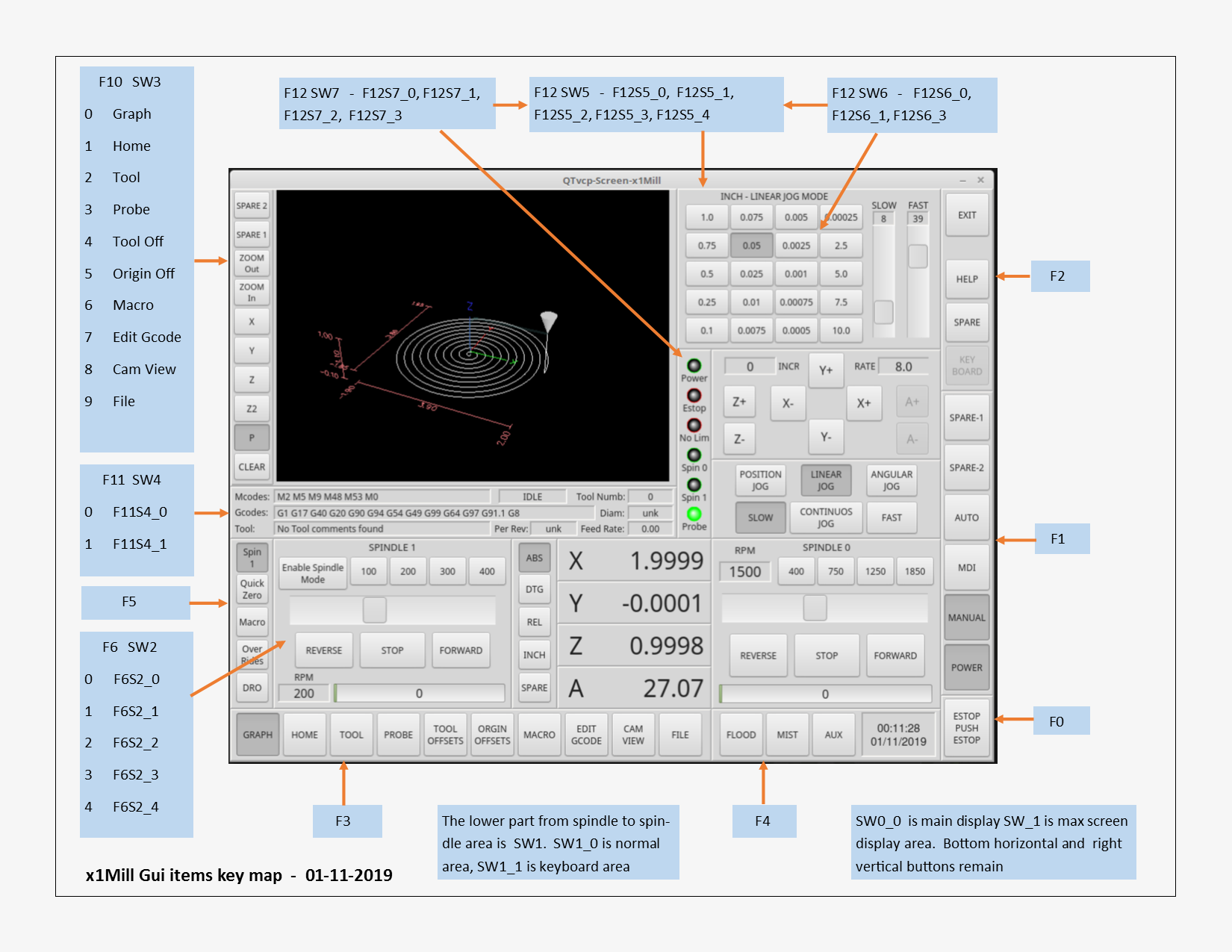

I will be placing the gui file and the handler that I have been working on on github some time this coming weekend. This will just be to allow everyone to look at those two items for information purposes. There is considerable more work to be done and it is a slow process.. I will post a link when that has been done.
In the gui names for every item has in its name a location key like f12s2_1 to reference it to a location in the gui. f12 would be a the location and the s2 indicates that it is stackedWidget 2, and then the following 1 is the stackedWidget index number. This became necessary since there are about 240 items to deal with right now.
I have attached a map that is meant to be a aid in location items in the gui's handler file. The key can be used to search of a specific group of items to quickly to get to the approximate location of the item to be looked at. The map i have attache is in .png and .pdf formats.
It should be remembered that I developed the code in the handler for use with my own machine to suit my own purposes and that it may not be suitable for other use at the present time. Quite a number of things like probing still need further work, as do the home and tool table pages, along with numerous other small less important items. It is just for status info only right now.
