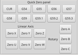

I don’t believe that I have a homing issue with my .ini file since it has worked fine for a number of years. I did see some coding in QTvcp that could perhaps may be limiting some things to 3 axis due to improper status information sharing. I do not have a lot of information yet on how or what GSTAT is sharing between modules.
I did decide to get rid of all the gui specific configuration items in the .ini file today and move them all to: x1Mill_pref.inc and run that as an extended .ini file using the #INCLUDE x1Mill_pref.inc command in the DISPLAY section. The # being required and shows as " /x1Mill/x1Mill.ini.expanded" in the terminal window on start up. This makes it a lot simpler to manage.
All the files including the .ini and .hal files are on my git hub account and anyone can pull them. If I had more time I would try to make a simulation for the gui. The files are updated every two days or so as I progress. They were updated today and the entry point is:
github.com/auto-mation-assist/x1Mill_bra...s/x1Mill_development
I would like to get the files auto functions to work better than they do now. This is perhaps due to some status conflicts between QTvcp it self and my functions that may need to be worked out. I’m working on that but some of the commands needed for some of the buttons below still need to be worked out.
I have also done some work on verser_probe configuration commands from the gui and those are working and are included in the x1Mill_pref.inc configuration file. I did notice that somehow some of the from panel items got skewed a bit and I fixed that. The fixed version is at:
github.com/auto-mation-assist/x1Mill_bra...dgets/versa_probe.ui
I wonder if the associated icon files should not be placed in the image folder for the widgets.
I have most of the quick zero panel working for clearing the G54-G59.1 offsets but still undecided on the commands to use for entering the work offsets to bring those to zero for the X to C axis. I don’t what to be setting the wrong gcode values.

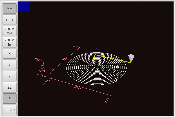

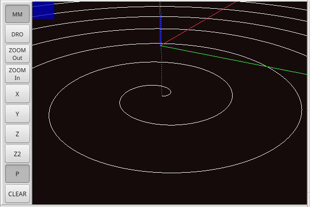

On the graphic area I have most of the available functions working but running into limitations of the present QTvcp version graphic display. The buttons that are working ok are, inch/mm, X,Y,Z,Z2 and P views and clear. The DRO function as Chris has mentioned is not available yet.
I enabled overlay and it just shows a blue box area on the top left of the display but it should likely be transparent. In looking at the code a bit I saw no functions to allow for text yet and wonder it that could just become a separate function in another widget.
Zoom in and out works fine with the mouse wheel. To get the zoom in and out buttons to function will likely need automatic pulses to be generated and routing these to where they will be useful. Grabbing the screen with the mouse pointer allows it to move and dragged. I have not tried to see if the grid function is working.
Normal display
Expanded view
Normal display
Expanded view

you can zoom in with:
self.w.GCODEDISPLAYWIDGETNAME.zoomin()
and zoomout with
self.w.GCODEDISPLAYWIDGETNAME.zoomout()
I should add them as actions to action buttons.
The overlay can be colored - usually you color it the same as the background.
Currently if you enble the DRO, it screws up the display and doesn't show the DRO. Since the DRO is displayed with openGL I don;t think one could add widgets there but could possible add user built openGL commands. There is some hooks in the code for showing user GL commands on the main screen (The idea was for showing chucks etc)
Chris M

Ok I have the zoom buttons working now. I was zoom_in and zoom_out. It was not happy about the dash before in and out. When I enabled the DRO before the display becomes jerky and it seems like something is spending a lot of time trying to get something that it cannot find which causes the graph to be updated at a jerky manner and slower rate like one time per second.
