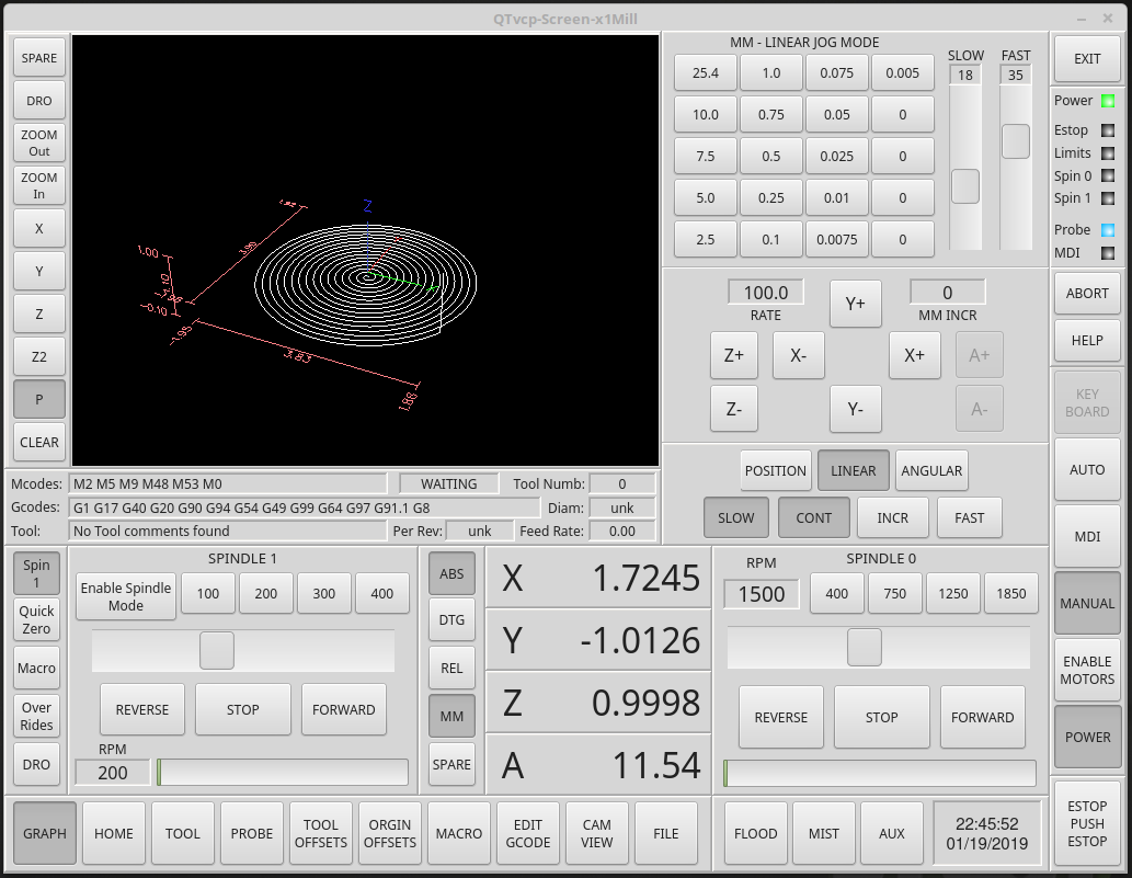

The picture below shows the new location of the alarm LED's. I hope to be able to improve on the appearance of the LED's later. it appears that the layers inside of them are not aligned up properly.
