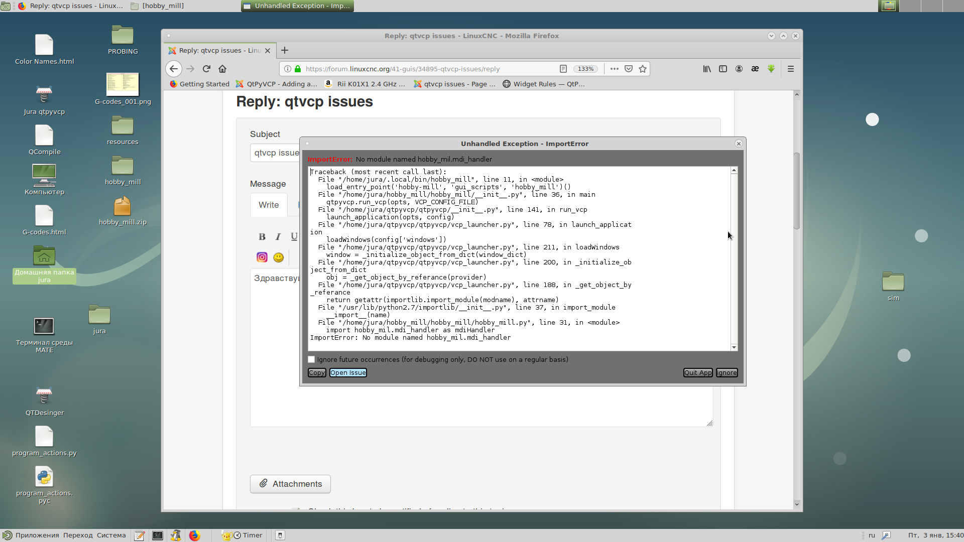

- hottabich
- Posts: 574
- Thank you received: 96
03 Jan 2020 08:03 #153890
by hottabich
Replied by hottabich on topic qtvcp issues
Hello! Happy New Year everyone! I decided to make Qtpyvcp interface for linuxcnc. Based on Brender + mill_touch_v6 + probe_basic. Neither can I fix one error. Please help someone who can and if it's not difficult. Files are attached. Thank you in advance.
Скачать
Скачать
