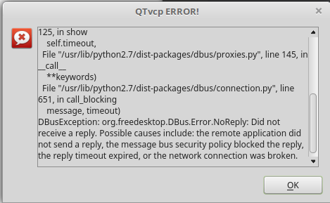

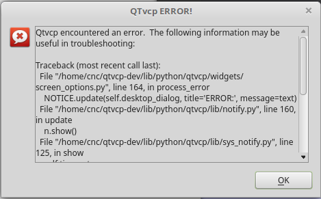

While testing some of my limits I ran the machine into Z into limits and then got flooded with perhaps many thousands of repetitive messages that slowed to computer down to where it became unresponsive and required a reboot. I was not able to get a snap shot of the user qtvcp massages about axis 2 being in limits that were all in 'black' but was able to take some screens shots about the problem it ran into that may be causing such a problem. I had to make the snap shot in two parts since the message I was able to copy is not expandable and wont allow text to be copied. I also attached the configuration file.
Last edit: 26 Jan 2019 14:42 by auto-mation-assist. Reason: Added missing file

I feel this is probably not the core problem - this is called everytime the notify messages are sent, so is more likely that something else blocked the required reply, but of course it is hard to say for sure.
One way to possibly prove this and maybe find another problem, I would suggest that you turn off the notify option in the screenoption widget, at least temporarily.
Then see if you can force the problem again.
I was thinking more on the continuous error message problem, and am now thinking I could have it count the number and if it gets say 5 messages it shuts down

I pushed work to limit the error dialog to 5 errors.
After that it shuts down and prints the error to the terminal.
Hopefully this is more helpful
