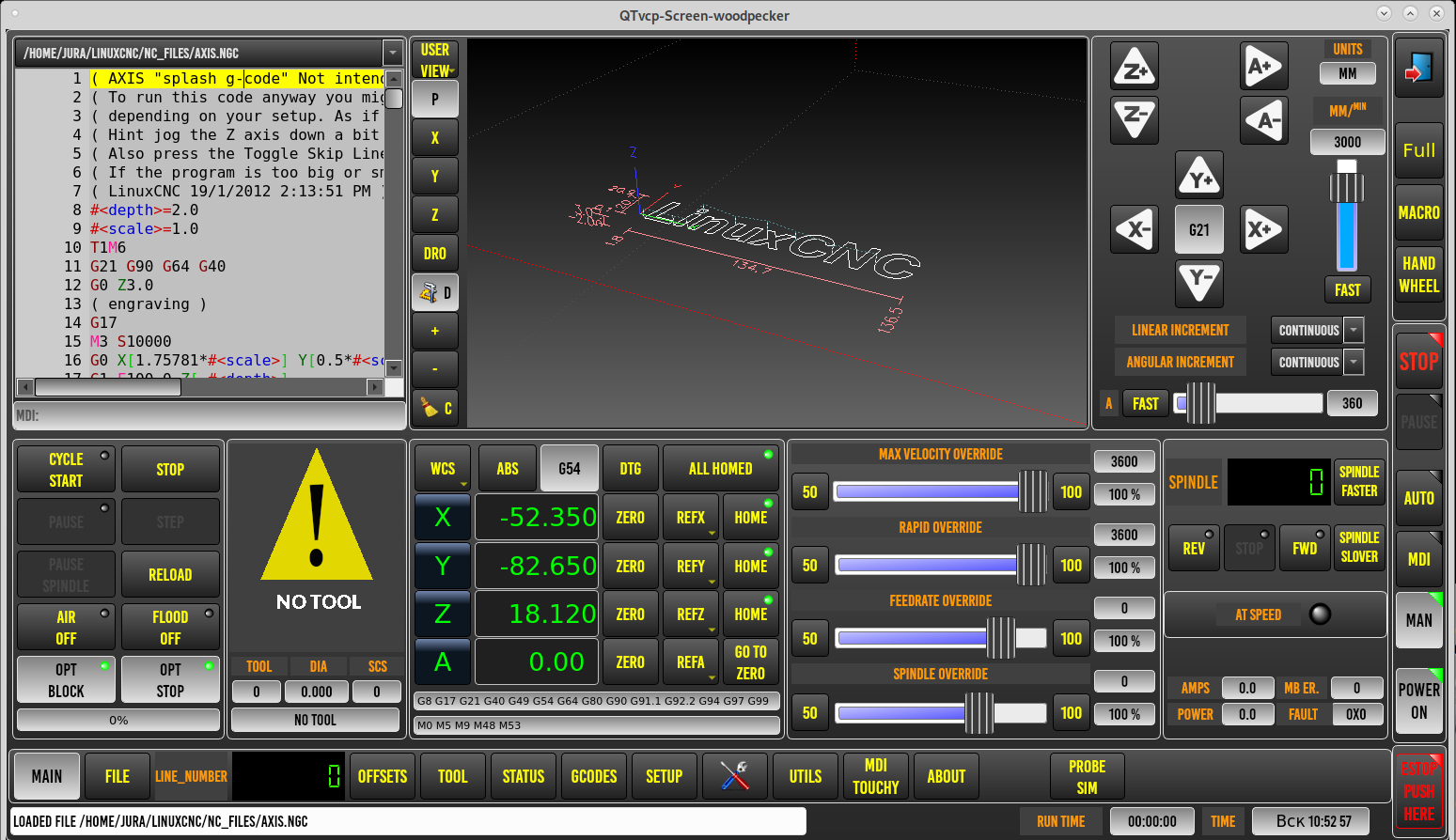

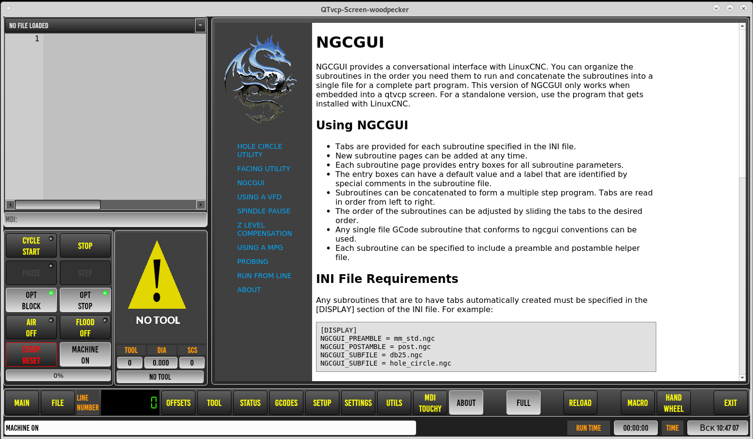

28 Aug 2022 05:58 - 28 Aug 2022 07:24 #250604
by hottabich
Replied by hottabich on topic Sample Qtvcp Screens

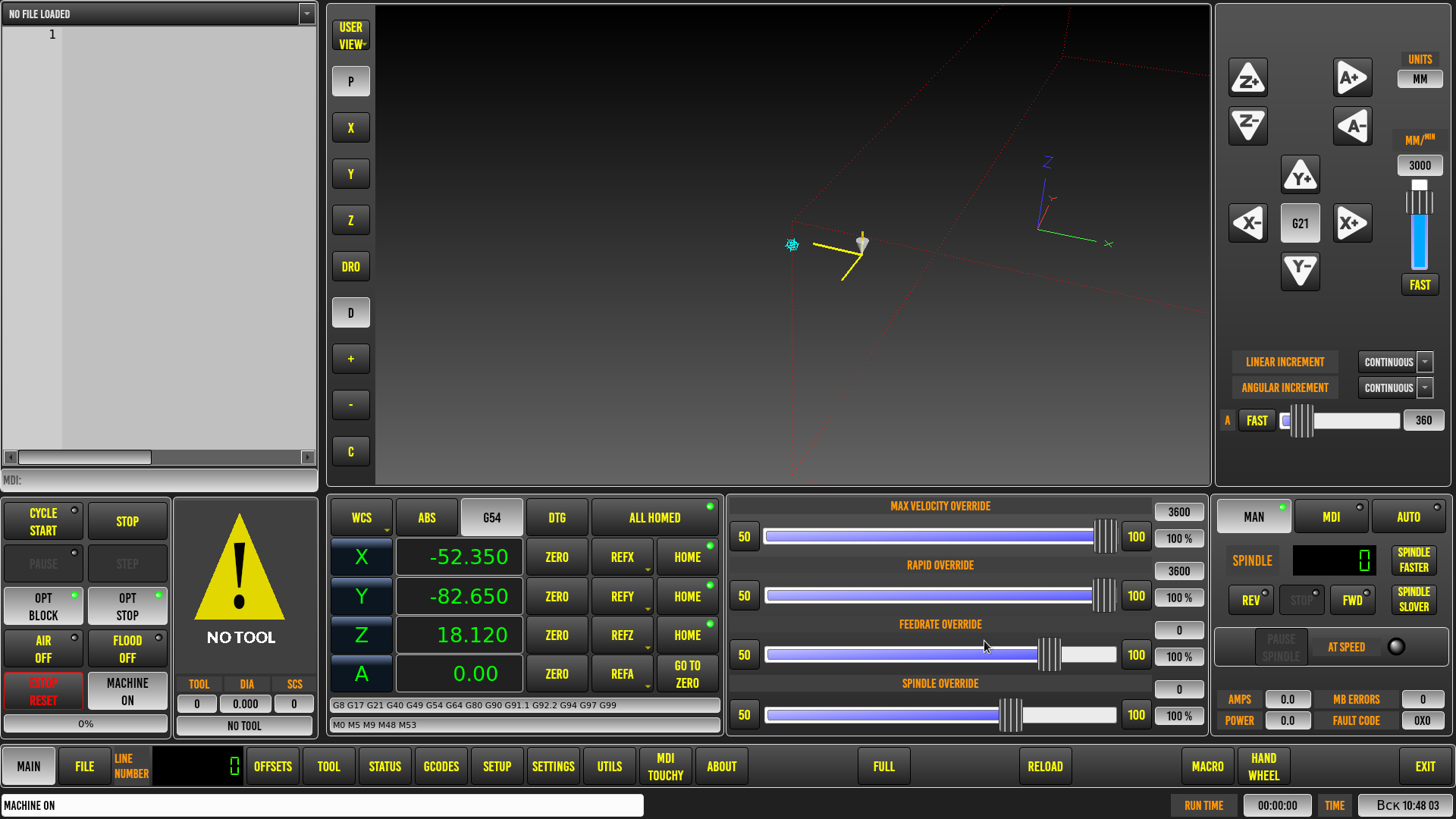

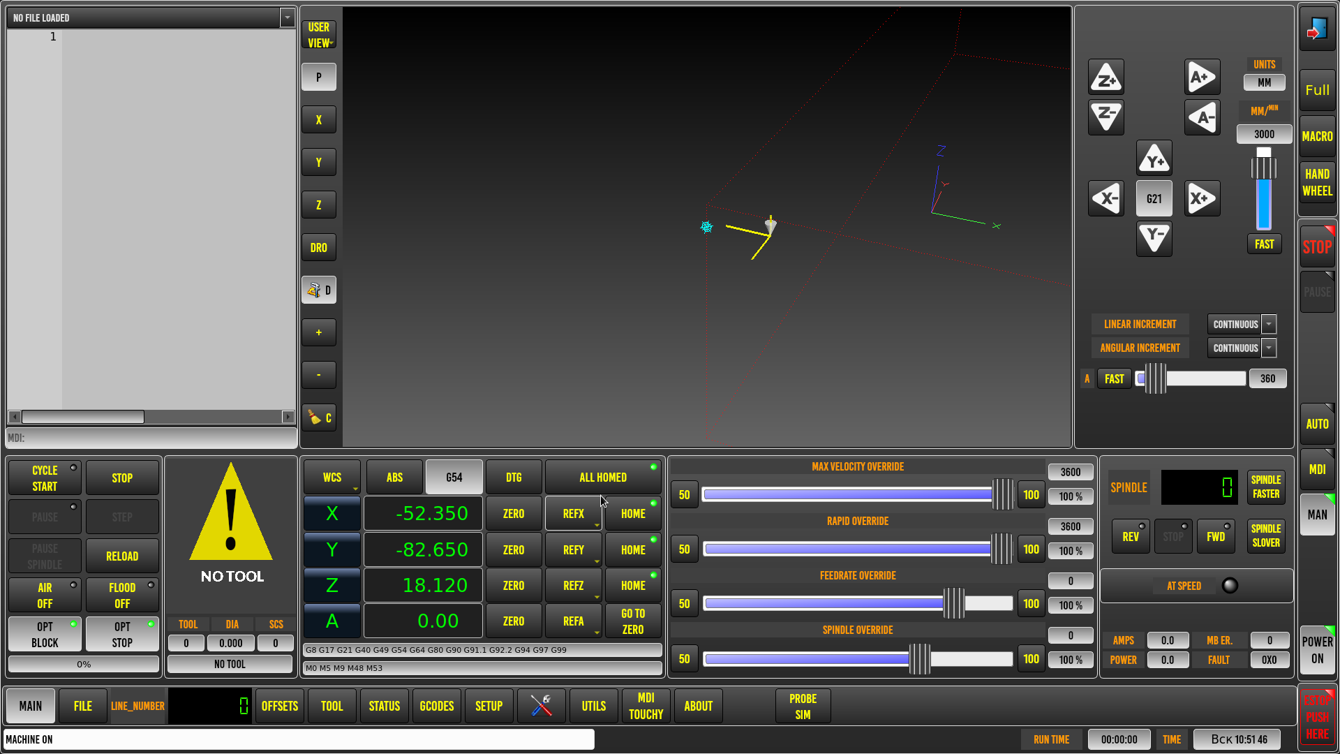

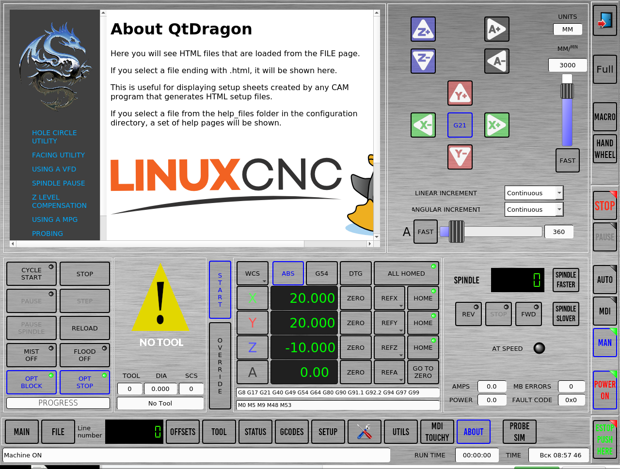

Thank you! I have added an about page and if it is possible to add the previous interface (1536 x864) to the same woodpecker folder then I will rename them too.

28 Aug 2022 07:59 #250607
by hottabich
Here's what I did just in case.

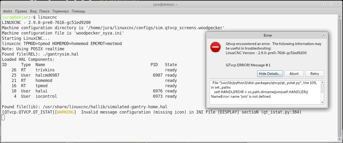

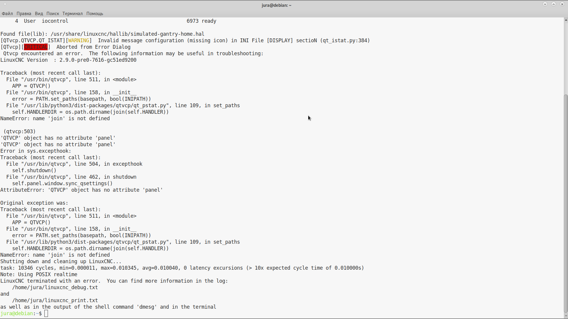

29 Aug 2022 11:54 - 30 Aug 2022 17:13 #250682
by hottabich
After the update, qtdragon and woodpecker do not start. Everything worked with the attached files before the update.
Last edit: 30 Aug 2022 17:13 by hottabich.

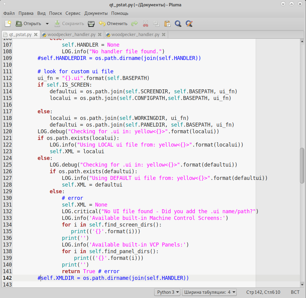

- MarkoPolo
- Posts: 319
- Thank you received: 90
29 Aug 2022 16:54 #250699
by MarkoPolo
Replied by MarkoPolo on topic Sample Qtvcp Screens
I confirm. In qt_pstat.py on lines 109 and 142, I changed to:
self.HANDLERDIR = os.path.join(self.HANDLER)
self.XMLDIR = os.path.join(self.HANDLER)
it works anyway.
Maybe bad syntax or some other problem
it works anyway.
The following user(s) said Thank You: cmorley

29 Aug 2022 17:25 #250704
Replied by cmorley on topic Sample Qtvcp Screens
Yes join should not be there! Thanks for looking.

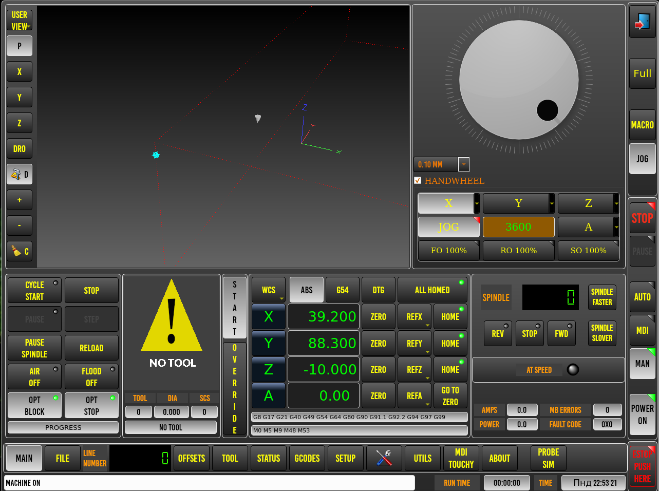

- Posts: 7368
- Thank you received: 2181
30 Aug 2022 03:12 #250750
I fixed the error and woodpecker loads for me. though it looks like the X axis buttons are missing images.
