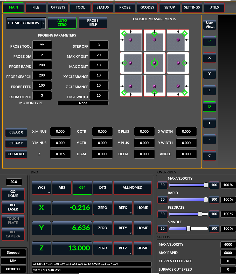

05 May 2023 18:21 #270759
Replied by rodw on topic qtdragon - probing issues
Ok Versby seems unchanged from prior behaviour
Basic Probe incorrectly finishes at z clearance + extra depth
See attached image Z is at 13mm when it should (and was previously) be 10mm
You need the extra depth becasue if you probe to surface and finishes at Z10
on an XY corner probe the probe only decend to the surface height before probing for the material. Adding extra depth ensures the probe contacts the edge instead of potentially skimming over the top.
Because each probe routine is a python procedure, It might be possible to add a checkbox to basic probe "Probe to height first"
If set, a corner or edge probe could probe for the height before probing for X & Y.
That would let you zero the machine in one step (and is consistent with a normal workflow)
That would be cool!
That would be cool!
- Posts: 7368
- Thank you received: 2181
05 May 2023 18:55 #270761
Replied by cmorley on topic qtdragon - probing issues
So the only change I did was separate xy and z max probe distance. You can have them at different lengths.
This doesn't have anything to do with finish position.
Can you confirm that max Z is being honoured now
finish depth:
I see in the code, extra depth is always added to clearance, but when down probing I think it shouldn't. extra depth does make sense when down probing.
extra depth is to get below chamfers etc when side probing.
Does that sound right?
finish depth:
