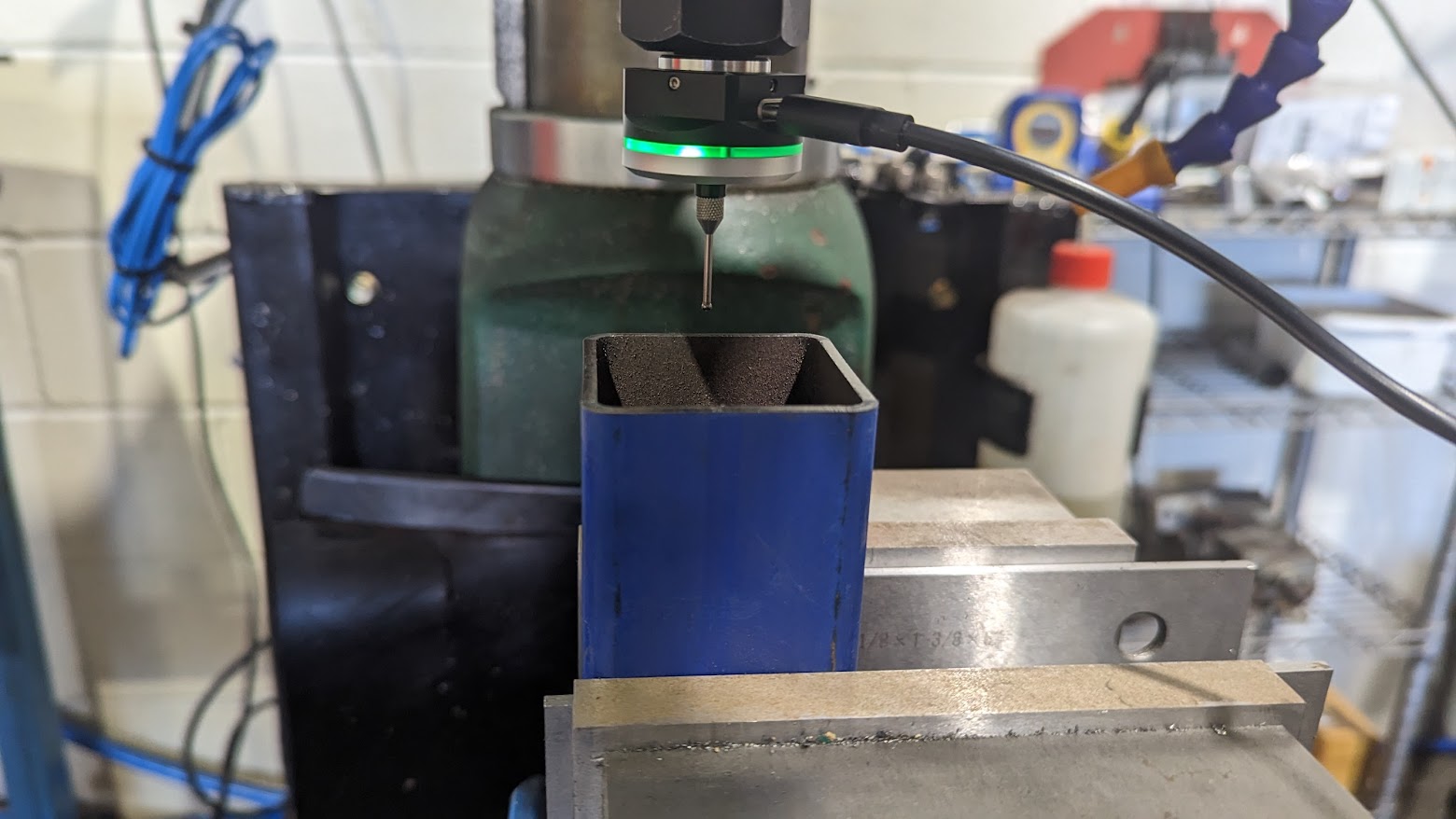

09 May 2023 05:32 #270985
Replied by rodw on topic qtdragon - probing issues
Ok, definitely on the right branch now but before any of the changes you just mentioned.
Used a piece of 50mm square section which lets me do inside, outside, ridges and valleys
Tested Basic Probe only
Outside corners all OK
Inside probe in general.
The probe lowers into pocket, commences movement in the oposite direction to the first probe before starting to probe. Makes no sense. Should just lower and stat moving the right way
Inside corners, inside pockets, ridges and valleys.
When contact is made the second and final time, the probe goes the wrong way (eg toward what it just probed and hits the side again in a non-probe (is this related to the commencement bug above?
Have a look at those and I will retest it all tomorrow.
