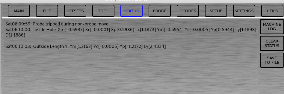

found another problem, i think. in Versa Probe option.
seems the Outside probing of a boss (the center option on the Outside probing type page) does not report the results correctly.
See the image.
the Inside probing does report results correctly. see the image.
I was probing the inside and outside diameters of a bearing. first the inside, then the outside.
I looked around the best I could to find the problem, but can't tell exactly where or what it is.
I check in probe_routines.py. probe_subprog.py, and versa_probe.py. and looked through probe ngc files......
please check it out and fix if possible.
also, what is the functional order of the code? like when one clicks on a probe type routine, what is actually going on in the program?
See the image.

Replied by cmorley on topic qtdragon - probing issues
ui button sends probe function name to versa_probe.py
versa_probe sends function name/data to probe_subprogram (running as a sub process)
probe_subprogram imports probe_routines so really both files are one program.
versa 'inside hole button' calls 'probe_xy_hole' in probe_routine
probe_xy_hole does all the probe moves and calculates diameter
versa 'outside hole button' calls 'probe_outside_xy_center'
probe_outside_xy_center doesn't calculate anything it calls other separate function.

so, can the poor, incorrect reporting for the Outside pocket be fixed?
it's not 'Outside Length', it's an Outside boss.....
please?
thanks for the program functioning path....
please?

If a boss, why is it reporting an inside hole?
I really have not had any luck with small holes (eg 10mm). There are non-probe moves happening after the probe enters the hole that cause an error. Really there should be no non probe moves inside a hole.
I wonder if the boss shouldn't be using top, bottom, left and right side probing?
Replied by rodw on topic qtdragon - probing issues
Was that image probing for a boss or a pocket/please check it out and fix if possible.
I pushed a hopeful fix to the feature branch above if you can test...
The following user(s) said Thank You: Roguish
