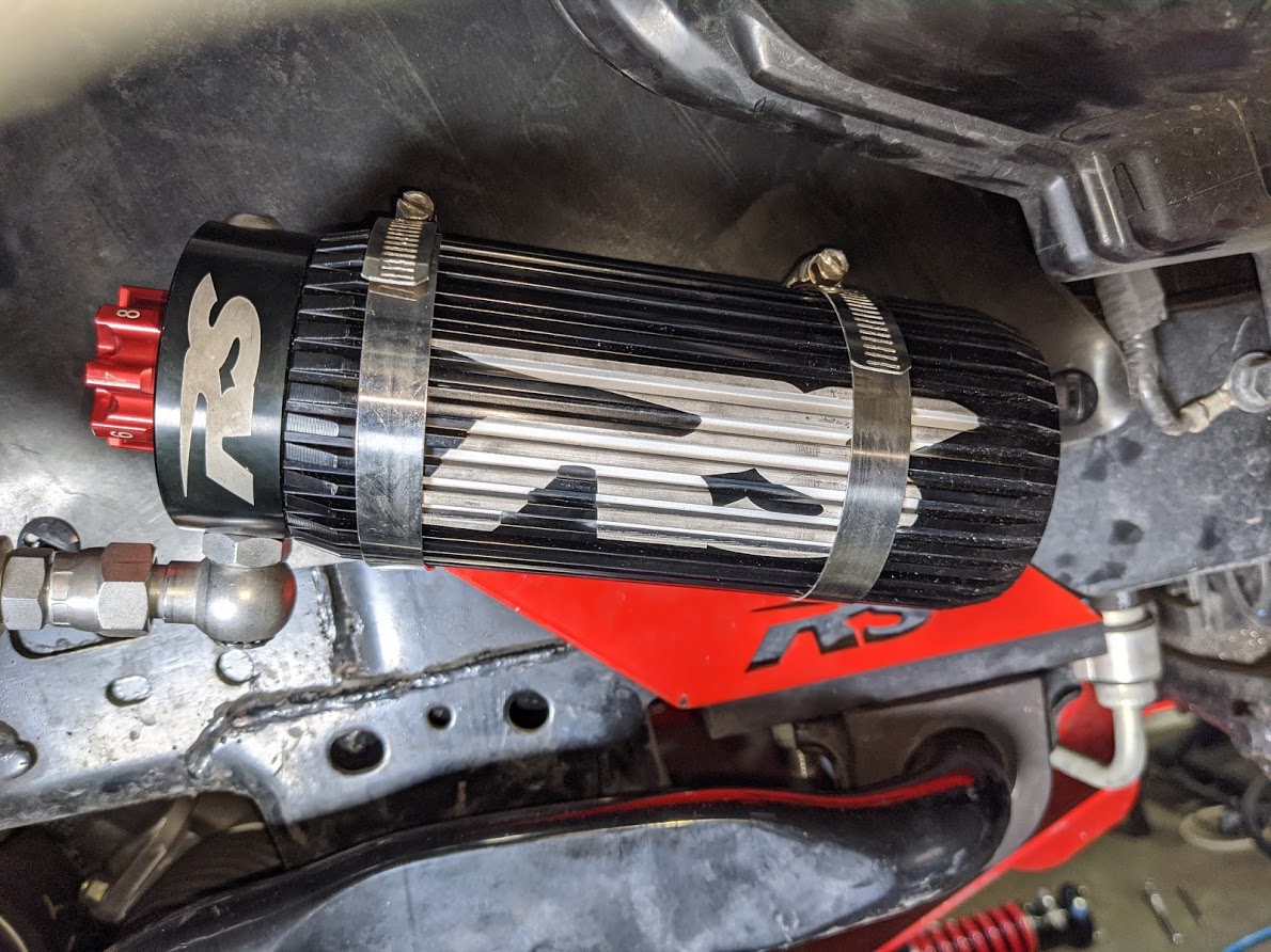

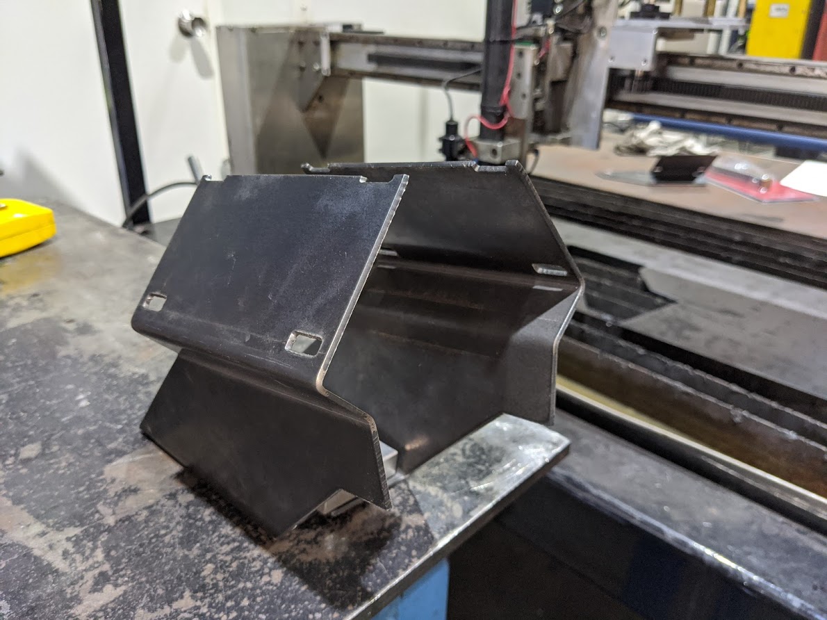

Well, finally did a real fold on my new press brake and as an added bonus, we had to design a part and plasma cut it
The things we do for our customers to deliver a quality product.. These are mounts for shock absorber remote reservoirs (cans).
We did not really like the manufacturer's mounts on our Hilux (think Tacoma if you are in the US). We were worried that they would be hit by the tyre on full lock.
So our revised mount moves the can higher and allows it to be mounted partly above the chassis rail by using an angled mount. We could not go too far over as there were other components in the road so it kinda did my head in when Dean told me where the can had to sit when I was designing the part.
If you look closely, you can see oscillations in the cuts near the corners and also inside the square slots. This is due to the massive increase in acceleration we have achieved (now 0.5 G) with our recent motor upgrade. Now we have a press brake, that opens up some new ways to stiffen up the gantry ends so watch this space!

Yes we can, but we pretend we do not !If you look closely, you can see oscillations in the cuts near the corners and also inside the square slots.

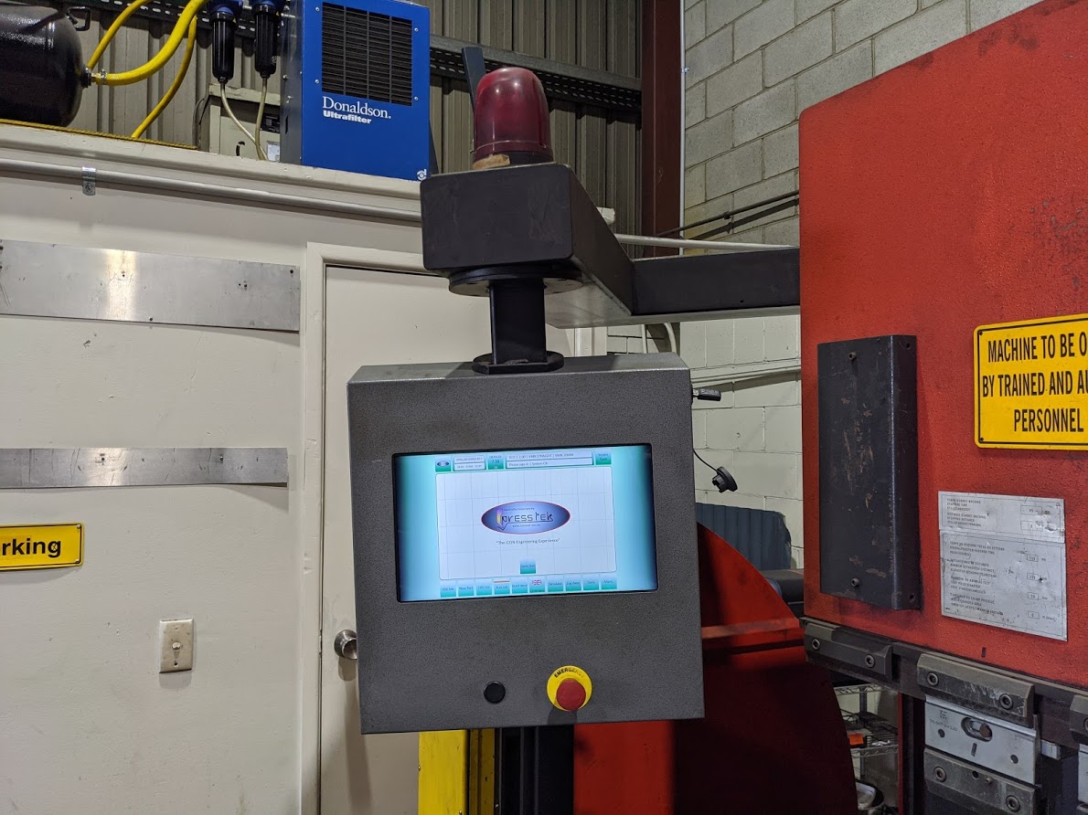

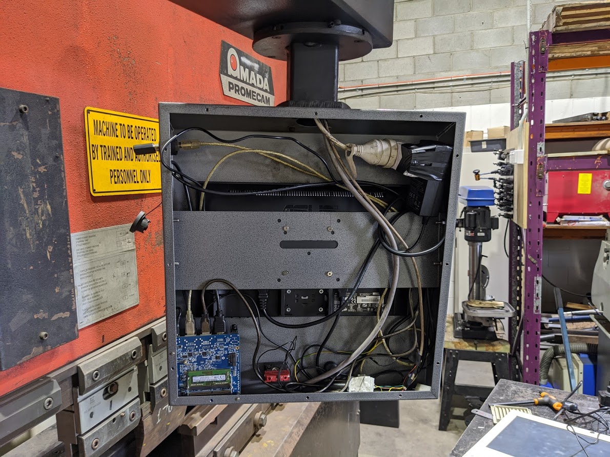

Its been a long week. After folding those parts on Friday, because you guys were complaining about fingerprints on the old screen, on Saturday, I decided to upgrade the console using a neat little 15" touch screen monitor (Asus VT168H) and an Odroid H2+ (Please don't ask me which OS I installed).
But I had a wiring issue on the serial cable from the PC to the Ikon controller. I figured it would not be hard to fix and the day was done so I decided to come back the next day and switched the PC off. It immediately tried to do a firmware upgrade over the serial link. Then the LED on the controller was flashing madly so somehow it managed to talk to the controller and stuff it totally. Come Monday morning it was still stuck on the same screen so I called the technician and he came around at 7:00am this morning and soon sorted it out. What awesome service!
So i'm actually impressed with how they mounted the monitor and hid all the messy cables in a cabinet, I'm going to copy their idea eventually as I have been planning on doing something like this for a long time....
I've ordered a SMC bulkhead cable so once it turns up, I'm going to mount the wifi antenna on the top of the case instead of hidden in behind the monitor mount.

Shhh! And to think that I blew Linuxcnc off the Odroid and paid $100 for a Win10 license.
I have to say though that the Presstek Ikon control is very nice to use. Plus it totally hides the OS from view!
Replied by rodw on topic Rods "Spaceship" Scratch built Plasma Cutter build
Nice !
I feel a draft going on, is there a window(s) open somewhere ?
