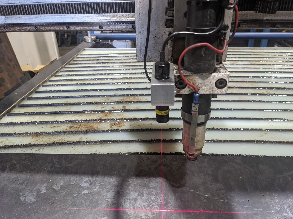

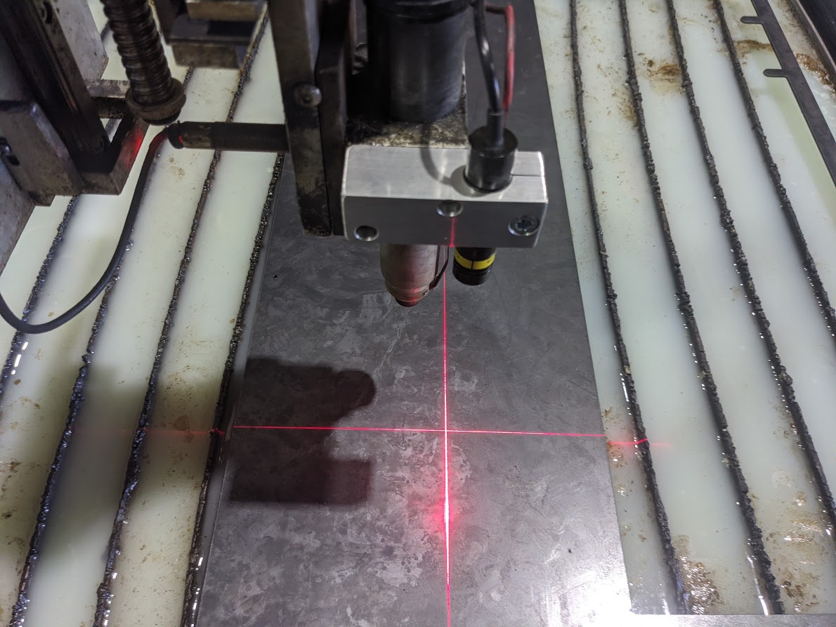

My laser pointer died. I think it was becasue it fell off with the torch and pulled the wires out of the back. This time I used a different one with a 16mm barrel
I made a new bracket for the laser and clamped it in after slitting the part and adding a clamping bolt.

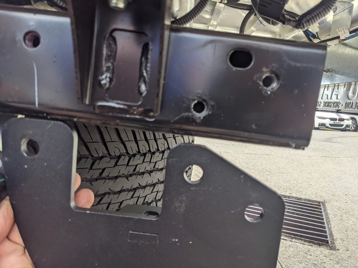

During the week, We sold a towbar for the new Isuzu Dmax which was the first available for the latest model. We would have sold the first one off the production line from this particular company.
They had drawn the part incorrectly. Luckily our customer took it in his stride and just drilled a couple of holes through the chassis!
Man, I nearly did it myself on this part as I had based my drawing on an earlier part with the bolt holes in position but I drew it up on the wrong side of the part. Lucky I saw it in time!
Just goes to show how easy it is to stuff something up even with 3D cad design.

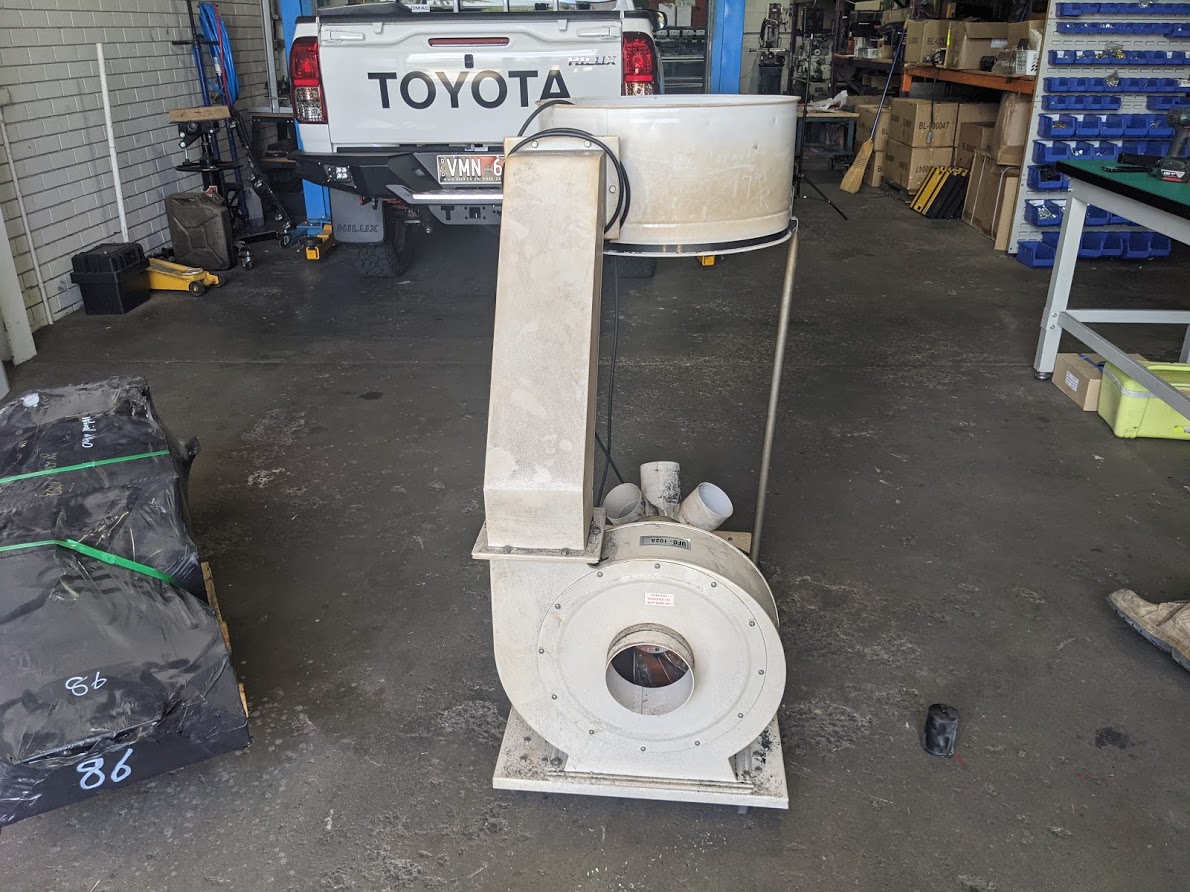

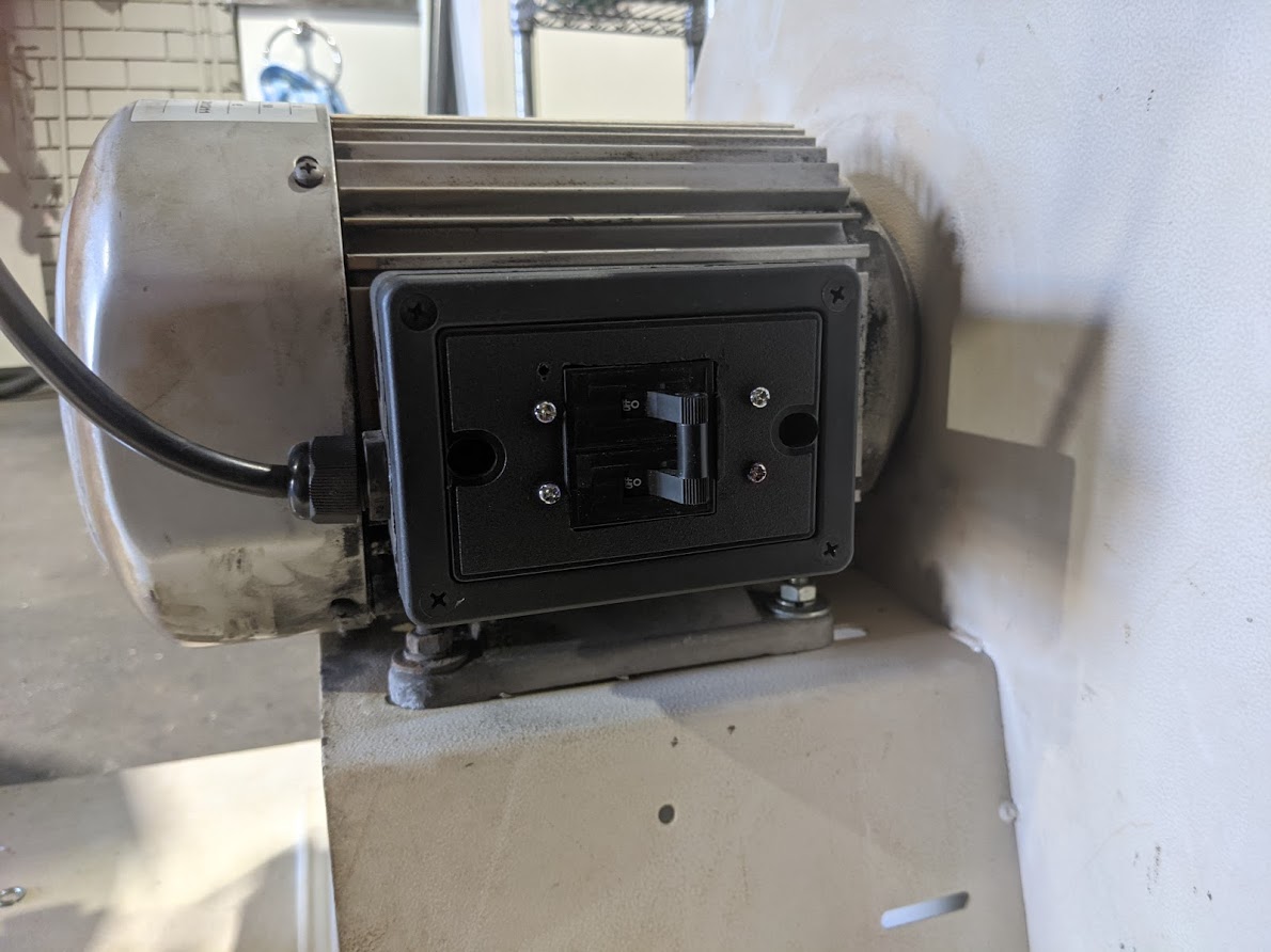

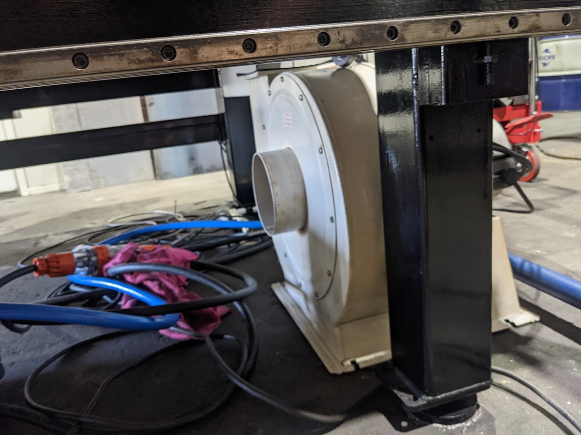

Well, it looks like the spaceship is getting a downdraft table. I always wanted to go that way. I scored a free multicam router dust extraction fan which supposedly had a burnt out motor at the business next door.
But 15 minutes after we got it the 10 metres home back into our workshop, we diagnosed the fault as being a burnt out switch! Sure enough when we bypassed it,it sprang to life. I had a big heavy duty switch at home which we managed to install into the existing switch housing so we have a permanent repair!
This is a metal fan with a 3 hp 15 amp single phase motor with about 2000 CFM and a 6" inlet
It also has a 3 way 4" inlet splitter but I don't think we will use it.

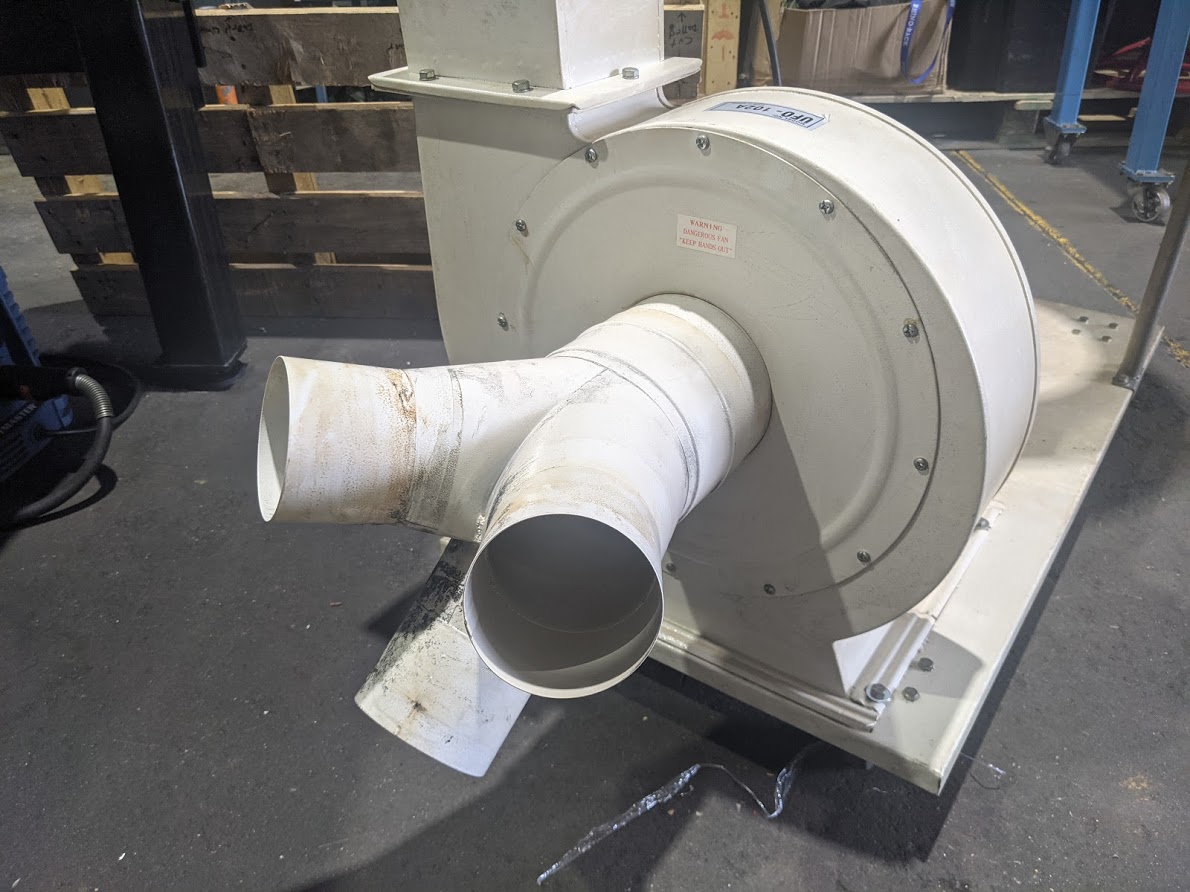

Today I thought I better get it over near the plasma and see how it might go together.
This might actually fit in OK. There is just enough room to get the outlet out from under the table but I have no clue what to do then!

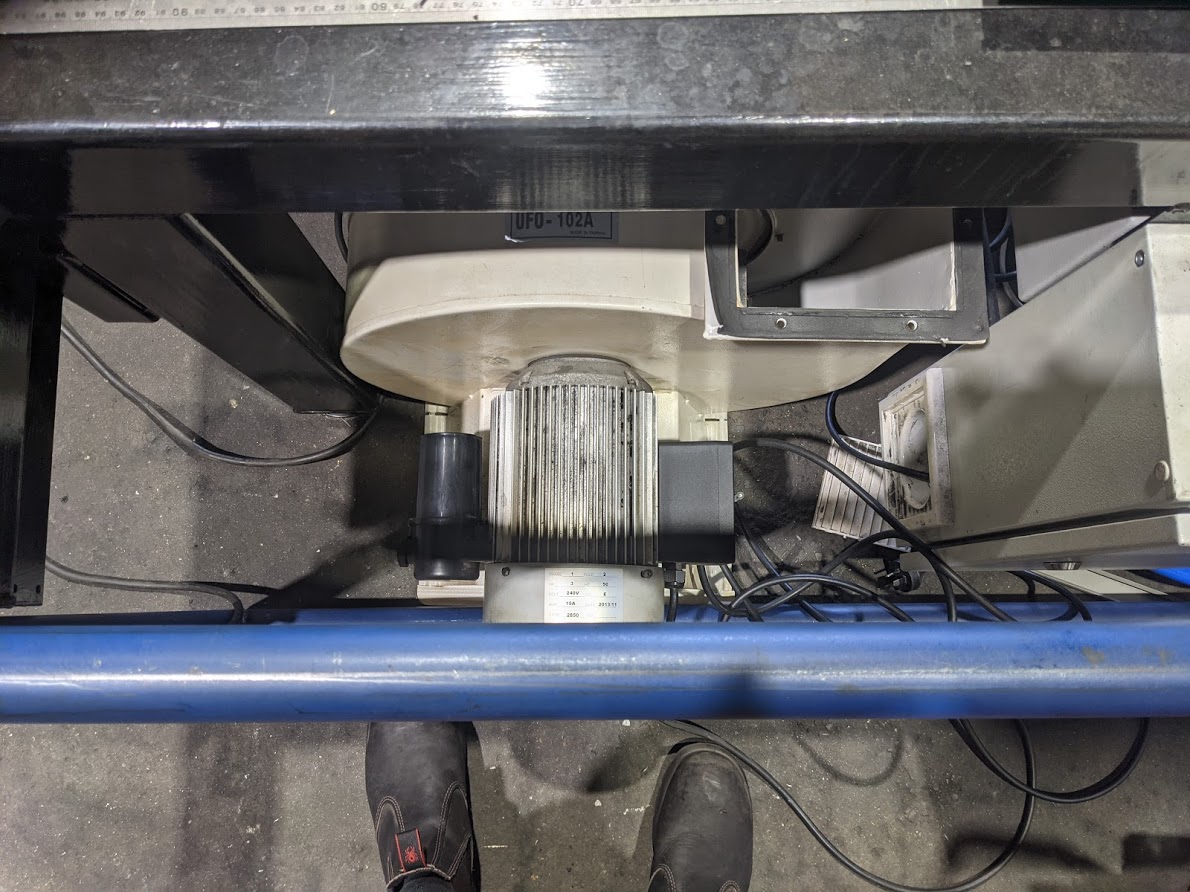

So under the table it looks like this
I think if I make up a manifold out of some 6" tube that includes a T piece part way along and terminated by an elbow, I should be able to make a zoned downdraft table and keep all of the mechanisms outside of the dirty area.
I need to do a bit of thinking about this...

If you turn 90 degree along the motor axle and mount from the side the outlet will have enough room for the exhaust
- Posts: 12156
- Thank you received: 4149
30 Nov 2020 12:15 - 30 Nov 2020 12:43 #190665
Yeh I've thought about that which is why I put it down beside the plasma cutter so I can see different ways to do it. There is a bit to consider to keep the duct work easy to fabricate.
As an aside and its not a very good photo but this pic shows a 30mm square piece of 2mm steel held hard against the table frame by air pressure. Its 160mm above the outlet so the fan shifts some air!
Replied by rodw on topic Rods "Spaceship" Scratch built Plasma Cutter build

Looking on the picture with text "This might... ". Turn 90 degree conter clockwise. You have posibilities enough to go either straight to the left or via 90 tubes along table etc..
