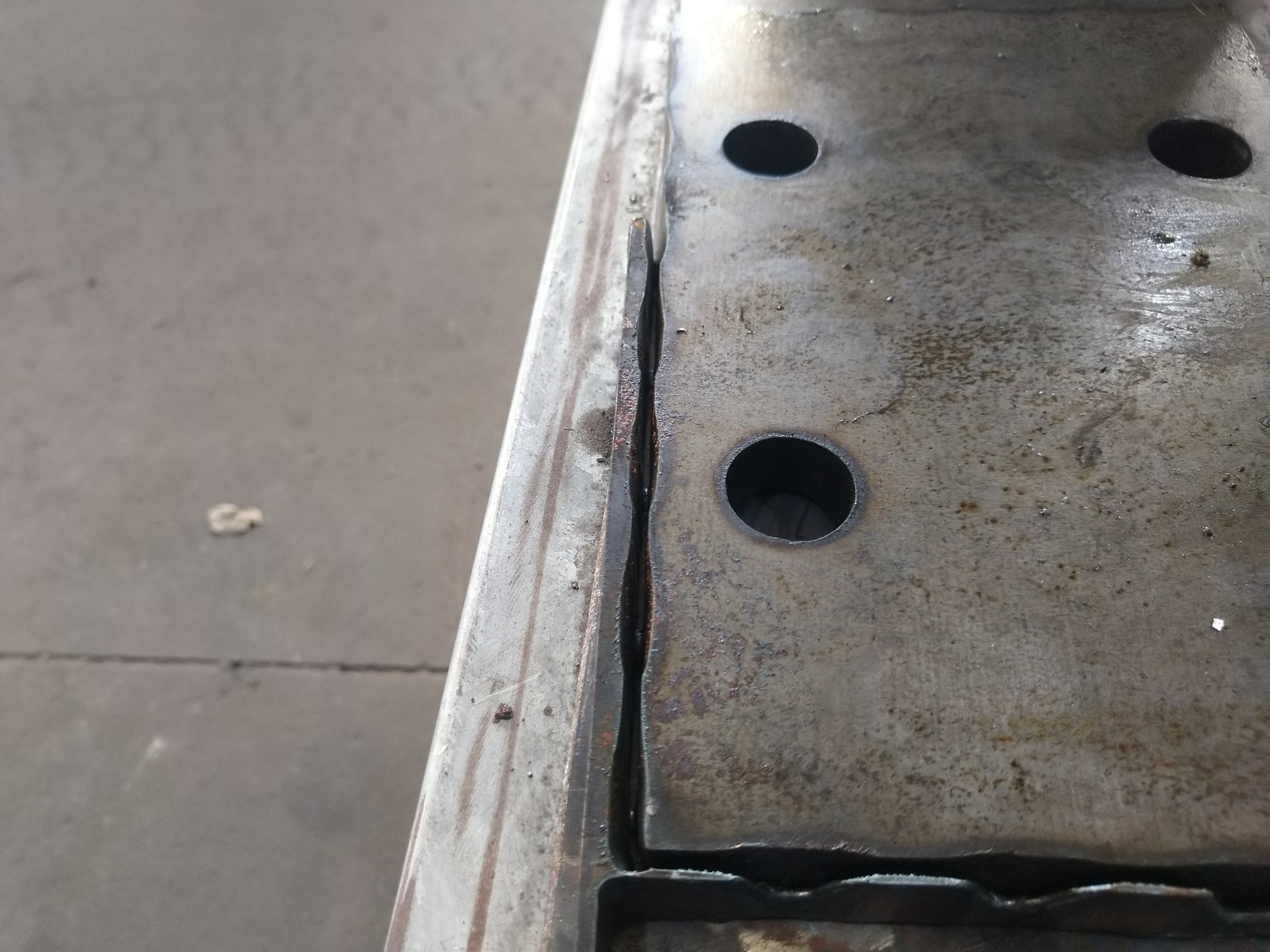

17 Dec 2020 09:36 #192234
Replied by rodw on topic Rods "Spaceship" Scratch built Plasma Cutter build
Well today, I had a chance to look at the thcad wiring while Dean took my ute (pickup truck for our US friends) to grab a couple of sheets of material. I wanted to add bootlace ferrules where I was not using them The ground wire on the encoder side had a soldered end and it seemed to be a bit loose so I added a ferrule and tightened it up. So to test it out, we set up to cut down two 1200x2400 sheets of parts and the THCAD did not miss a beat
BUT
We changed out the consumables before we started, electrode, nozzle and shield and we had terrible cut quality. We managed to get a result with a 80% feed override but it was still pretty awful. so we grabbed some scrap and played around for a while and still were not happy. I dug out a little part I cut earlier in the week and it looked like it should be.
So after a bit of a think, I realised that every cut quality issue I had experienced were due to torch related issues. So I swapped out the Thermal Dynamics start cartridge and quality improved, Spurred on by this we also replaced the shield cup which looked a bit tired and quality improved again. So then we cut non stop for a few hours with perfect quality and no faults.
So I guess I can't complain as I got 2 years out of those parts.
So then we ended up with 20 flanges to fold up with 6 folds each. I have to say I just can't believe how quick my Amada NC press brake is at stuff like this. Found the drawing and retrieved the program we had done last time, swapped out the tooling and smashed through it in no time!
By the end of the day despite some setbacks, we had a stack of parts I used to pay about $1k for cut, folded and welded. It cost $150 in material and a bit of time. Tomorrow they can go off for powdercoating.
BUT

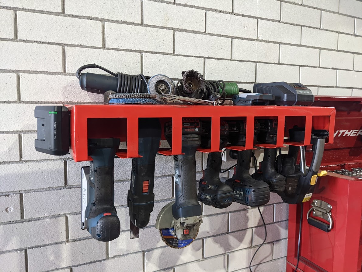

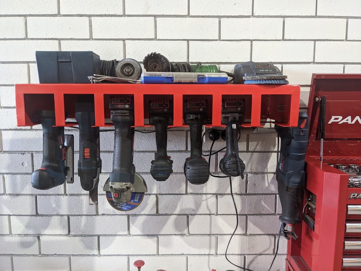

This idea had been in my mind for a couple of years and this last two days, we finally cut and folded it!

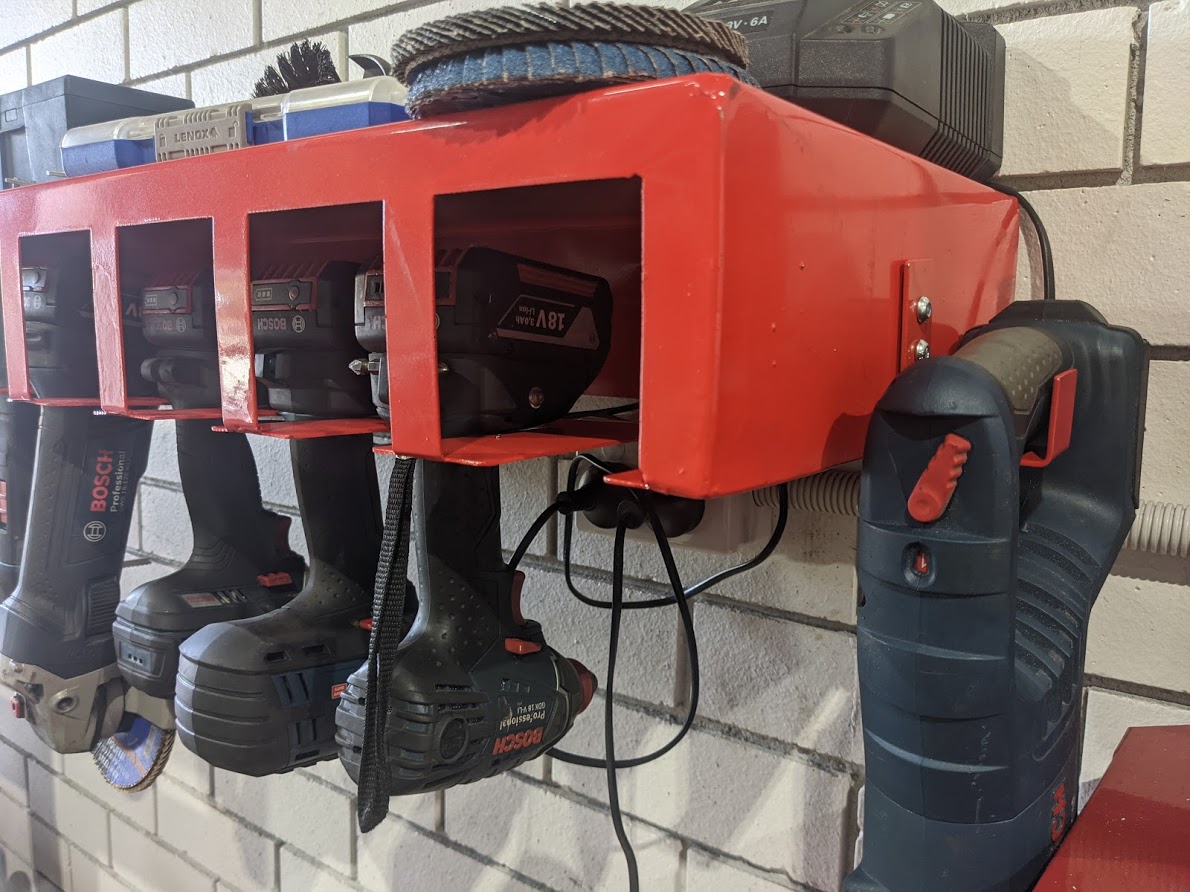

This is designed for Bosch cordless tools, complete with a rattle gun paint job. Not sure how it will go with other brands of tools. Some tools need a wider slot than others if you look closely.
I have two battery chargers and one of them had screw mounting slots so we mounted that to one end using M5 nutserts. The other one will have to sit on top.
Then I thought If made sense to hang the demolition saw from the other side so its with its mate and the chargers.
I have to say if you have some spare room on a sheet, its worth cutting some random strips to have on hand for hooks and things!

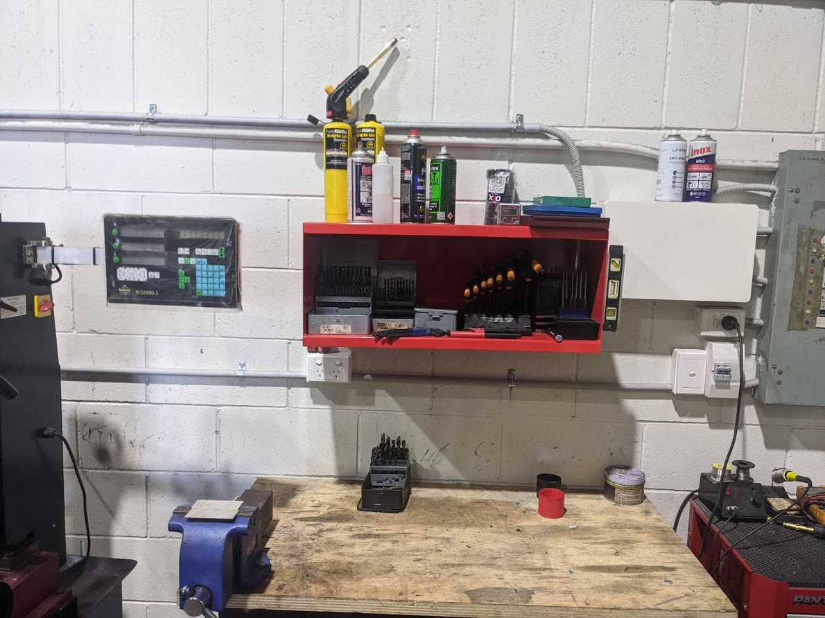

While we were at it, we made a similar storage shelf over our little work bench.
The DRO belongs to my Seig SX3 (Super X3) manual Mill I think Grizzly also sell a green version!
This was actually a bonus becasue my original plan was to have the tools hanging here, but we had added a power point in a handier place so the tools went there and I still did not have any storage at the work bench. We had to design this one around the size of our plasma table. But it was the simplest part to make in F360. Draw a rectangle, convert to sheet metal, select 4 edges, add a folded flange the depth of your shelves and then add flanges to the top and bottom to stiffen it up.
So its a good trial run with a bit more folding. The box is really a bit too deep for our press brake but we got there in the end. (eg. Don't look too close!)
I've attached a zip file containing the tool shelf DXF if you want to have a go at it. Fold the ends in last. Ignore the mounting holes and drill your own. (hint, you can move them to another layer in Sheetcam and not cut them). We used four M8 x 40mm ramset fasteners.The fold at the bottom edge of the hangers would not have been possible on the brake so we cut some slots and folded it by hand and welded it up. That worked very well!
You have no idea how much bench space the tool shelf freed up and the other shelf gave us our work bench back. It just goes to show that an organised workshop requires good storage!

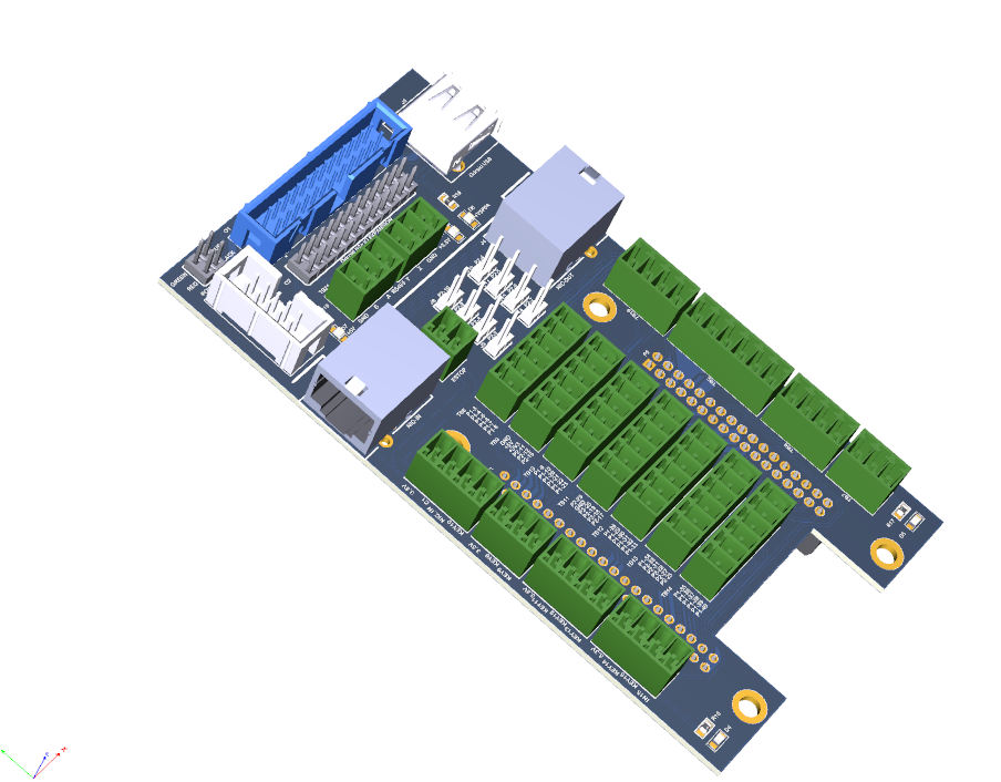

So I have a sheet of 1.6mm steel sitting on the table now so I think the next job will be my long standing HMI box that according to Tommy, will turn a cheap arse touch screen into a heavy duty industrial version! (On steroids in true Spaceship style!)
Here is a taste of whats coming... A shield to plug into a 7i73 and Odroid H2+
