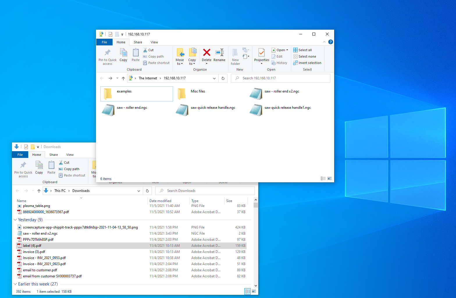

Its been a while since I posted here. But I finally think I have QTplasmac working perfectly for me after Phill updated a new feature this morning.
I did a video of a walkaround and tour of QTplasmac to celebrate so here it is.
I'm really pleased that the instability from the conversion to Python 3 has subsided now and A couple of bugfixes in QTvcp and Phill's implementation of the load last file following a suggestion I made earlier in the week have made it much easier to use.
I'd love to see a button for clear file that does the same thing as new in conversational does.
Thats another thing that just been fixed. The ability to go back to the main tab from conversational without doing some backflips !
Phil and Greg are very responsive with bug fixes and even new features
Also a button to archive the current file and move it to another folder would be nice.
I also had a win yesterday and finally was able to get SAMBA working so I can access my home directory from Windows in the air conditioned office.
I think the key is to enable SMB 1.0/CIFS under Windows features. Everything about Windows you read says to disable it!
