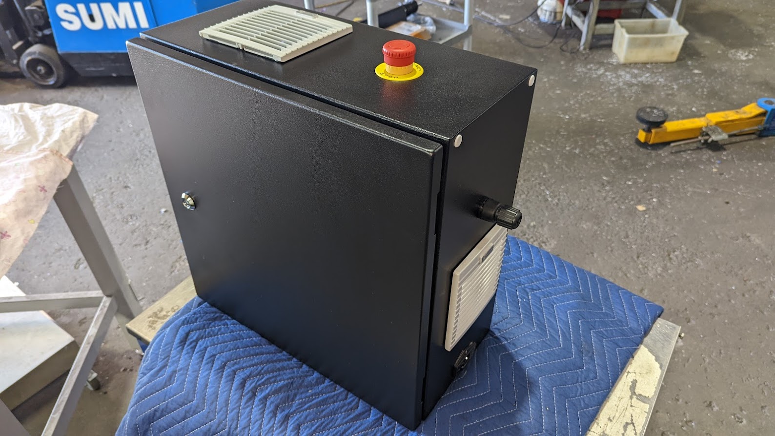

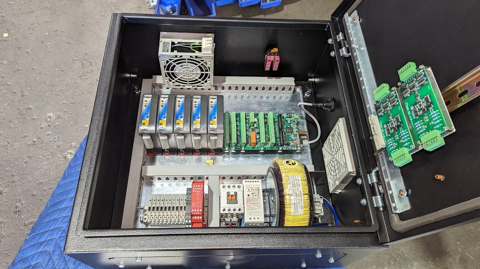

This might become Spaceship Mk II but I've got a near new 3 phase Hypertherm 45 XP here that we purchased cheap for a customer who wanted me to build a controller for him.
It only has a hand torch so that will be interesting.
I was able to get the CPC port kit and cable but the RS485 is on backorder...
I've got most of the hardware installed now so the wiring begins.
Its the identical 500 x 500 mm enclosure I used for the original spaceship but man its tight to get everything in.
So we have:
The obligatory Mains filter built in the IEC connector
An Idec safety relay triggering a breaker for estop
A 60 volt custom made AC toroid
Meanwell HDR-15-24 for ohmic sensing
plasma cut and folded a mounting bracket for the toroid to save space.
Meanwell MDR-40 for Field power (I ordered a 12 volt one so a replacement 24V one is coming grrr)
5 x Lam Technologies DS1076A stepper drivers for gantry machine and rotary axis. These accept AC power for a clean install
A heap of fuse holders as per Lam's recommendations
Mesa 7i76e with IP67 bulkhead ethernet connector
Mesa THCAD-10 for voltage reading
Mesa THCAD-5 for ohmic sensing (using my special magic)
Supply chain constraints meant the only enclosure in stock was black but its growing on me.
Lam recommended a fan located directly above the drives. I put the estop beside it.
I think I will make the operator stand in front of the enclosure and then add some run/stop and pause/resum buttons on the top too.
Still to fit is the 433 Mhz pendant control I have here. I ran out of din rail terminals so probably need to get a few more.
All in all, it should be a nice clean build
Tell me what you think so far.

That control cabinet looks clean. It seems the supply/shortage is effecting everybody everywhere . I know a certain
chip were I work cost us 15$ just a few years ago now cost 45$ and if we want them it's $7000 minimum buy. YIKES !

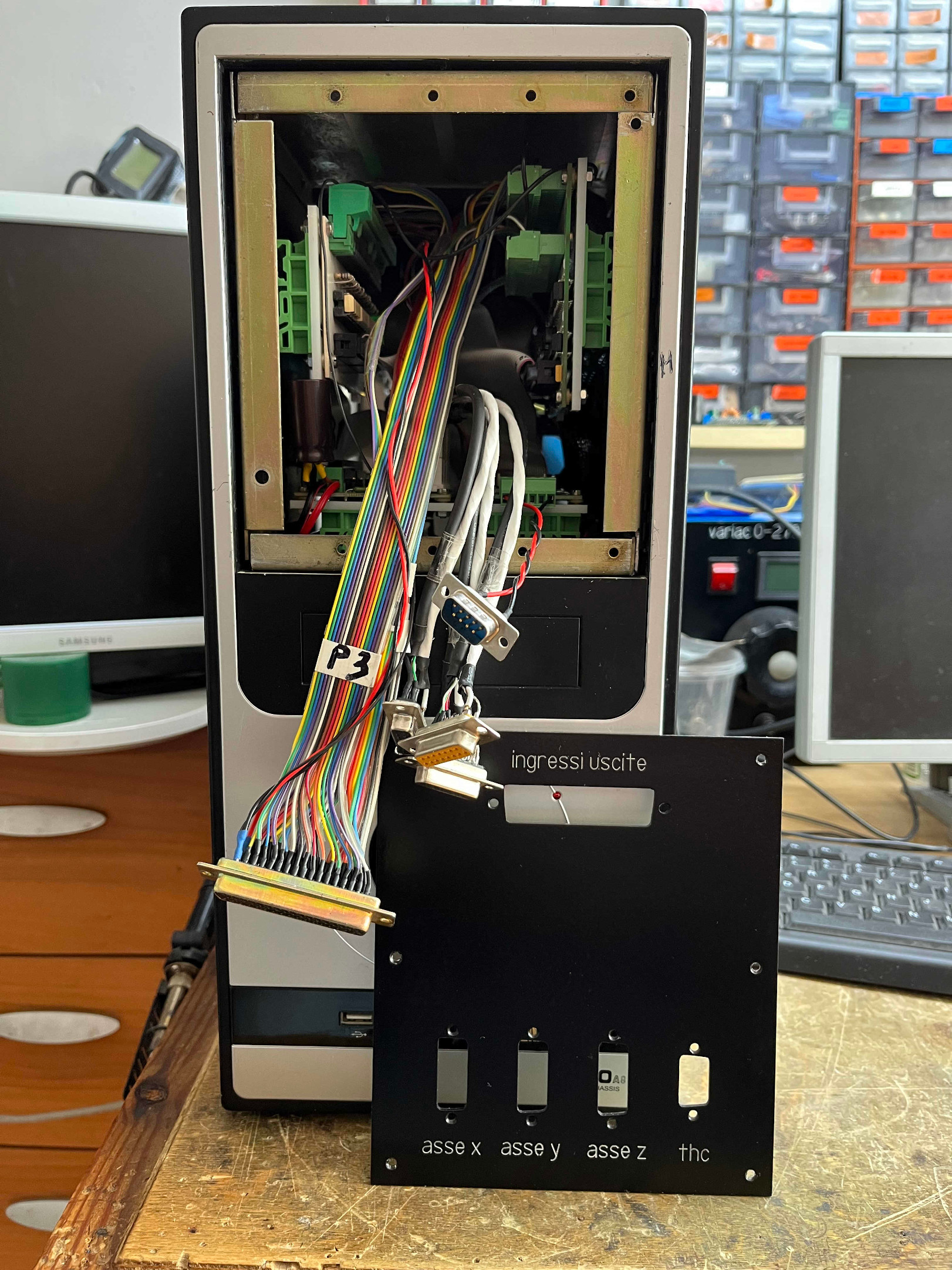

Very nice Rod!
I'm almost ashamed to show you mine at least the panel is milled and written with my cnc.

So many ways. I did think of making a plasmacut enclosure and folding it up. I have done one before which looked amazing once it was powdercoated. But really for $200, the enclosure seemed to be the easier way. The needed to be a lot of standoffs for DIN rails etc to be welded on.Very nice Rod!

That looks awesome! Your mention of running the stepper drivers on AC reminded me of some experimenting I did on an old Tormach 1100. Bypassed the 48v DC altogether and put in some DM2282T drivers connected directly to the 220v in. Made a much cleaner system, and I could run the steppers with about 4 times the acceleration and more than double the ultimate speed with those drives at the higher voltages.
Made me wonder why I wouldn't go that route on any homebuilt machine. The DM2282T were not cheap, but compared to drivers and a good DC transformer setup it wasn't that big a difference. And definitely would simplify the enclosure!
I almost never see these drivers used anywhere.
Regardless, I have learned a lot from your posts and your youtube vid on your build. Thanks for sharing all of it!
