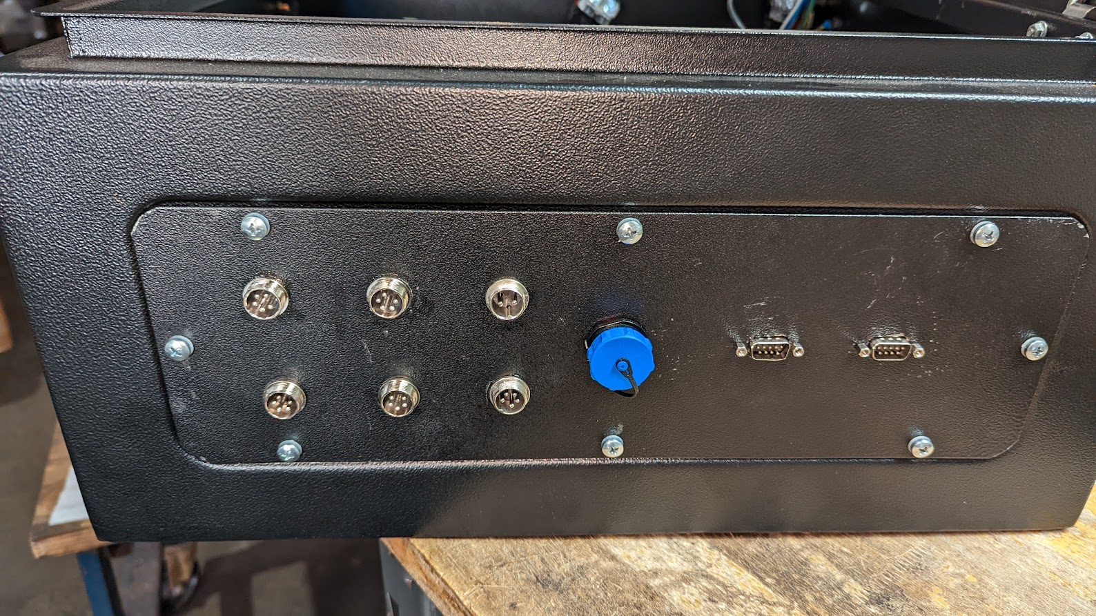

- Posts: 12027
- Thank you received: 4103
11 Jul 2022 17:49 #247089
Replied by rodw on topic Rods "Spaceship" Scratch built Plasma Cutter build

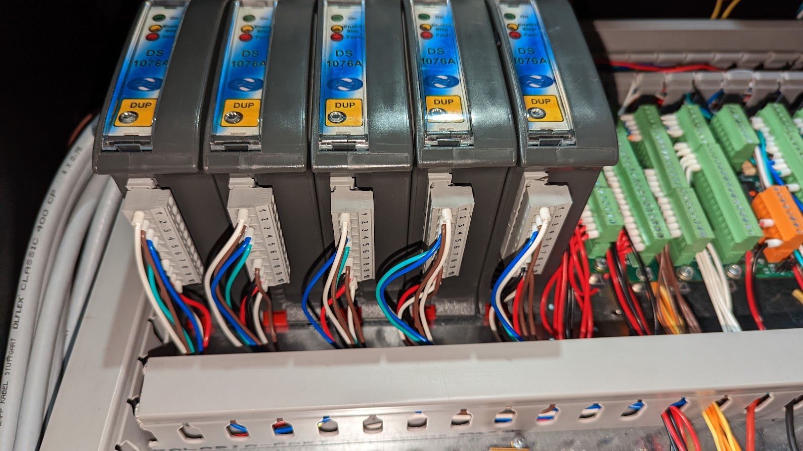

The part to the left is a contactor that is activated by the red safety relay
The fuse holders are from Ocean Controls Here in Australia oceancontrols.com.au/
The control box is still a work in progress. All the wiring to the stepper controllers are done
I got a friend to solder in all the connectors for the stepper motors because he's been trained to NASA standards when it come sot soldering
We used 5 pin connectors so the shield can be passed through right to the controllers themselves.
The 2 pin connector is for ohmic sensing.
The blue one is a Weipu 12 pin connector that goes to the Hypertherm CPC connector.
There is not really much left to do now. The DB9 connectors are for table and X axis sensors. So its just a matter of wiring them up and a couple of extra wires.
I would not use the silver GX616 connectors again as they are too time consuming to solder. The last control box on the mill just used cable glands and the wire went right to the drivers.

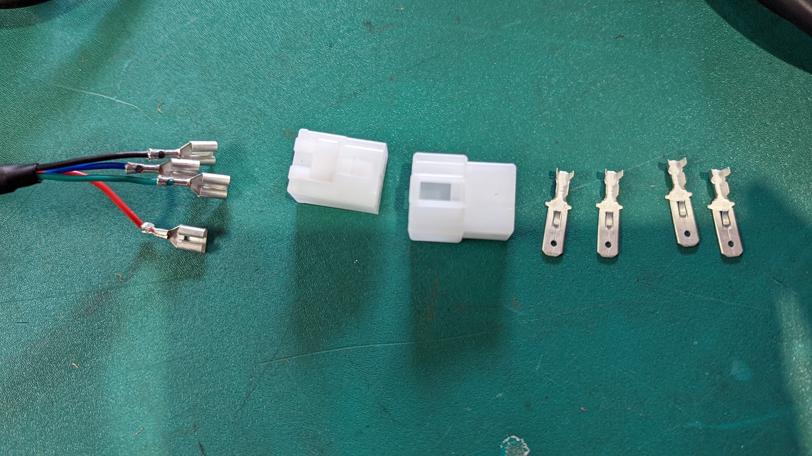

I was going to look round for crimp on options eg. Amphenol et al. Granted you need a crimping tool but the cost of contract soldering would pay for it in one job if my current tool does not work. At the motor end recently I've been using automotive QC connectors.
These need a crimper. Despite their looks, they are not compatible with the normal coloured automotive spade connectors.. But they are nice and light if suspended in the air and give a good contact.

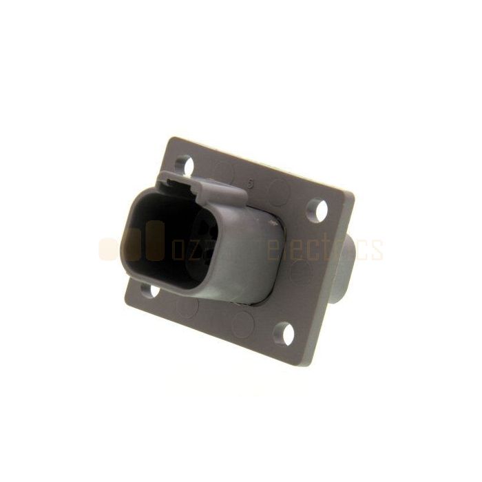

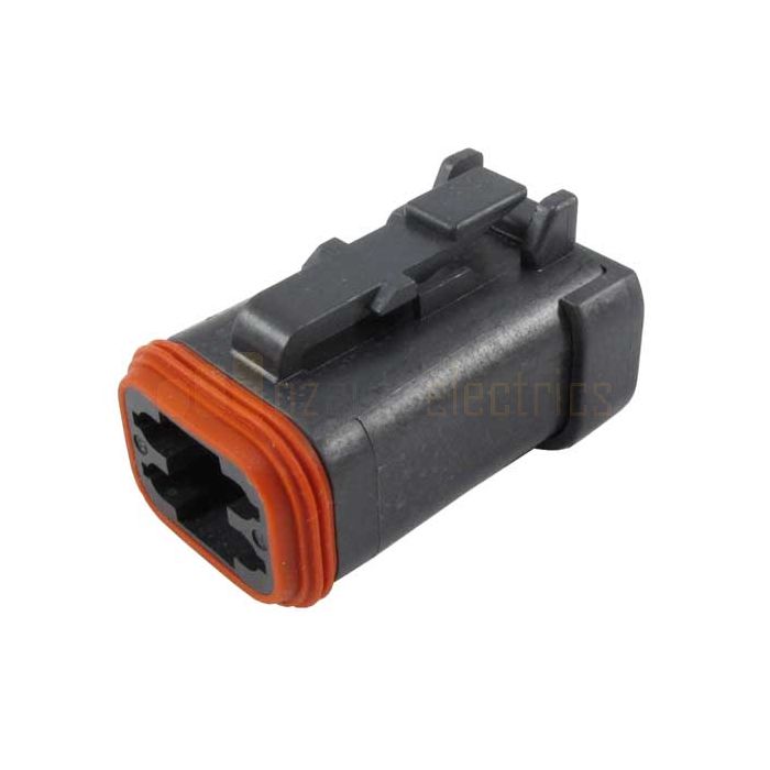

- MontStar
- Posts: 3
11 Oct 2022 07:38 #253937
by MontStar
Replied by MontStar on topic Rods "Spaceship" Scratch built Plasma Cutter build

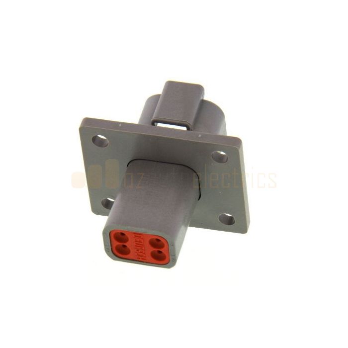

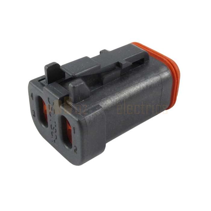

Hi Rod, I've been following the spaceship for a while.I'm thinking these would be a far better connector than QC connectors. Used widely in the mining world. Original Equipment for Caterpillar.
Have a look here www.ozautoelectrics.com
- Posts: 12027
11 Oct 2022 09:32 #253940

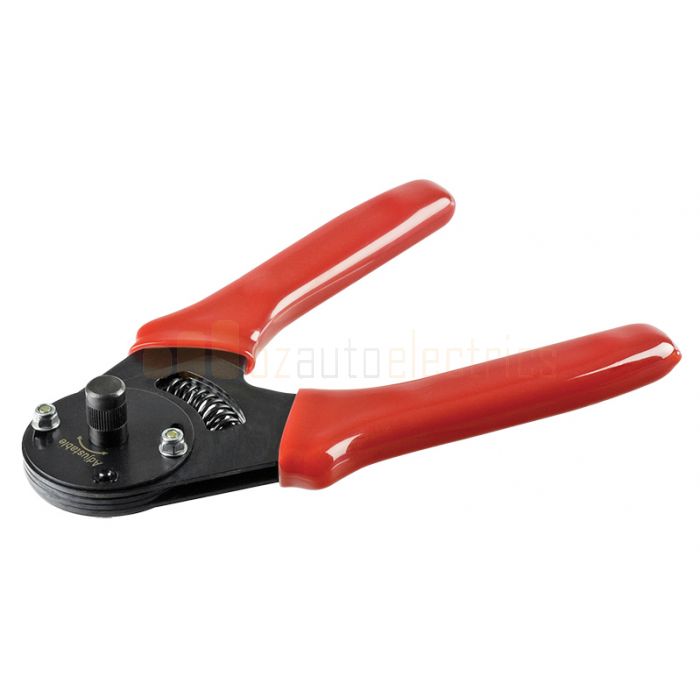

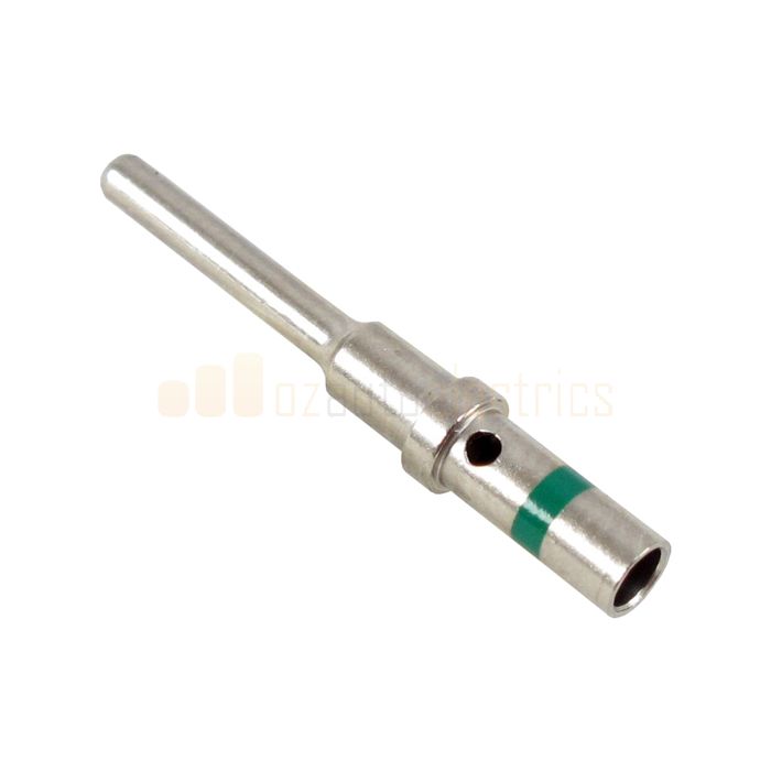

Yeh, the Deutsch connectors are becoming quite popular for vehicle wiring. Even the small ones are good for 16 amps. The price of some of the crimping tools is a bit eyewatering.
The QC's are about 1/4 the cost and were really a spur of the moment idea as I was driving past the supplier.
I have also thought of using Amphenol which are another crimpon connector.
There was a thread here that went right through correct wiring and shielding and from that best practice was to run the cable right through to te drive. Cable glands are even cheaper.
