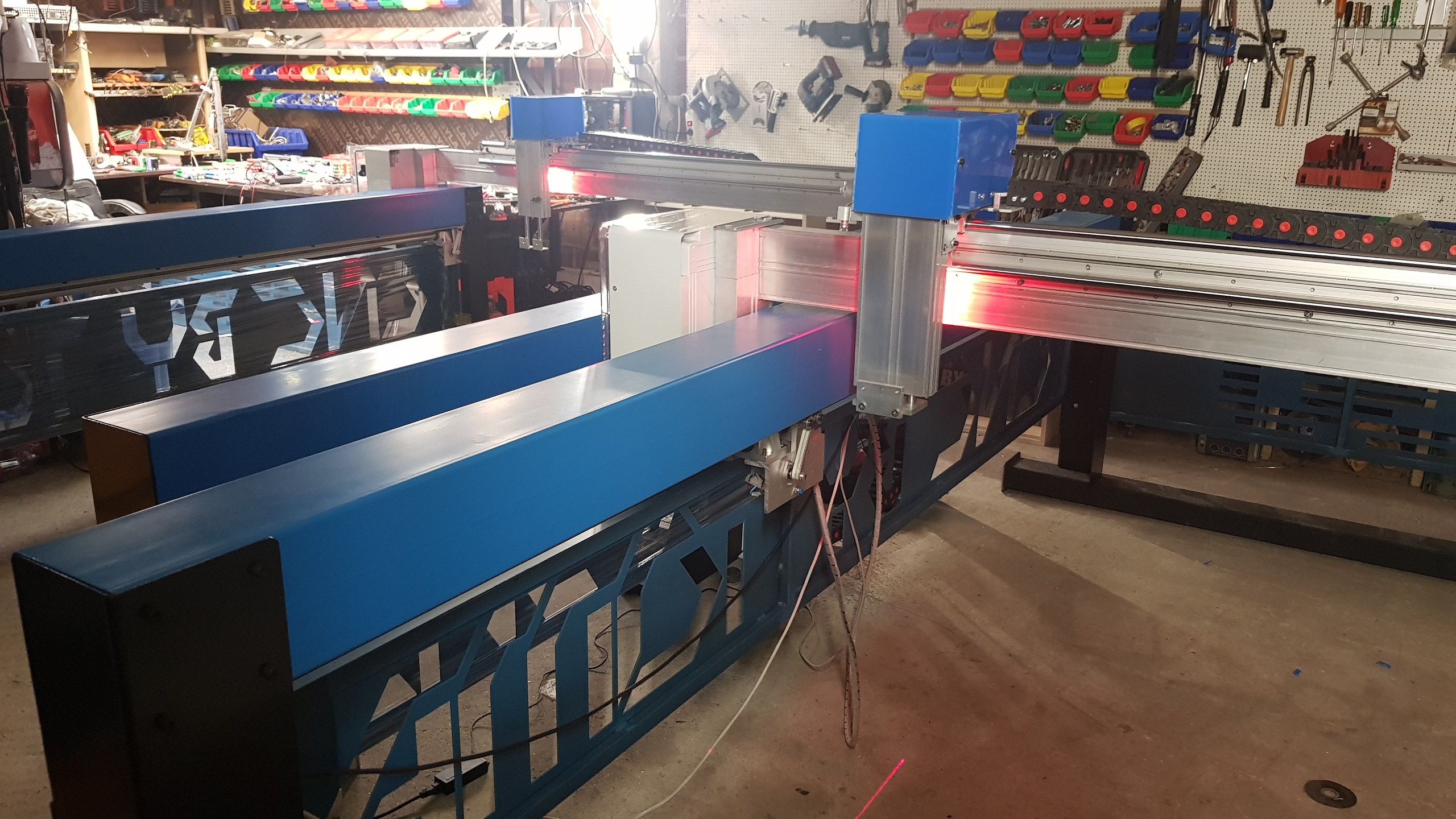

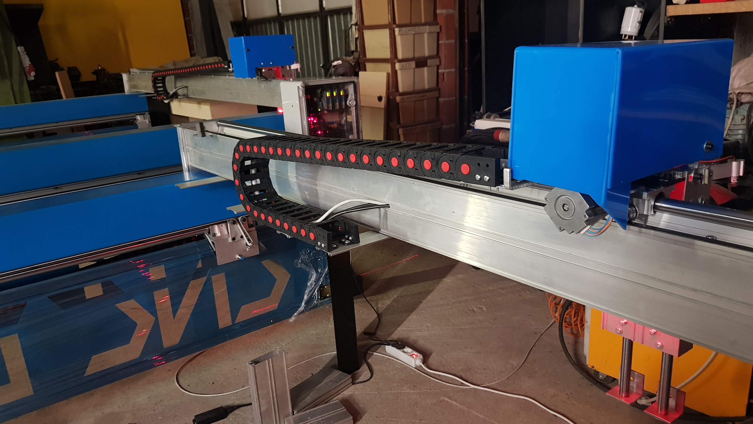

Tommy, I went back though your posts but could not see a photo of the drive on your Y axis. So You've used two round rails on each side?
It would be good to see some closeups Uncle Tom!

Rails, one per Y side:
forum.linuxcnc.org/show-your-stuff/38547...build?start=0#161039
Drive train on one Y side, same on the other just mirrored:
forum.linuxcnc.org/show-your-stuff/38547...uild?start=10#165577
