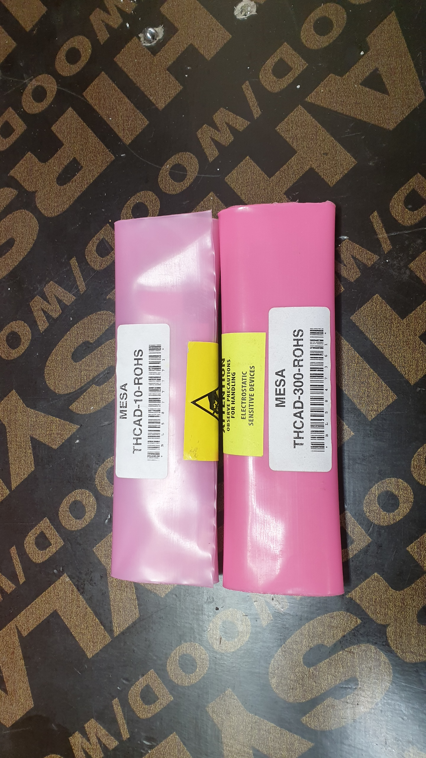

No more excuses now Tommy! Like the dog ate my homework or the courier lost my THCAD's
That just won't cut it now!

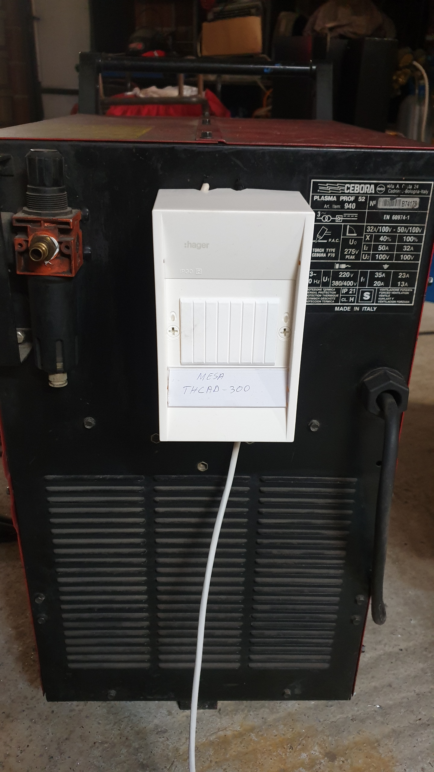

01 Jun 2020 22:54 #169733
Replied by tommylight on topic 2+2+3 More Plasma builds, double the joy ! 3X2M and 2.5X1.5M cnc plasma build.
Finally got to wiring the THCAD300 to a Cebora 50A plasma cutter with "High Frequency/High Voltage" pilot start and got very disappointed when no smoke escaped !
Did several test with the torch far from material ( worst case scenario for interference ) and with the torch touching the material ( worst case for the THC ), no issues at all.
Also took some pictures of the insides of the plasma cutter as it has separate boards for everything making it very clean and easy to see how things work and interact. Not of much importance as everything is going the SMPS way or "inverter" type power supplies, but it helps in locating functional blocks inside a plasma for wiring torch on, arcok, and THC.
More pictures and stuff tomorrow.

02 Jun 2020 17:32 #169833
Nothing to report !
Wired the THCAD to the rest of the electronic, did some cuts by hand as the torch is not mounted yet, everything works, even with all the cables laying on the ground intertwined.
Goes to show that proper grounding and shielding is the most important part of building a cnc plasma machine.
Again, i am reporting this as this is a HF/HV pilot start plasma, and the manual for THCAD300 rightfully states not to use it with this types of plasma sources, as wiring it to the wrong place will render it crispy at the first firing of the torch.
More experimenting, and that is going slow due to small compressor.

03 Jun 2020 20:47 - 03 Jun 2020 20:48 #170002
It did first cuts today! Yay !
The THCAD is mounted as usual on the back of the plasma cutter, in this case a Cebora Plasma Prof 52. so here is a picture of how that looks finished:
Need to make some custom fittings for replacing the hand torch with a Trafimet A141 machine torch, add a magnetic holder, and wait for the side and back plate from painting. Then build a 3.3X2.3m water table that will weight about half a ton.
Now if only i had the rest of the parts for the smaller one .....
