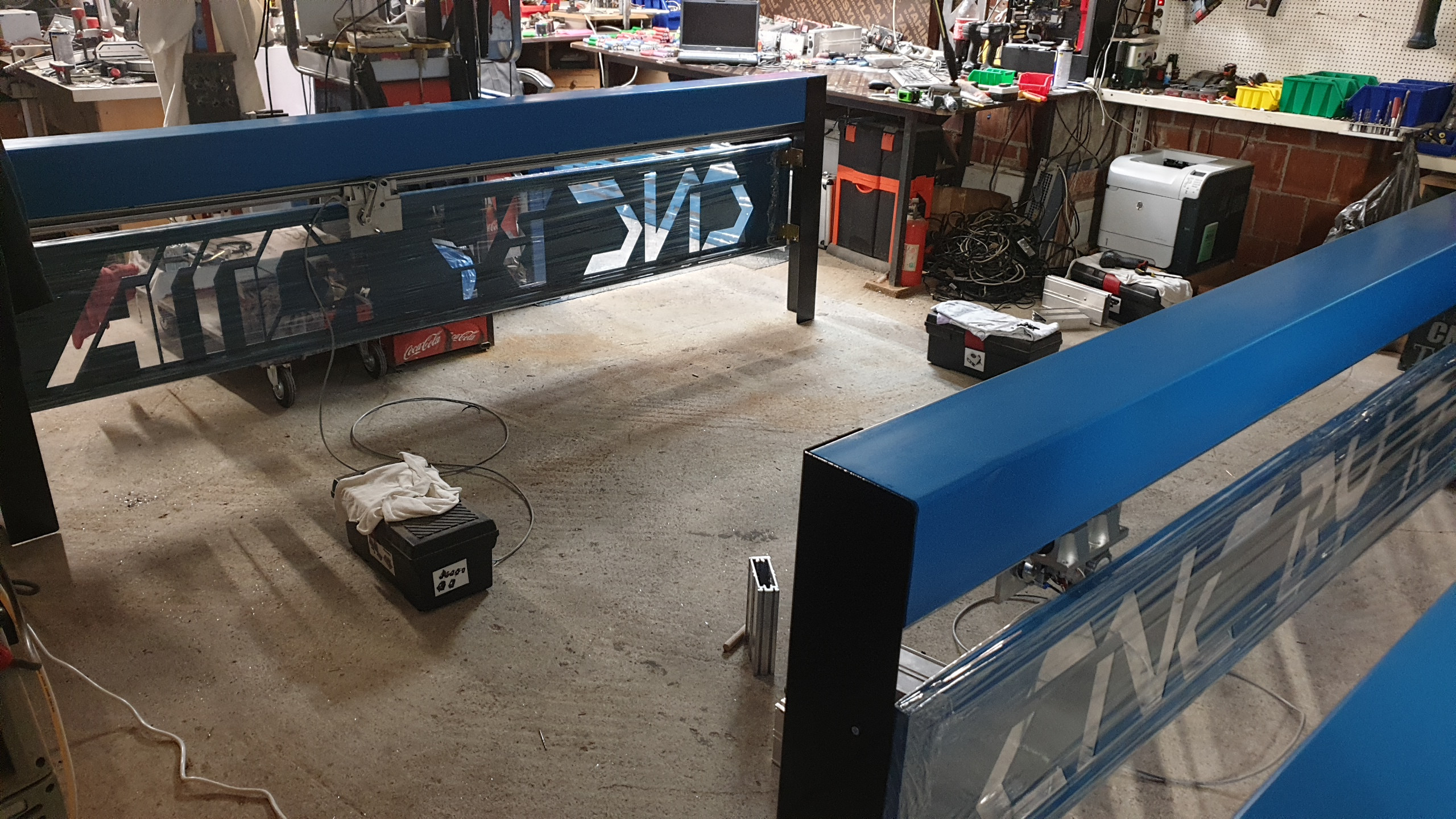

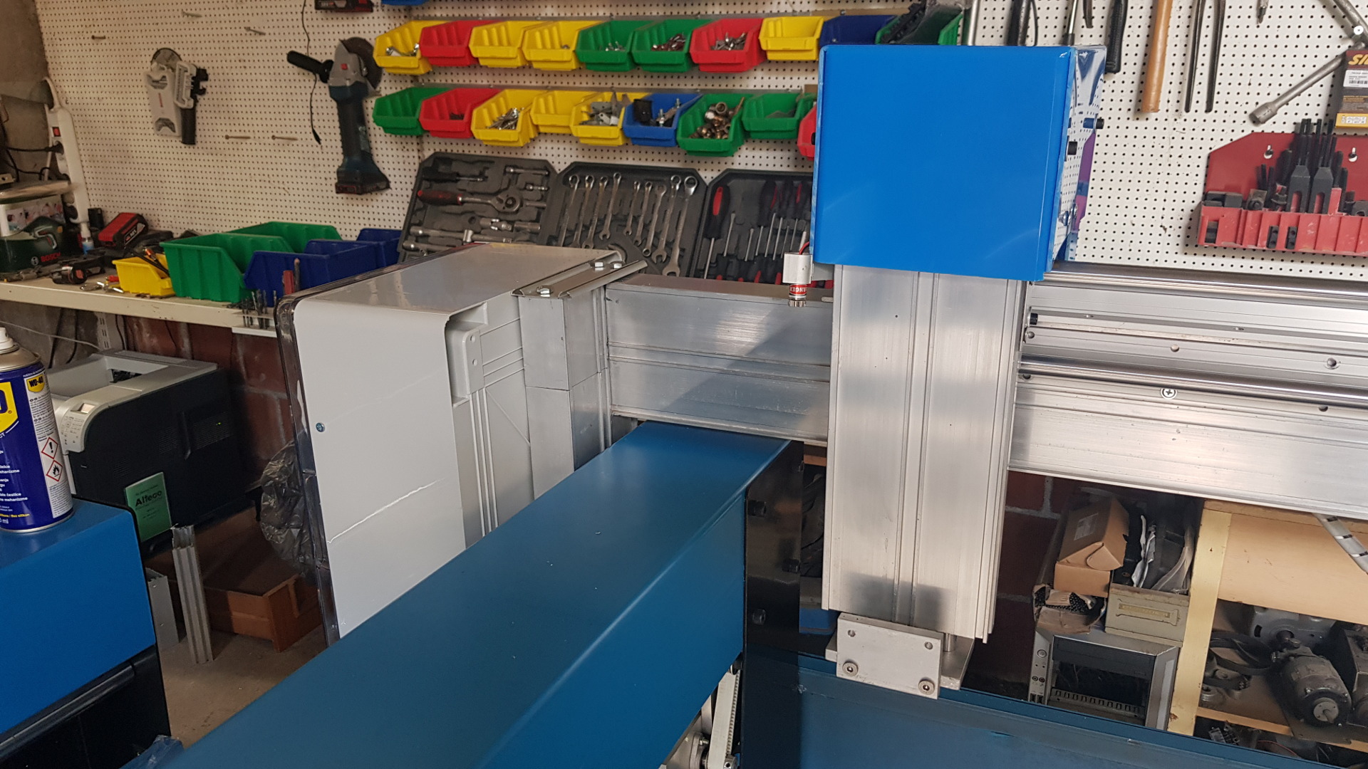

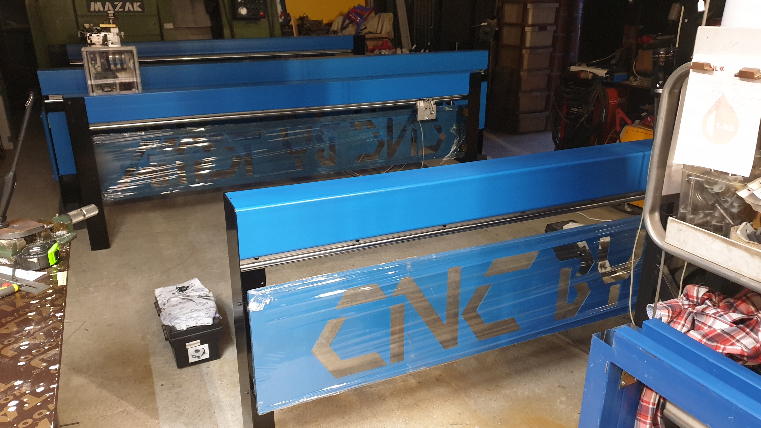

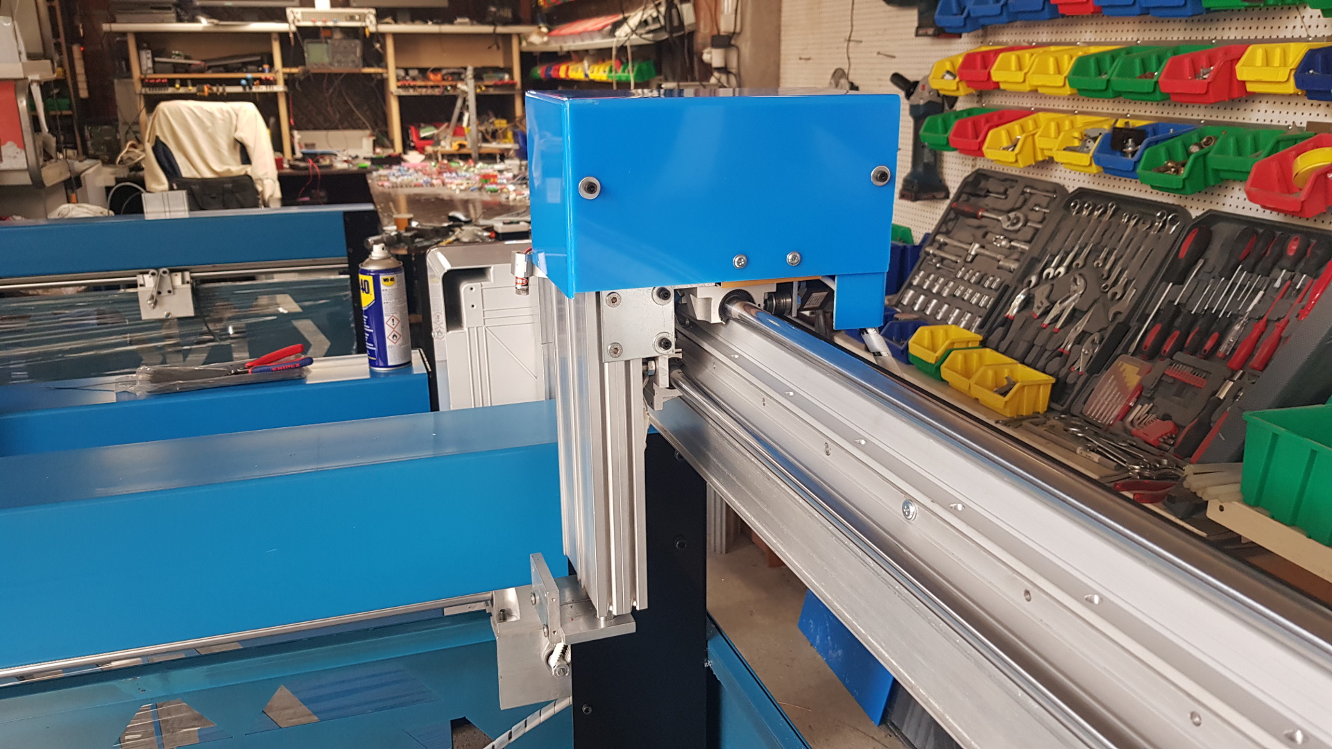

The forum is having some weird issues, namely when i delete an oversized picture, it will delete the text in the message! This has been happening since yesterday, never before.
The second smaller machine is up on it's own legs, finally, so now the kids get two spaces to dance in.
Some pics
Regards,
Tom.
