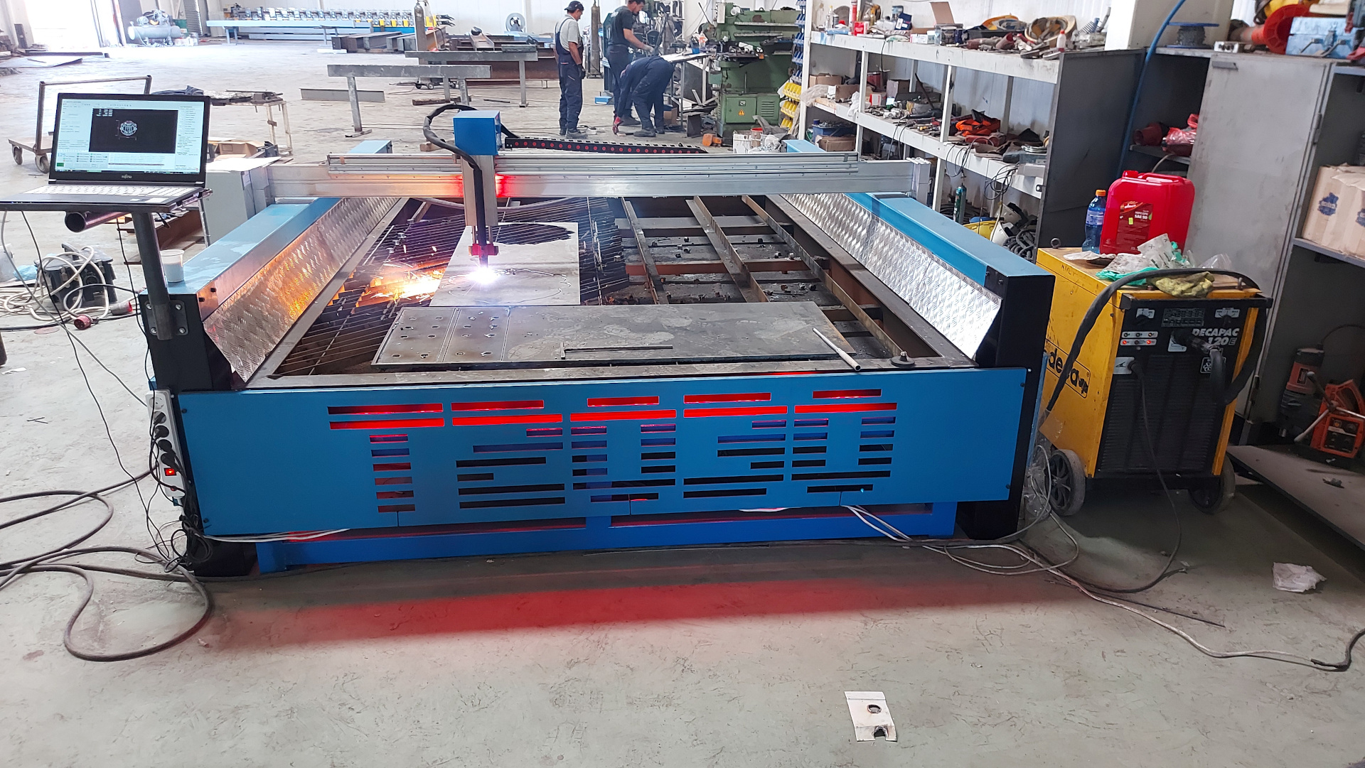

But since you are here, there are still some issues with offsets in PlasmC like Z axis for some unknown reason retracting to 171.5mm and sometimes to 175mm and tripping the home/limit switch although it is set at max 170 in the ini and home is at 160, and sometimes completely stopping motion after such occurrences requiring disabling the machine and enabling it again to be able to continue.
This was all with version 169 and LinuxCNC master version, same issue was in 165.
Everything else works magnificently.
Replied by tommylight on topic 2+2+3 More Plasma builds, double the joy ! 3X2M and 2.5X1.5M cnc plasma build.
You are welcomed, always.Thanks for the kind words.
Unfortunately after several requests to finish that table and fill it with water, it remains unfinished and dry, most probably will remain for the rest of it's working life like so. It is out of my hands now, so i can just keep asking them to do that.You need to get some water in there to protect those slats Tom.

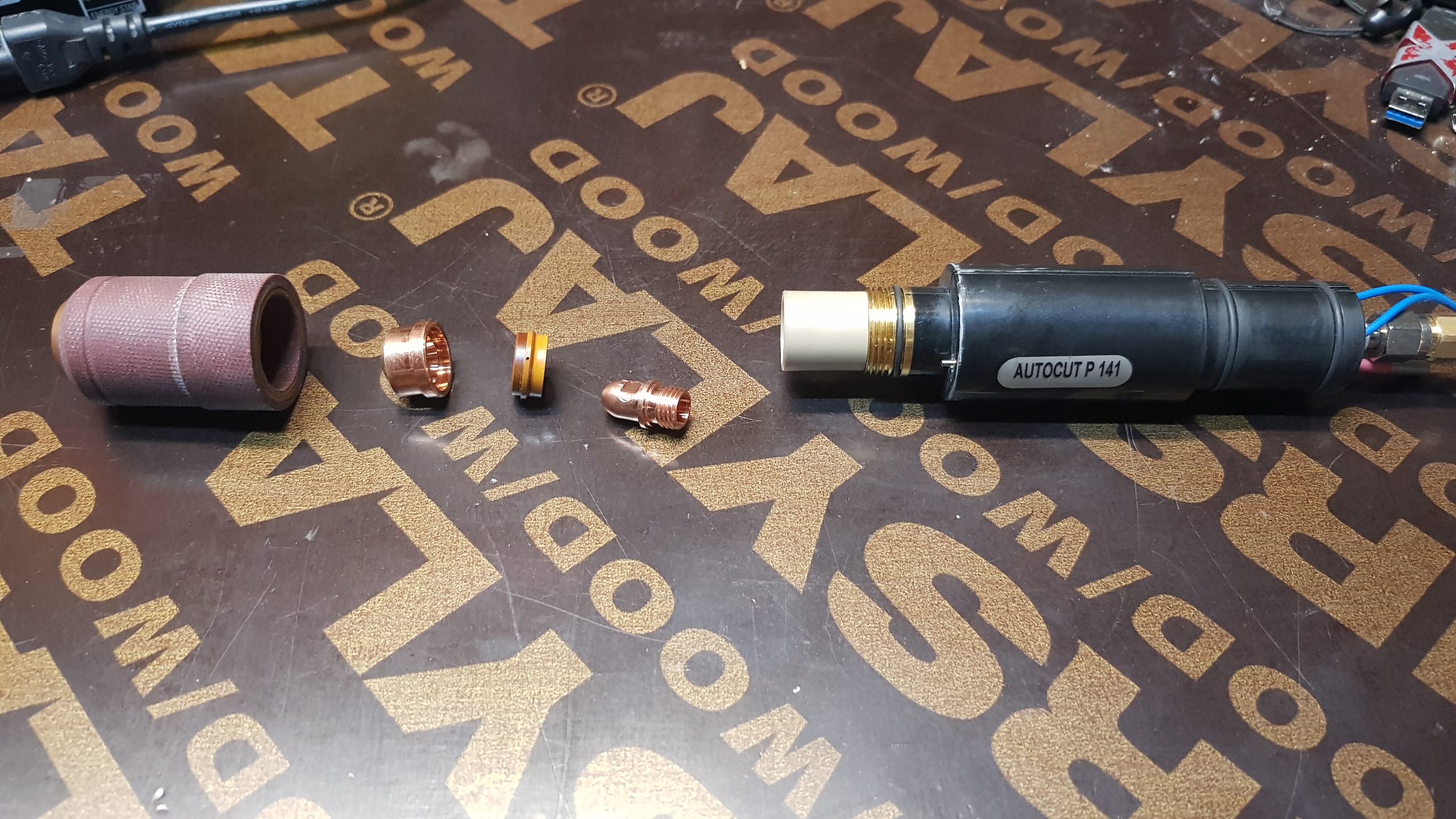

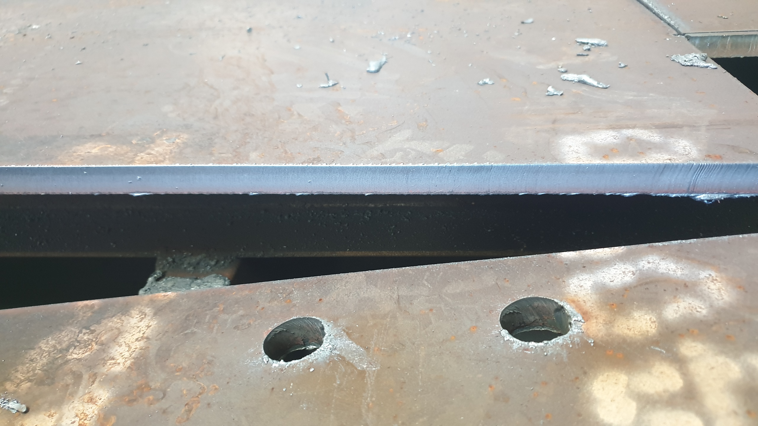

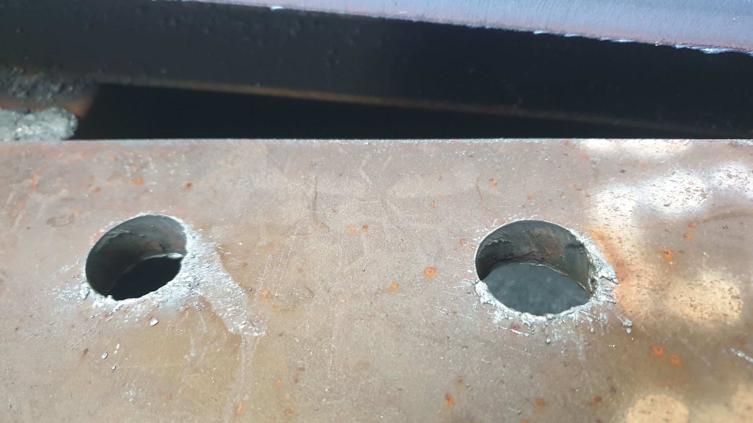

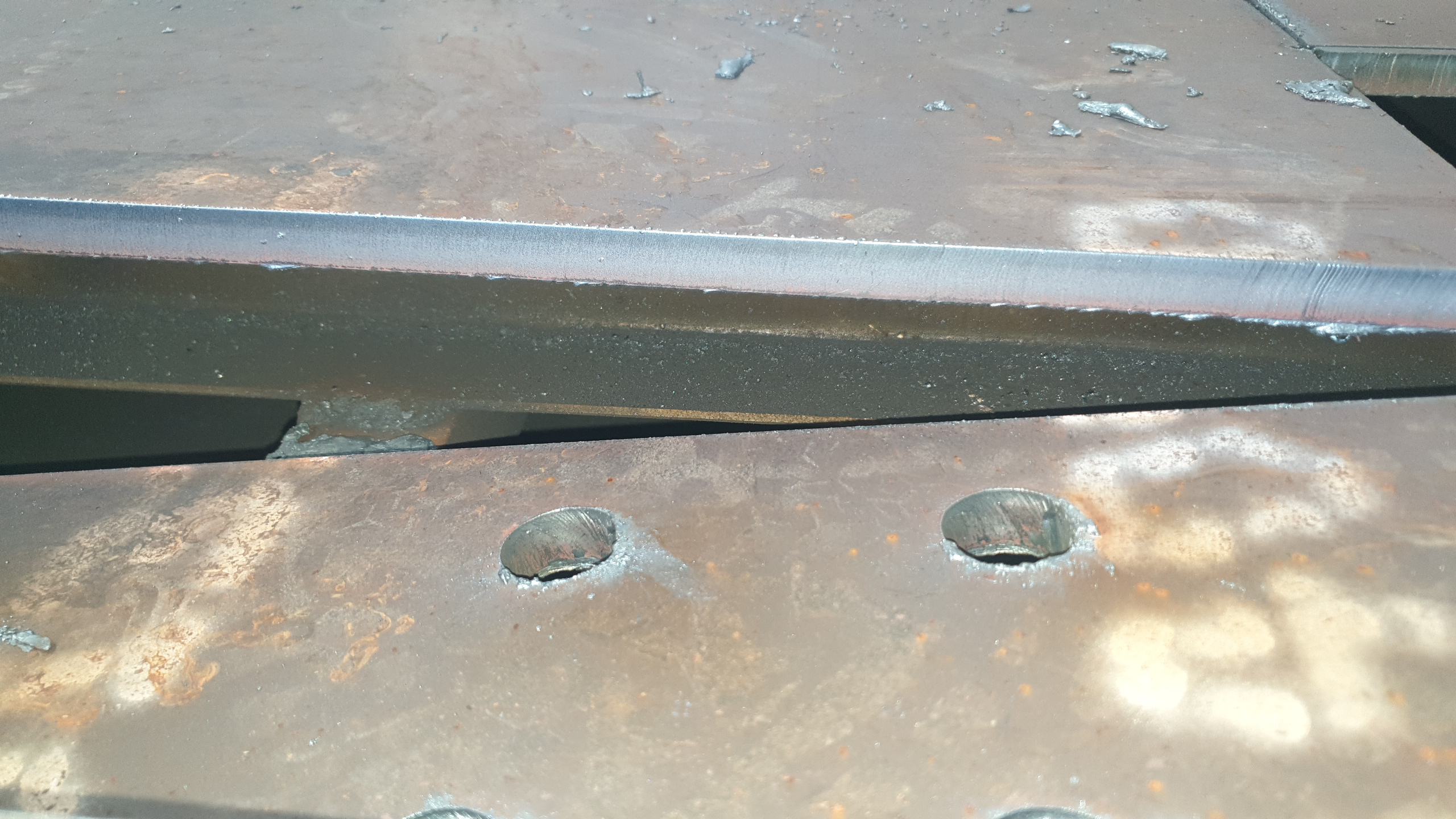

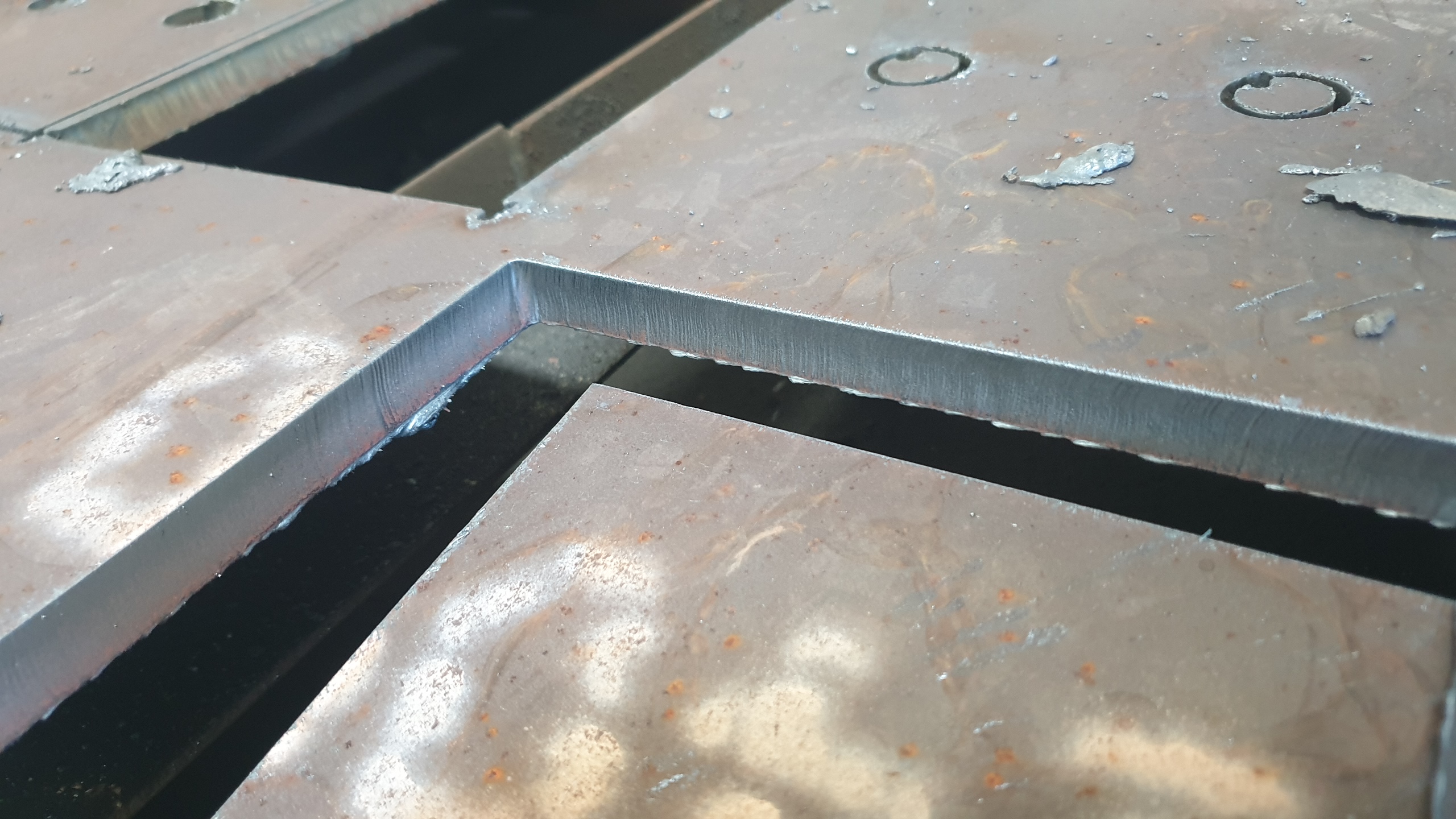

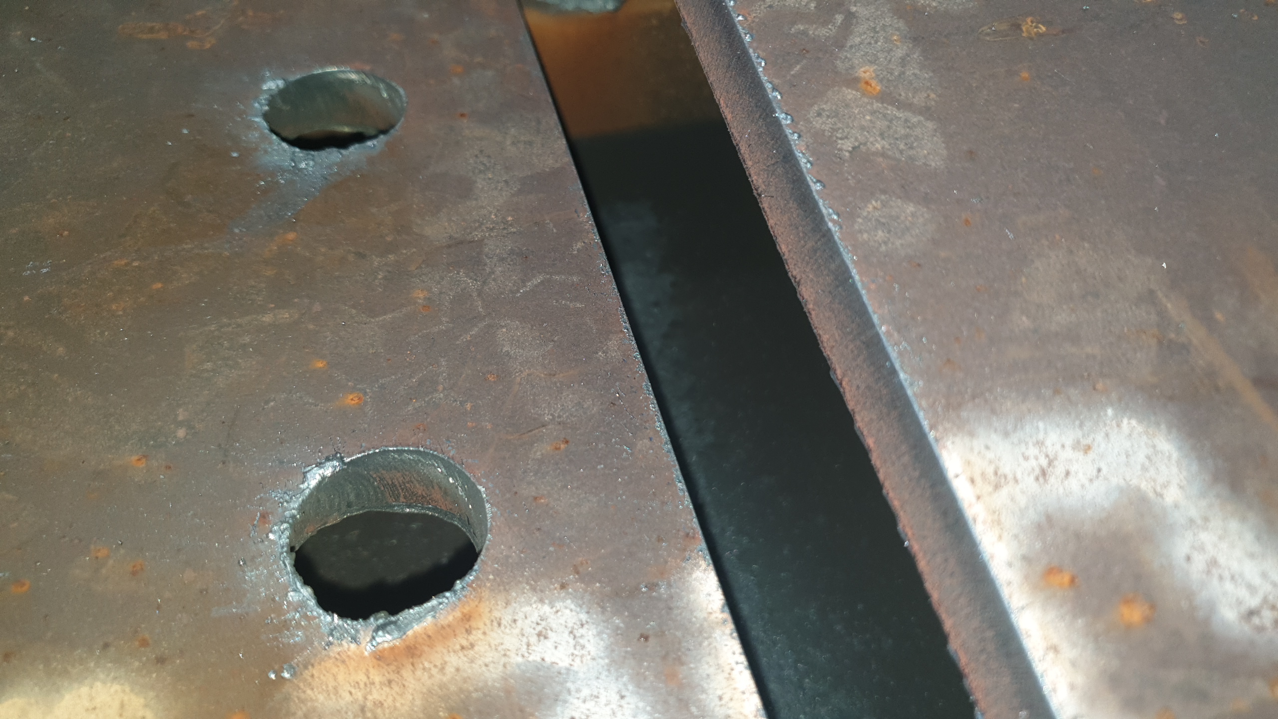

Here are some pics taken today while doing some more tuning and finding out that more expensive non original nozzles are much worse than the cheaper original ones from Trafimet, the non-original would not cut through while the original does this with the same settings : 85A and 400mm/m feed rate
I can feel the envy from TheFabricator coming my way !

29 Aug 2020 20:54 #179967
Replied by rodw on topic 2+2+3 More Plasma builds, double the joy ! 3X2M and 2.5X1.5M cnc plasma build.
Tommy, are you trying to start the battle of the holes?
Oh yes, yes, YES !Tommy, are you trying to start the battle of the holes?

31 Aug 2020 04:06 #180130
by thefabricator03
Very nice holes Tom. It is interesting about the consumables.

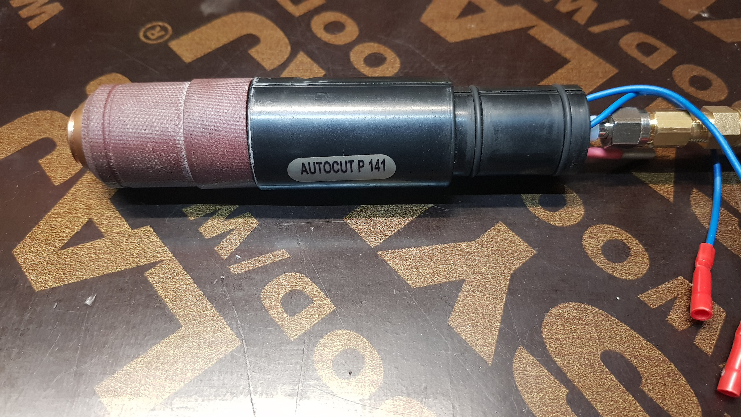

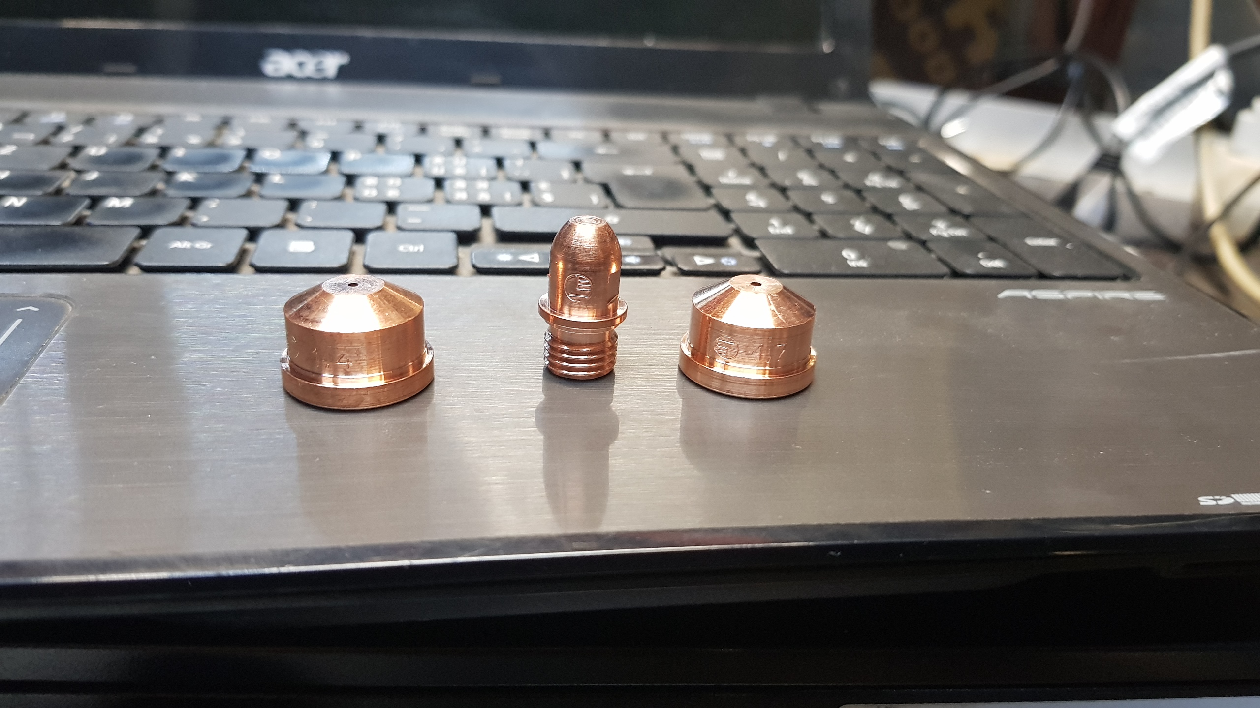

This is what i use, the Trafimet AutoCut P141 and the electrode and nozzles with 1.4 and 1.7mm orifice, i also have 1.1mm ones. The above cuts were done with the 1.4mm one. The torch is good for 120A at 100% duty cycle, costs me about 170 Euro new, a set of nozzle/electrode is 4.6 Euro, and a 1.1mm set can do over 1000 meters of cut on a 3mm plate, consistently, so bloody worth every cent.Very nice holes Tom. It is interesting about the consumables.

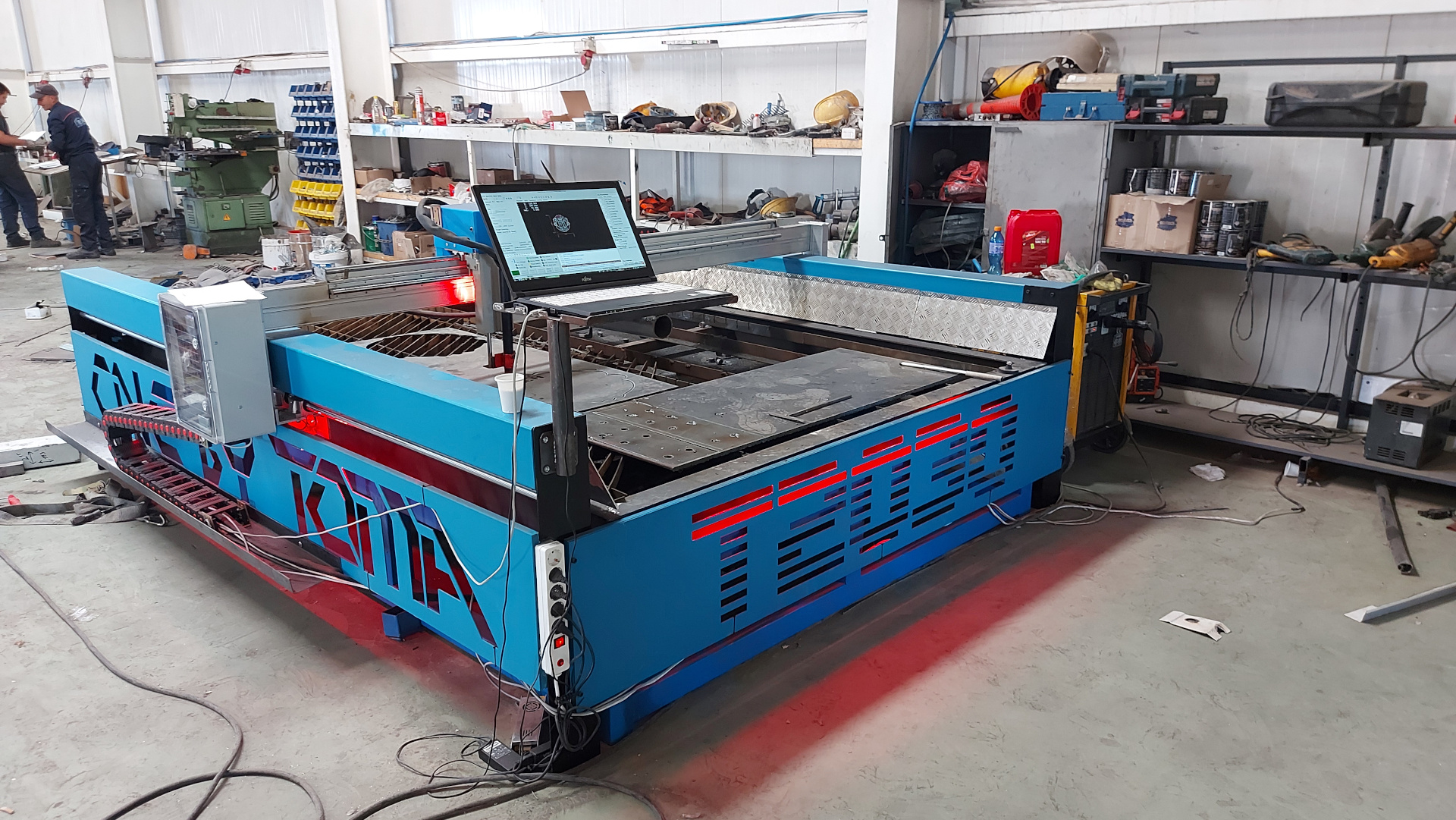

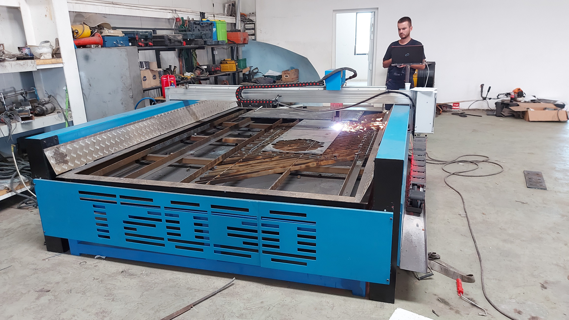

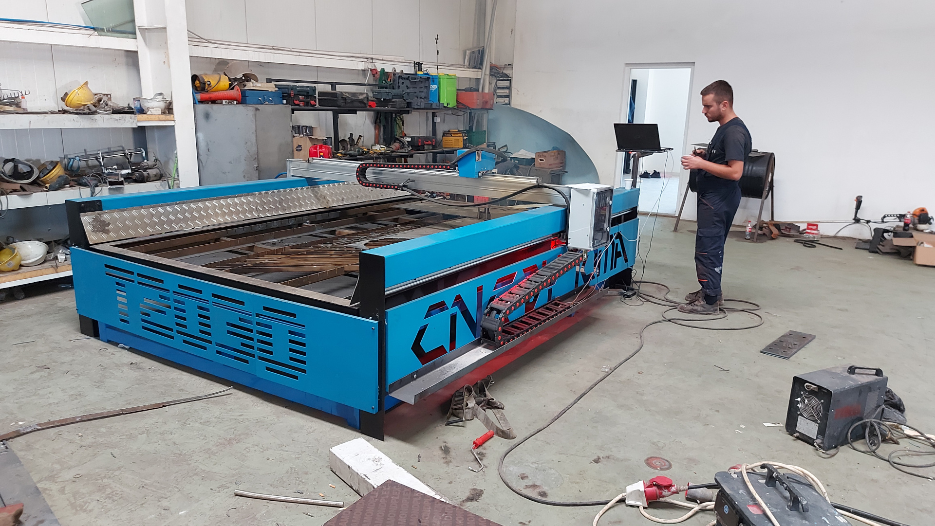

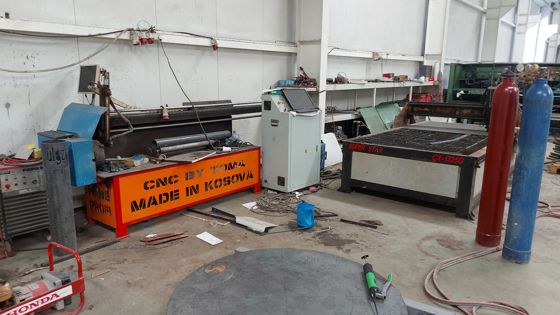

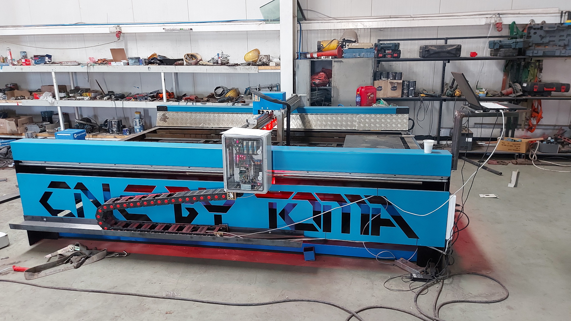

Some more pictures of the big machine
We did cut some 20mm plates but i was on the phone, it was a busy day as i had to go check an industrial wood router thingy, Italian made some 20 years ago, still in working condition but pretty much useless due to dated software, so the owner insists on updating it to LinuxCNC.
And another machine i have built for them and a retrofit of a chinese one with LinuxCNC some 2 years back, still both working flawlessly.
