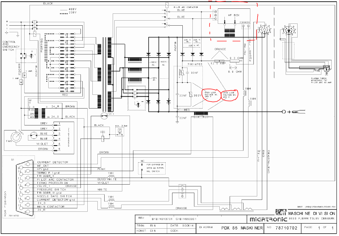

29 Sep 2020 11:00 #184271
Replied by tommylight on topic 2+2+3 More Plasma builds, double the joy ! 3X2M and 2.5X1.5M cnc plasma build.
Can you please point me in the right direction ?

29 Sep 2020 12:08 #184280
by Kiddekanin
Replied by Kiddekanin on topic 2+2+3 More Plasma builds, double the joy ! 3X2M and 2.5X1.5M cnc plasma build.
- Posts: 21995
- Thank you received: 7488
29 Sep 2020 12:33 #184282
That is exactly where the THCAD should be connected, the red on the left side of the schematics.
What THC are you using ?
THCAD 300 can be wired at those two points although in the manual it explicitly says not to use it with HV start plasma, but i am using it with HF/HV plasma with no issues at all, wired at the same spots as you have marked on the left with red.
For THCAD 10 you would add a 1MOhm resistor to EACH of the wires, so two resistors in total.

30 Sep 2020 05:05 #184350
by Kiddekanin
Im planning to use the THCAD300 (hence I do not have eny voltage devider and did not want to fiddle with that part)
And if it cooks, then I might have to try the THCAD10V and make a voltage devider as you describe, with the 1MOhm resistors at both leads.
Thank you weary much for the input, I can now move forward in my projekt

30 Sep 2020 08:01 #184363
by Kiddekanin
Is there a reason why you used the 300v and not the 5v or 10v with additional voltage devider for the cebora?
- Posts: 21995
30 Sep 2020 18:13 #184401
It is just easier for me to use the 300.
