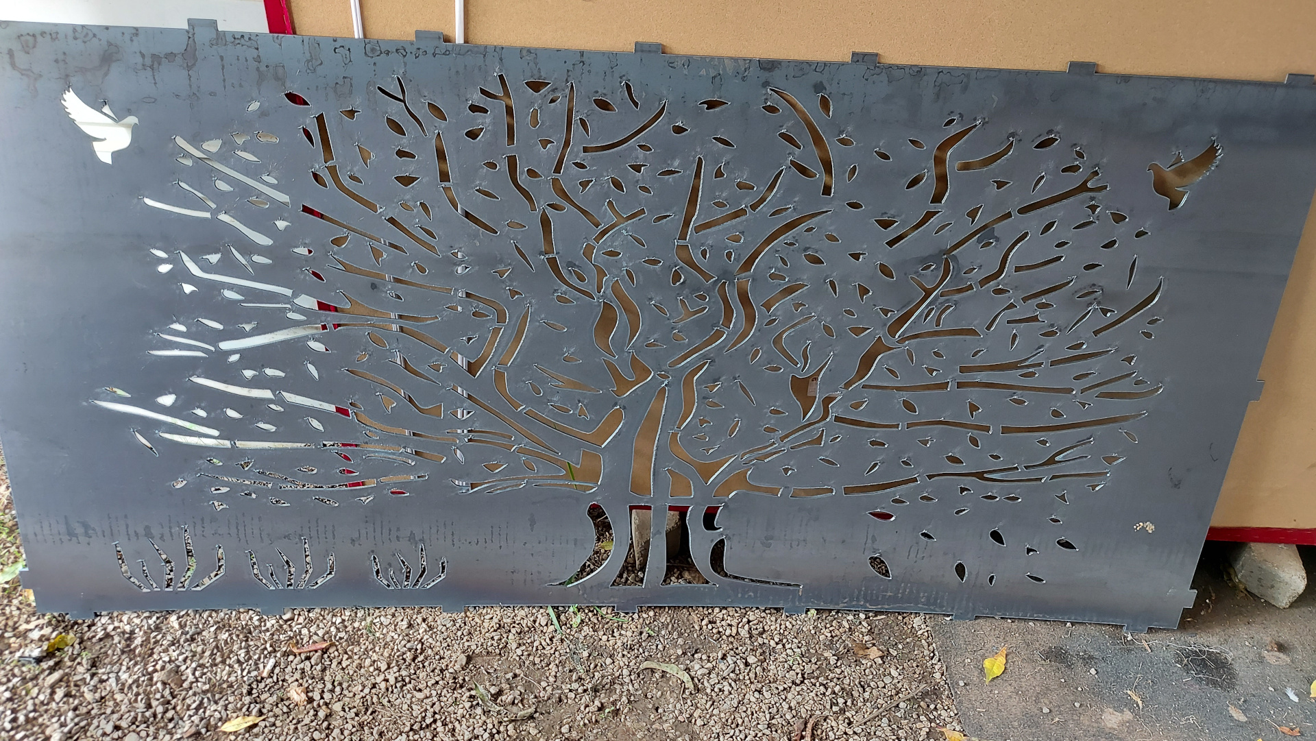

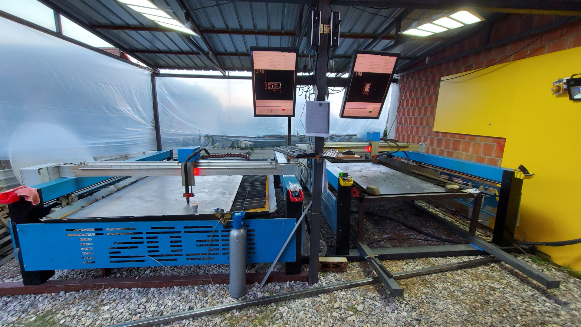

26 Oct 2020 06:05 #187293
Replied by tommylight on topic 2+2+3 More Plasma builds, double the joy ! 3X2M and 2.5X1.5M cnc plasma build.
The complicated pattern was cut with 2 to 2.4M/M feed rate @60A measured/50A set on plasma, so being a p.o.s. i am i thought that is not good so did some tweaking today and sure enough i got it to cut without a hitch at 4M/M !
To many settings on PlasmaC so still finding out how to tweak things, thank you Phill, you owe me a Jameson !

Did you do the cad ?Last two days been cutting lots of these:
Not cleaned at all, just got off the cutting table.
