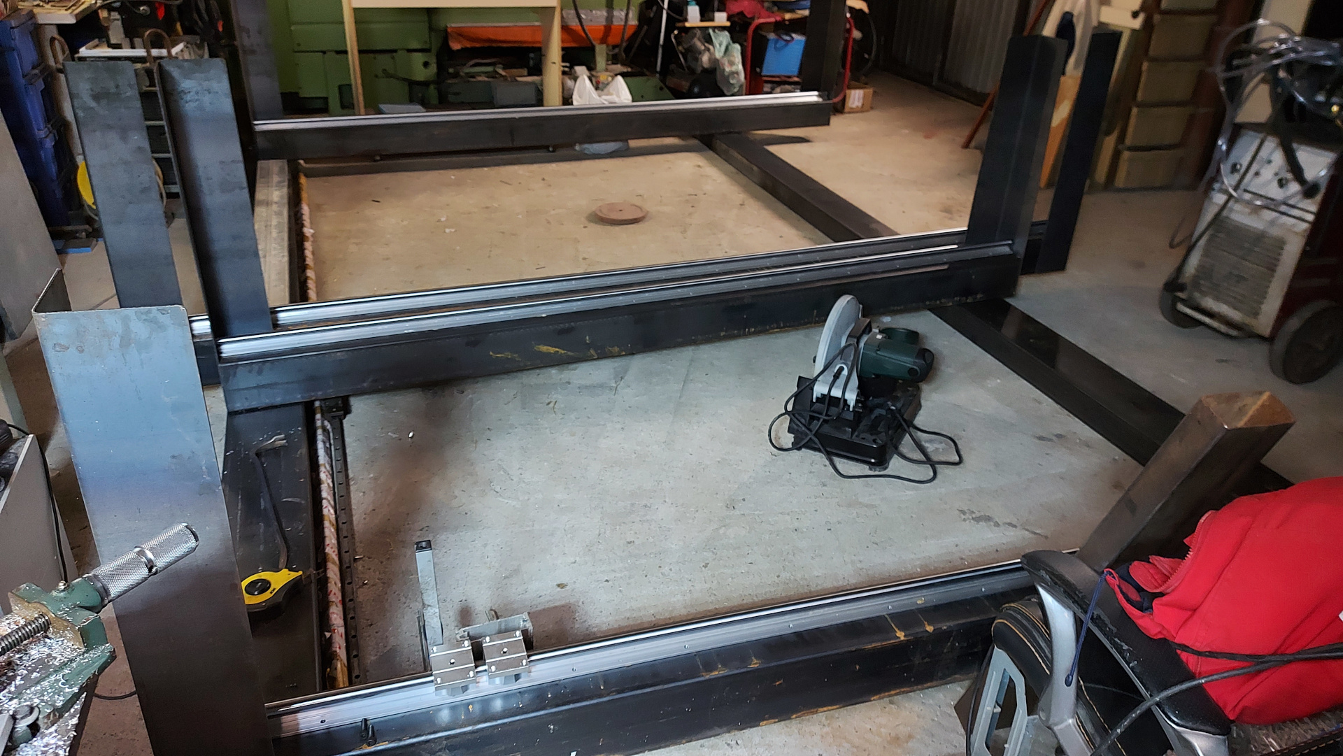

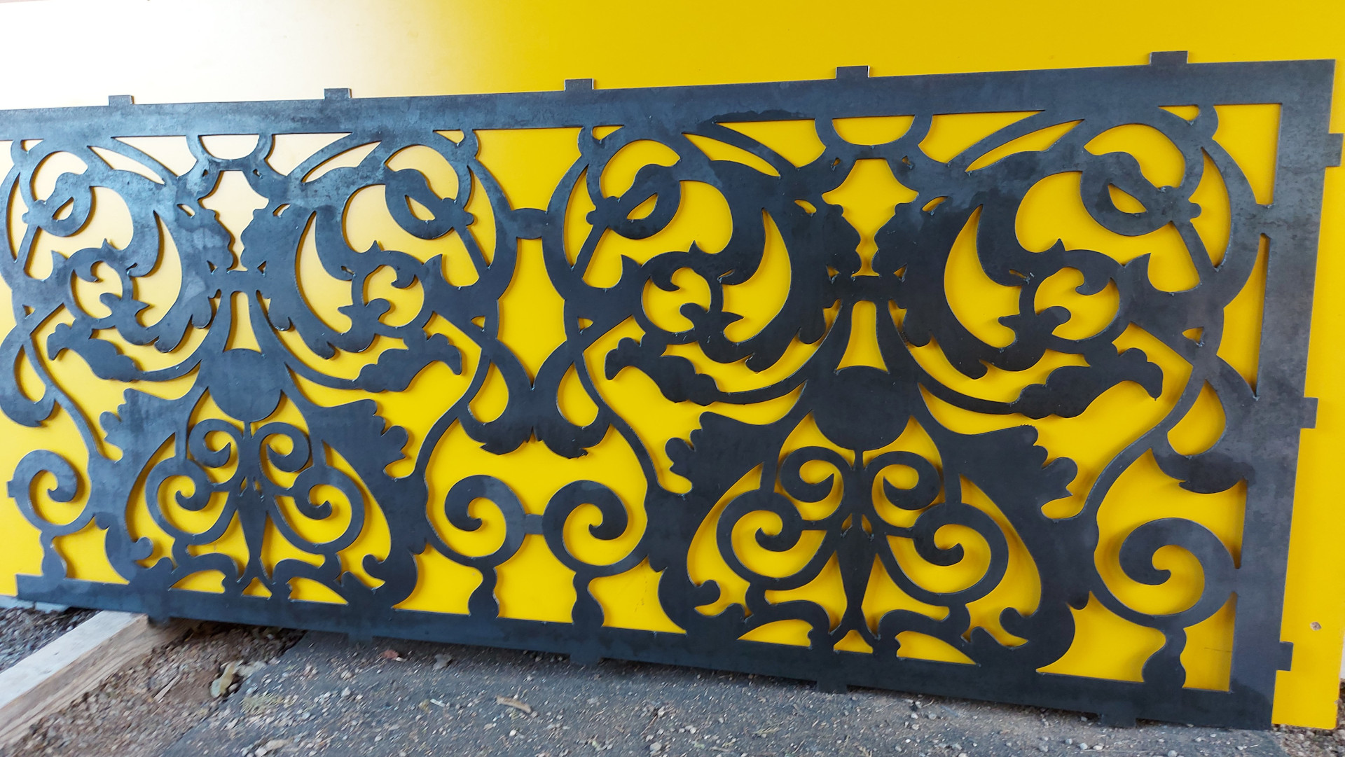

Last two days the big one has been cutting these, some only 30CM in height so there were 7 section on a 2m length, so the poor machine did over 2500 pierces and cuts. Phill will have a blast as i can happily report that PlasmaC worked perfectly, the machine worked perfectly to the point that i just let it run and went in to work on the "other" stuff ! Not a single hiccup !

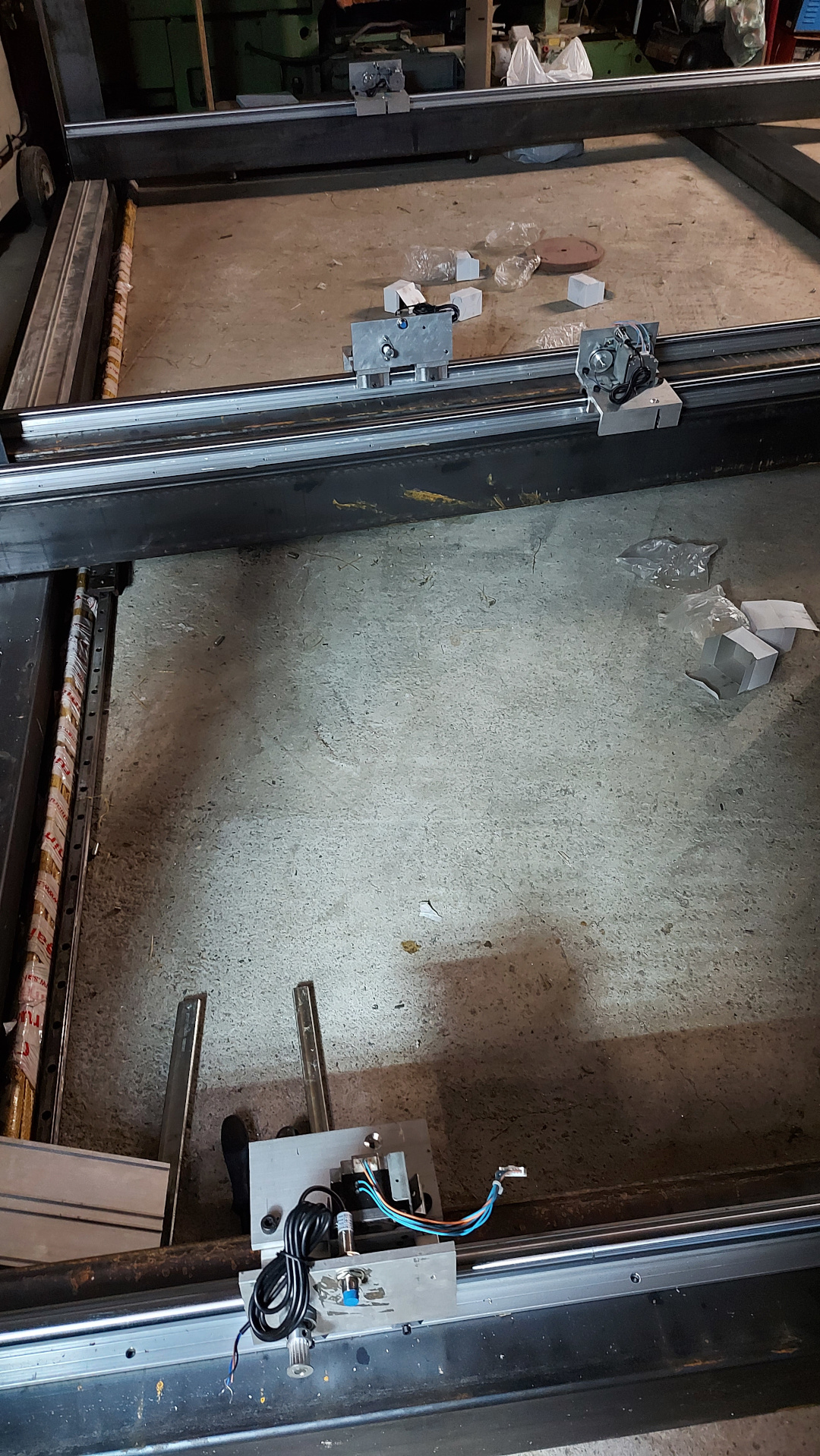

BTW< i am posting here, no use in starting a new topic since they are identical in every way, shape, or form.
So in total this would make two of the 2.5X1.5M and two of the 3X2M work envelope machines, or as i call them: the small one and the big one, now times two.
Regards,
Tom.
Regards,
Tom.

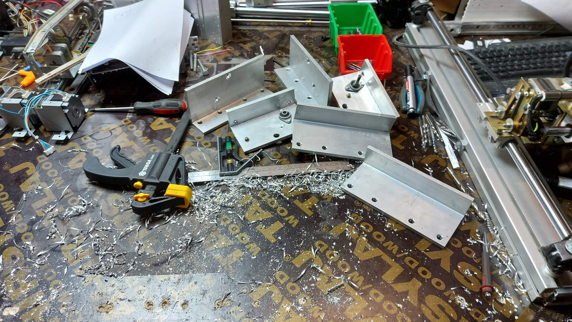

But i already have a bill of materials i did two days ago, now i need some time to do some drawings with dimensions and upload them as time permits.
The Z axis is way to complicated, but it does look and work nicely. And is protected from the fine dust plasma makes.
Open sourcing it seems a good idea, selling it does not.
I hate money.... do not have time to think how to spend it!
Sending the parts for paint today, powder coating, should look niceeee.
