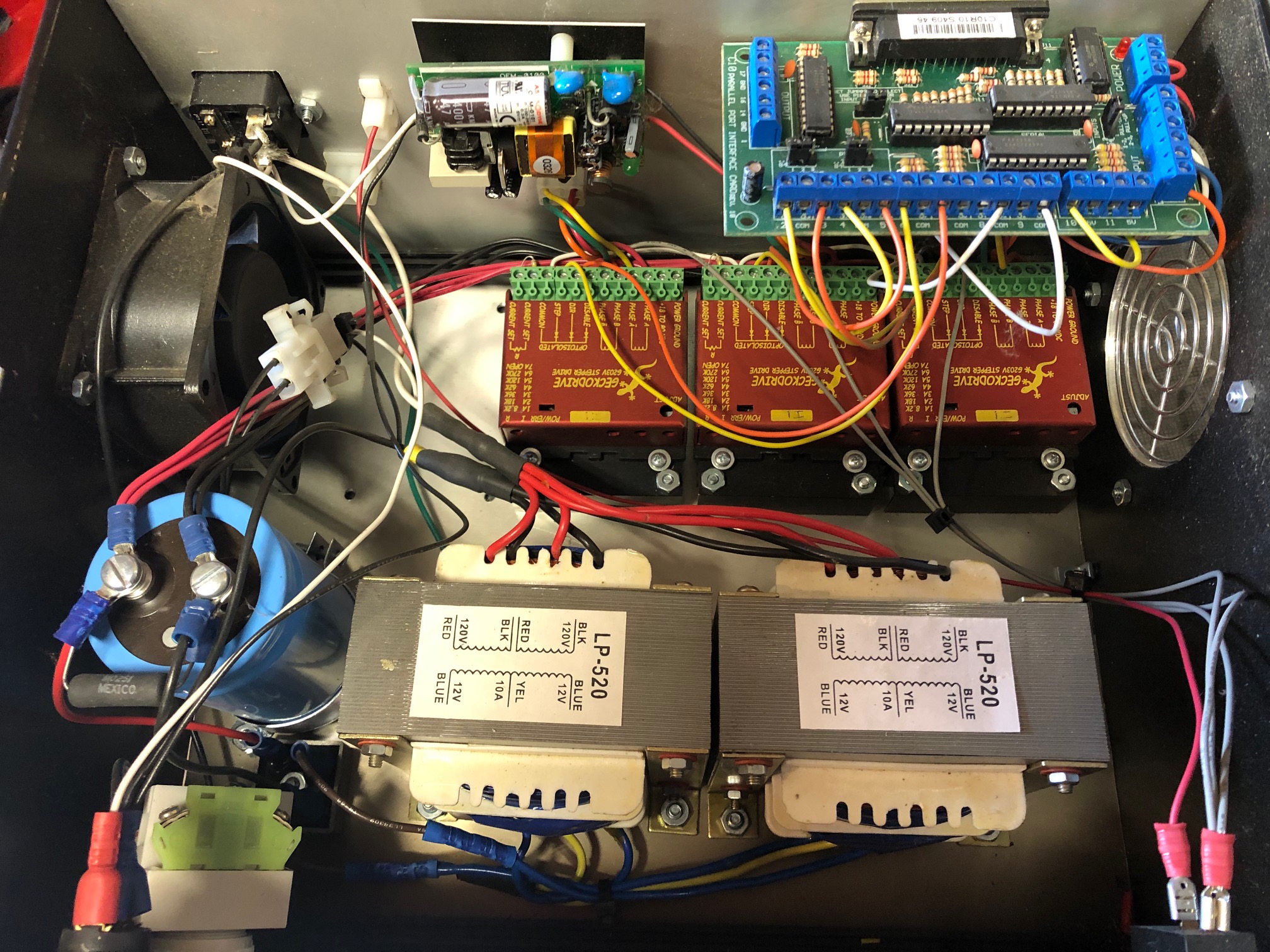

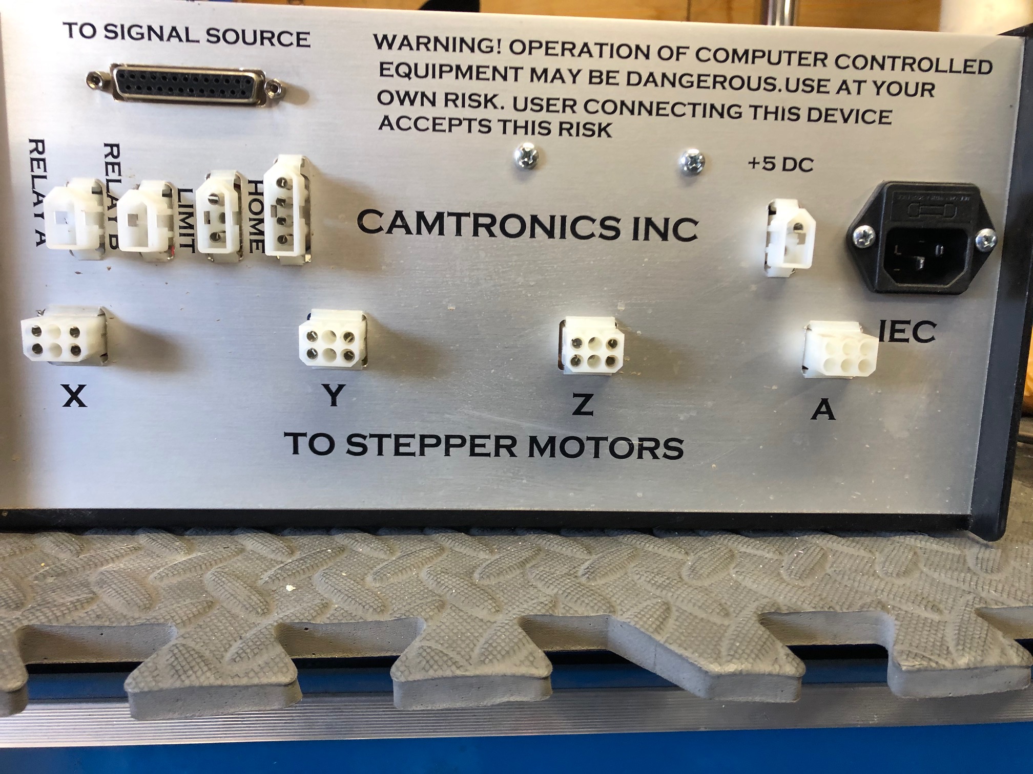

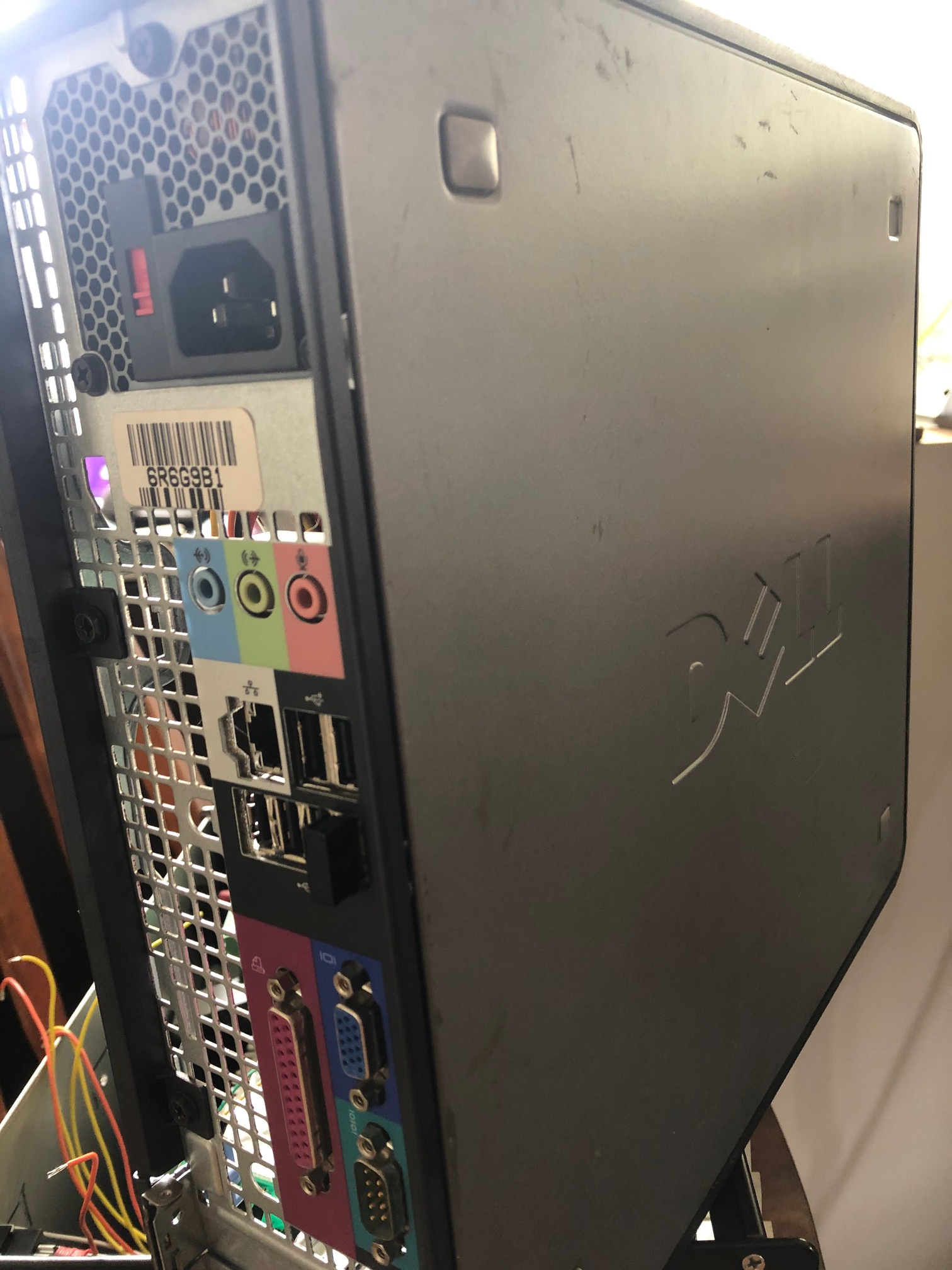

I have a Shopmaster Patriot 2011 that came with a Dell computer loaded with Mach3 and Wondoz. That sent signals to a Camtronics built unit via a C10 Parallel port interface to Geckodrive 6203V Stepper drive. The Dell PS died, the HD about died a few years back. I grabbed a new PS, used clonezilla replacing the HD with an SSD.
Because of CORVID-19 I have a huge amount of home time to do what I wanted way back then. Get rid of Wondoz.
My goal.
I received the 7i76e card yesterday and so it begins.
I'm not savvy with non RedHat Linux variants, LinuxCNC or electronics for that matter.
This thread could get interesting.
Hopefully I escape the white smoke.
Attached is what I will be working with.

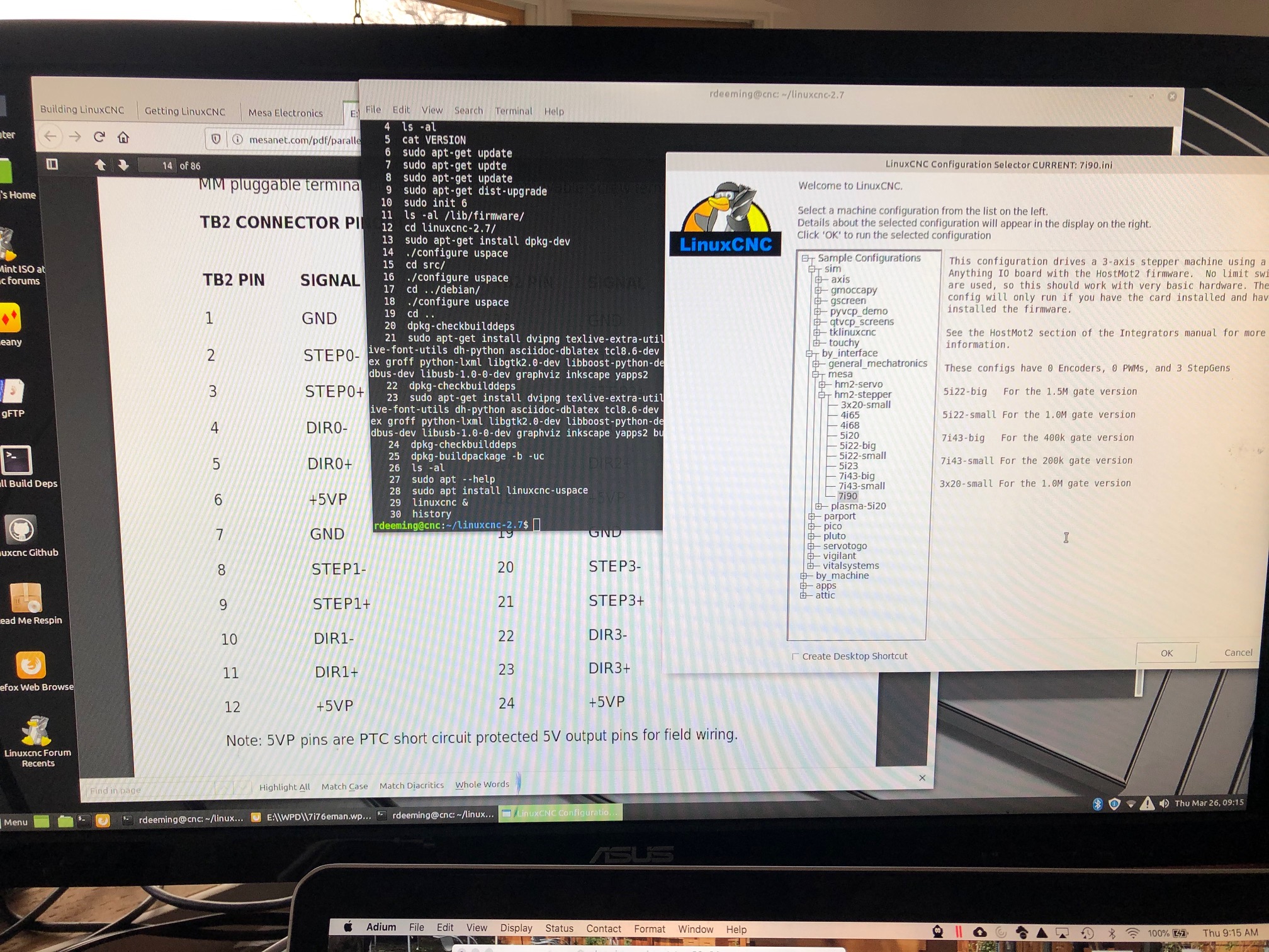

I downloaded the Mint variant on this forum and started guessing at the best process to install a conservative release of LinuxCNC on this thing.
The process (seems like there are 50 ways to get said point) this is my first stab at it:
- Download a spin of Mint from one of the LinuxCNC threads
- Threw the ISO on a flash drive from the Mac
sudo dd if=./linuxmint-19.2.0-20200306-LCNC-2.8-RT-UEFI-mate-64bit.iso of=/dev/disk2 - I got a little stuck here not knowing what is the best strategy.
- git clone -b 2.7 github.com/LinuxCNC/linuxcnc.git linuxcnc-2.7
- cd linuxcnc-2.7/debian
- ./configure uspace
- cd ..; dpkg-checkbuildeps
- sudo apt-get install ... packages ... # At this point I am wondering if I derailed because I am using a custom ISO for linuxcnc installing packages
- dpkg-buildpackage -b -uc
- sudo app install linuxcnc-uspace
- linuxcnc &

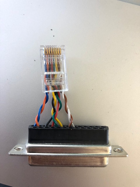

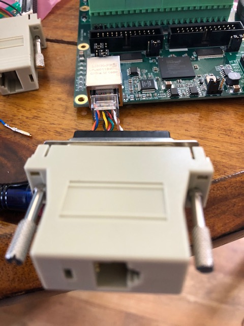

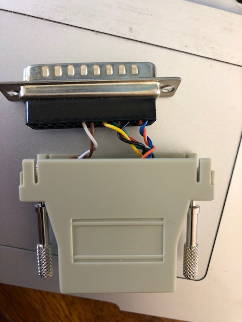

On to the Camtronics and the C10 to 7i76e.
I made mount/(Corvid-19 Home Lock Down hack) made from materials in the garage and past projects back in the 80's...
Attached is a CAT-5 to parallel Male to a parallel Female to CAT-5 plugging into the 7i76e board.
I tested the config on the home network and it seems to work just fine.
Last edit: 26 Mar 2020 18:03 by rdeeming. Reason: Different pic

I wonder what made you think you need to do that ? There is no need for anything under that line, just boot and use as live, or install to hard drive and start Linuxcnc.

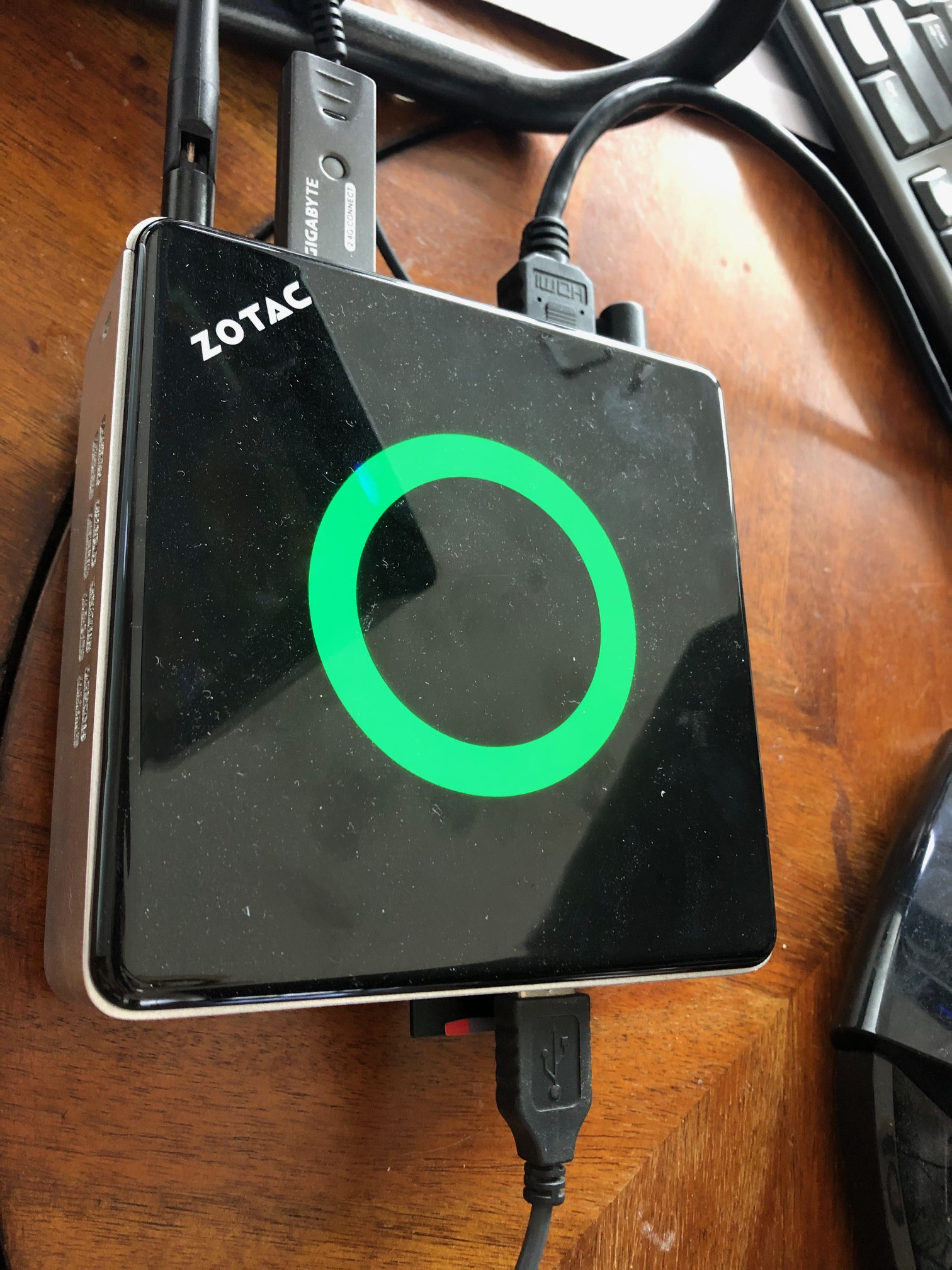

I am installing from a USB thumb drive to a 64g SanDisk card. Going with no HD in the Zotac.

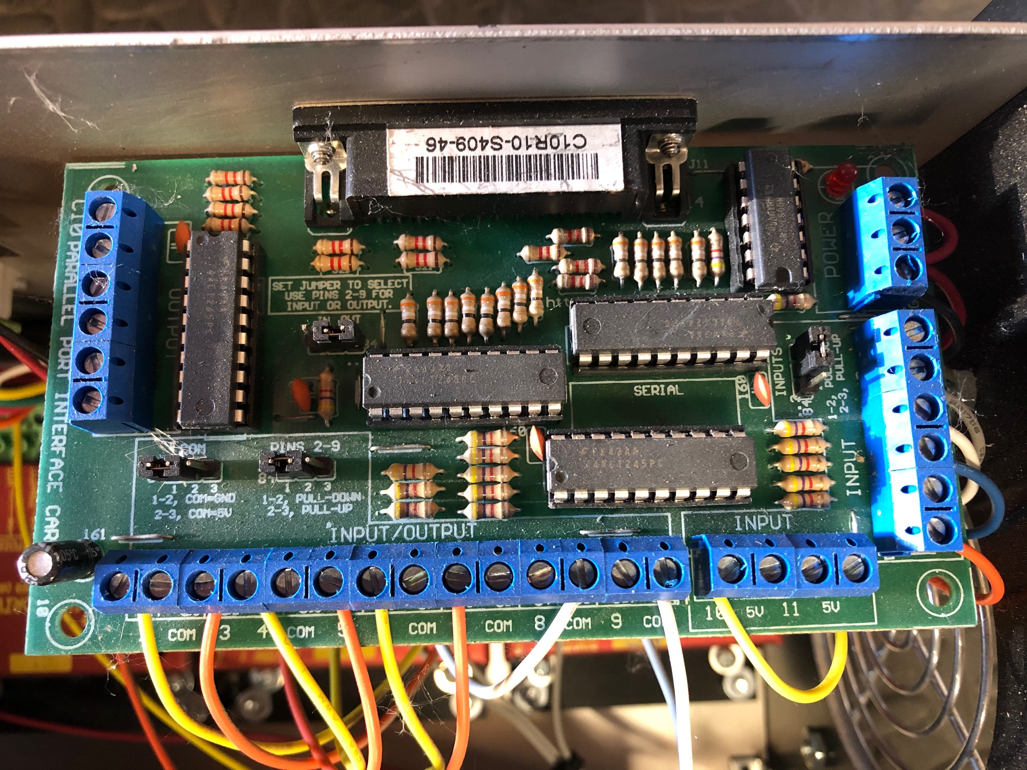

26 Mar 2020 18:29 #161596
by rdeeming
Replied by rdeeming on topic Mach3 -> Camtronics -> Parallel P Replacement
I tested/verified the 5v source that was going to the C10 and sent that to the 7i76e P3 plug.
I am now onto where I run out of talent and onto remove/replace.
C10 has the following set on the jumpers.
The 7i76e has something extra from the C10 that I am not getting.
Pin 1 GND # I am Ok with that
Pin 2 STEP0-
Pin 3 STEP0+
# I am stuck...
Pin 4 DIR0-
Pin 5 DIR0+
# I am stuck....
Step and Dir the - + option.
I am going with +, it sounds so much better than - today.
I wont throw the power till I understand this better.
Any advice is totally welcome.
- COM 1-2 GND # I'm Ok here
- Pins 2-9 Pull down # I honestly do not know at this time what pull down/up means.
Pin 2 STEP0-
Pin 3 STEP0+
# I am stuck...
Pin 4 DIR0-
Pin 5 DIR0+
# I am stuck....
