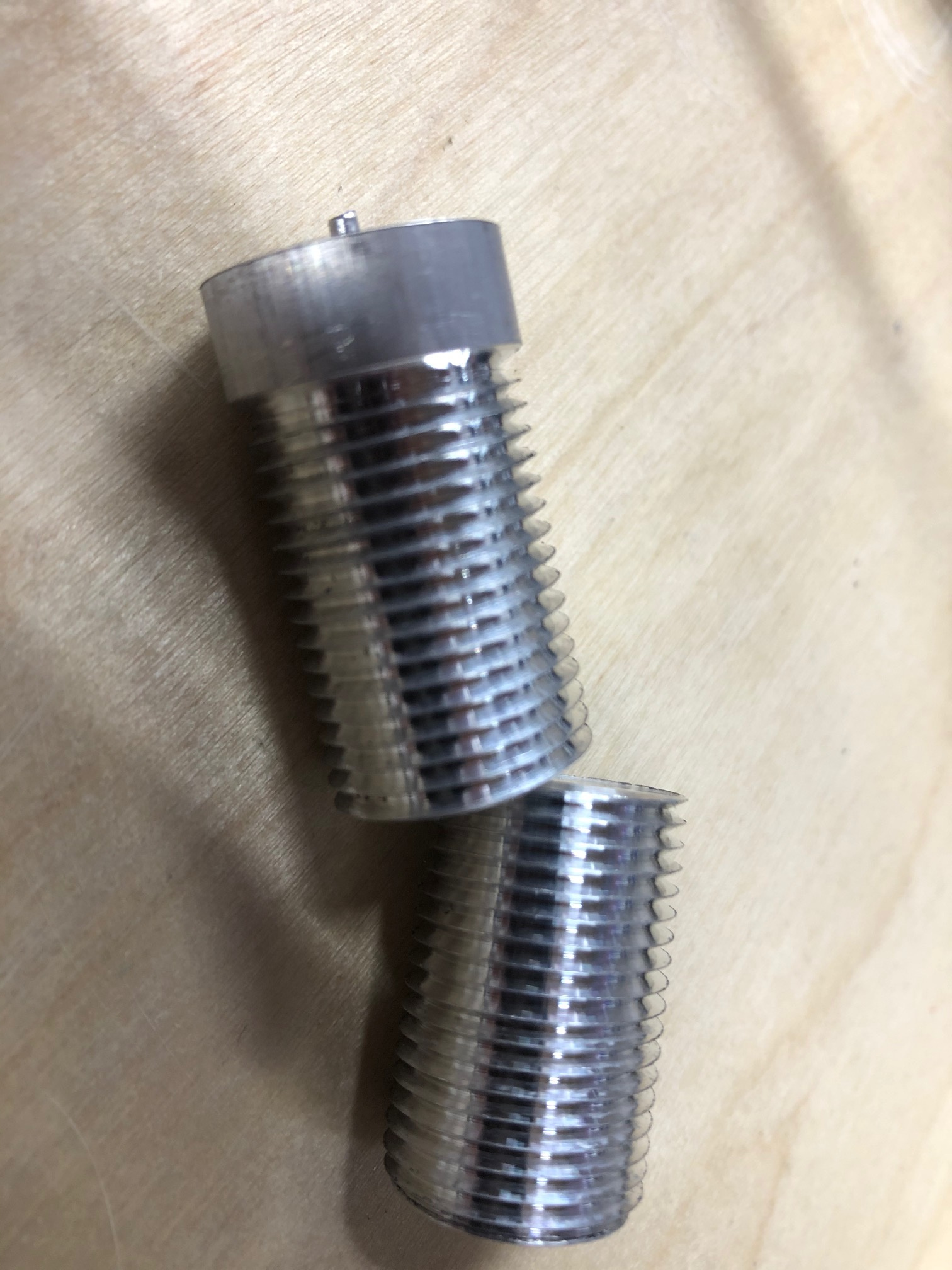

There are some things I am trying to cover up the weak links in the lathe machine like using the R, Q and H of the G76 cycle.
I have read the docs on R a few times now and really don't get it. I was hoping it was a way to basically decrease the cut depth the further into the thread depth of the cycle. It does not seem to do me any favors.
H was weird because the doc sais "additional" passes IE H1 should be two final passes in my mind. I need to verify what I am saying a bit more but what I thought I saw was there was no difference till like H2.
Q that was interesting. I tried a pass with it as far down a like 15 just to see what it looked like. It was not good...
Anyways some pics of the end of that little project are attached.
If there are suggestions like maybe make two calls to G76 to simulate an aggressive cut at the beginning and then taper off on the next G76 or other ideas to facilitate a machine that cant take a whole lot I would appreciate that.

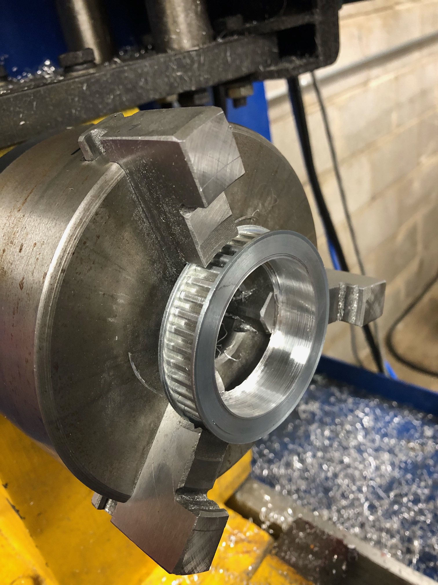

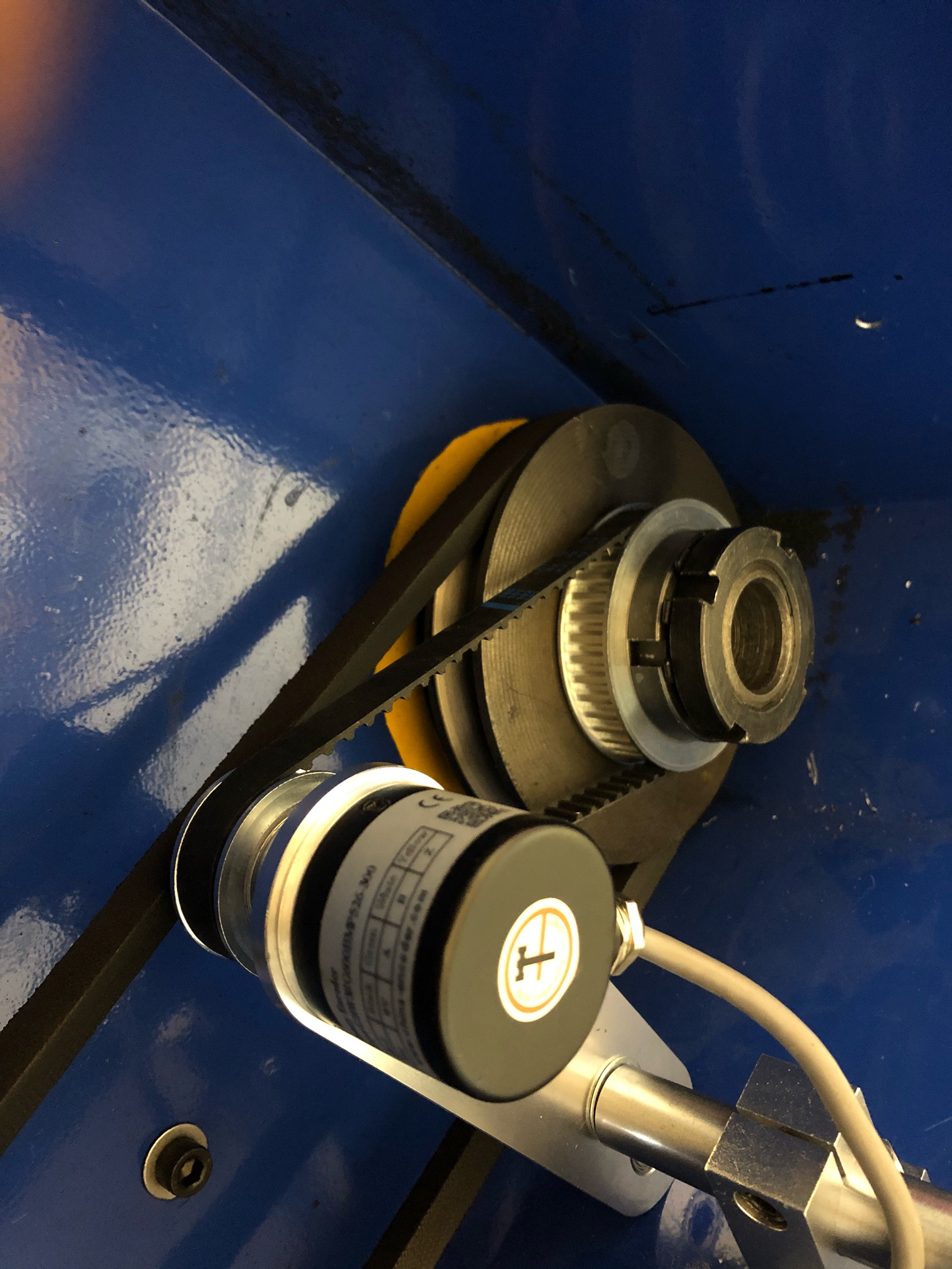

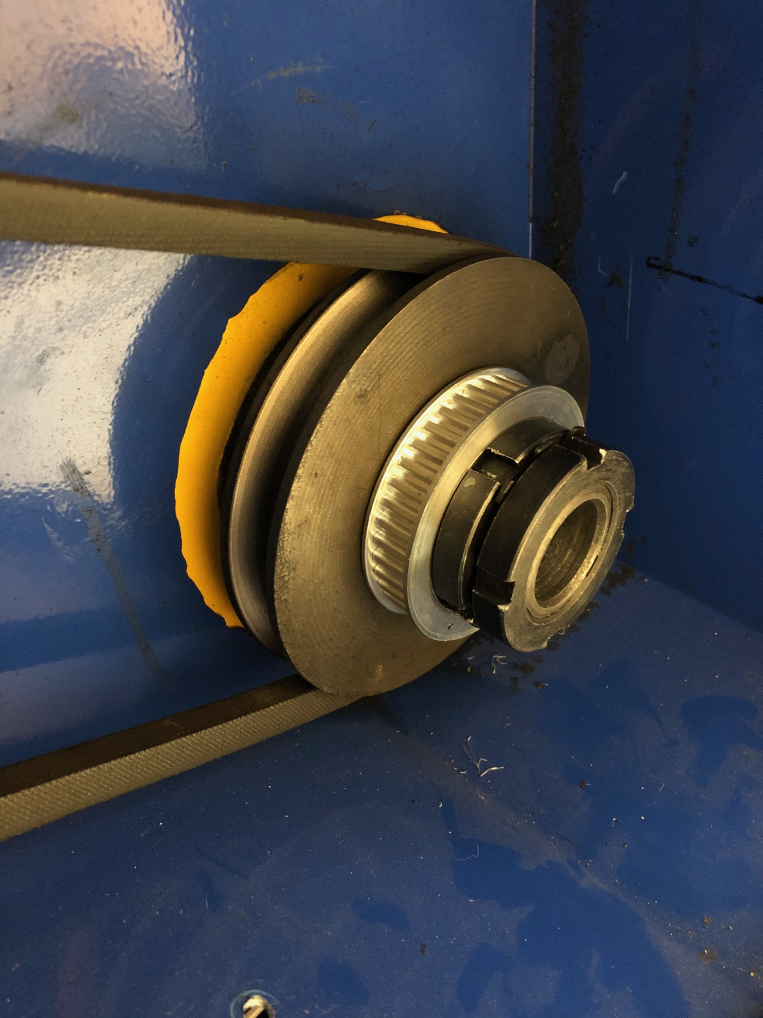

Is the spindle to encoder gearing 1:1? It doesn't look to be.
- rdeeming
- Posts: 48
- Thank you received: 3
05 Apr 2021 03:03 #204853
by rdeeming
Replied by rdeeming on topic Mach3 -> Camtronics -> Parallel P Replacement
It is not. 20T to 40T
- Thank you received: 4654
05 Apr 2021 12:31 #204889
Replied by andypugh on topic Mach3 -> Camtronics -> Parallel P Replacement
Do you have a separate index? If you use the index on the encoder then there are two possible places that an index might be seen for every spindle rev.

Note that it is possible to source an index elsewhere, for example a proximity sensor looking at a keyway on the spindle shaft, or an optical slot sensor looking at a hole in the toothed belt pulley flange.
