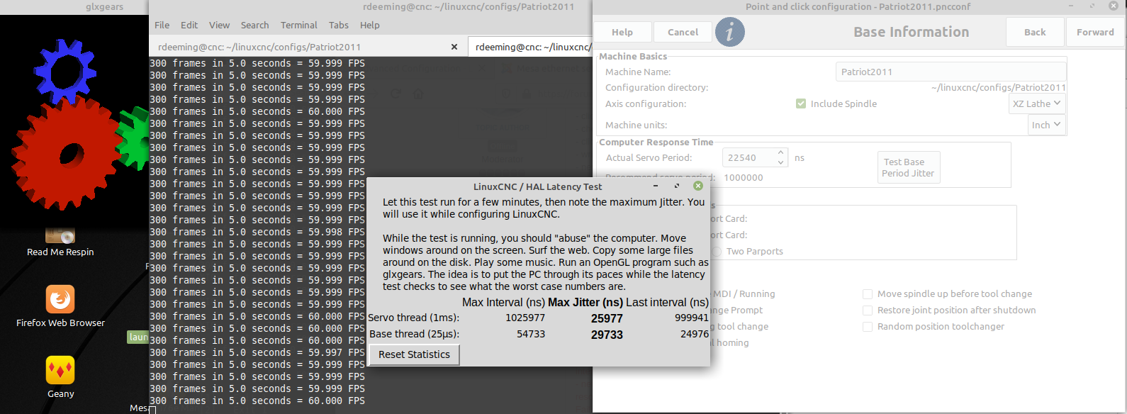

Currently when sending G01 X.5 F1 the X servo sits there and jitters.
Today...
I "think" my best strategy is to take the generated pncconf file and mash it to the converted working mach3 config file using stepconf.
Attached are results of the hal latency test.
What number should I enter for "Actual Server Period".
Reading the LinuxCNC 2.8 HTML Stepper Configuration Wizard 4. Latency Test.
Figure 3. and what is stated below 9075 does not make sense to me.
pncconf help mentions to "choose the servo period"
The LinuxCNC / HAL Latency Test has a row "Servo thread (1ms): and the column Max Jitter in (ns)
Am I supposed to come up with a different number than 25977 for the "Actual Servo Period"?
When starting LinuxCNC it fails with that number. Setting it to the recommended 1000000 it starts with no errors.
Today...

in 99.9% of cases, there is no reason to use anything but the default
1 ms servo thread period

Yeah that's a early pncconf bug perhaps compounded by setting the servo thread
too fast in the initial configuration. To fix, in the hal file replace all statements like
setp pid.x.maxerror .0005
to
setp pid.x.maxerror 0
and in the ini file, set all PID P terms to 1000
to
